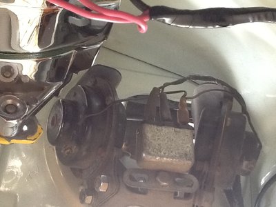

Just found the wiring diagram and the Mikado does run a relay. Check power at the relay and check for a signal at the relay. I would start with jumping power and ground at the horn and work back from there.
Here is a picture of a Mikado set up. The relay is in the middle. The center terminal has battery voltage all the time. The terminal on the drivers side give the horns power when the terminal on the passenger side gets a ground from the horn button. Check power first then ground the passenger side terminal, if the horns are good and the relay is good it should work.
