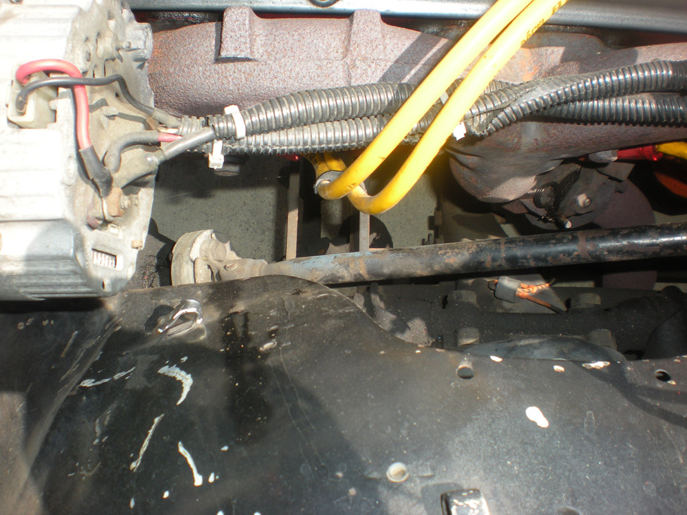

PostPosted: Mon Sep 03, 2012 2:31 pm
I believe I have Hooker mounts.
Driver side
Passenger side
