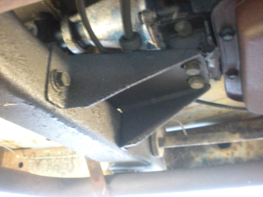

PostPosted: Mon Sep 03, 2012 9:31 am
Here is a pic of mine with the short 350

Hang in there . It will fit with a th350 . Measure twice cut once . You can always remove more metal . it is alot harder to put it back after its cut out . Here is my factory mount modified for a th350 .
Just for grins homemaade motor mount also , these use 67-69 Camaro rubber pads and worked with Hooker block huggers and Hooker conversion headers
