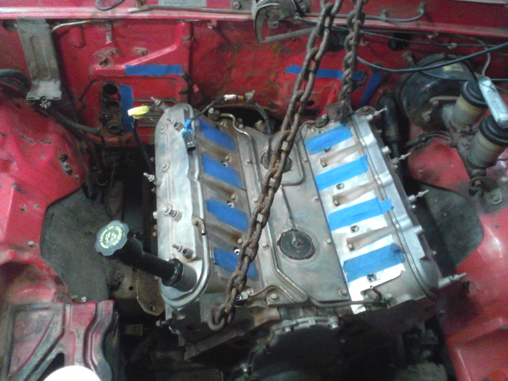

Mock up
File comment: Mock up

Fit grate ... Batery tray mite no clear header

Sweet ok so i got a 5.3 4l60e so we can help one another im changing to ls1 waterpump and crank pully there closer in so i have radiator clearance . I went with ls1 intake 4 hood clearance. And it looks cool :) i ordered from o'rielly a ls1 to 350 kit... And i have my old luv 350 kit so im hoping 4 bolt in
