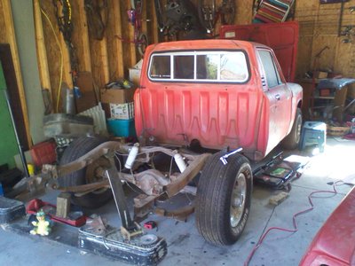

ceaning
File comment: Cleaning

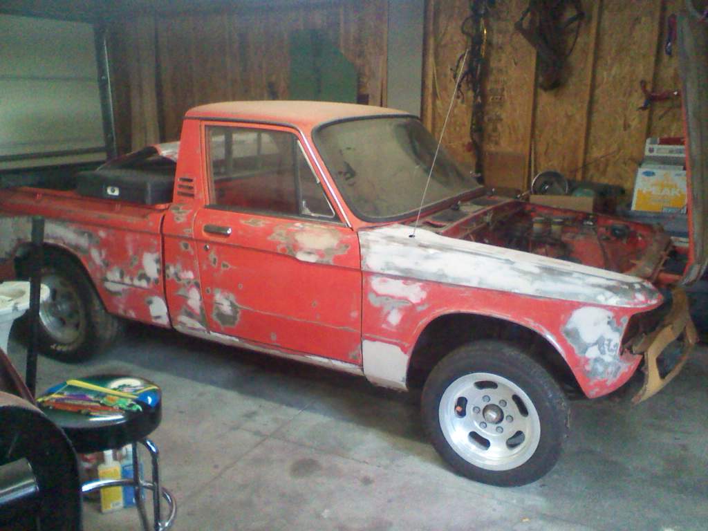

My baby

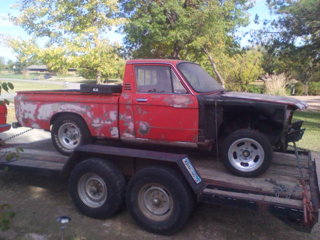

77 luv

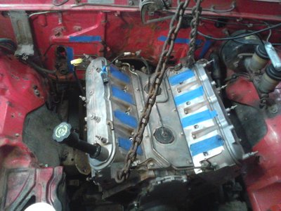

Mock up
File comment: Mock up

Fit grate ... Batery tray mite no clear header
