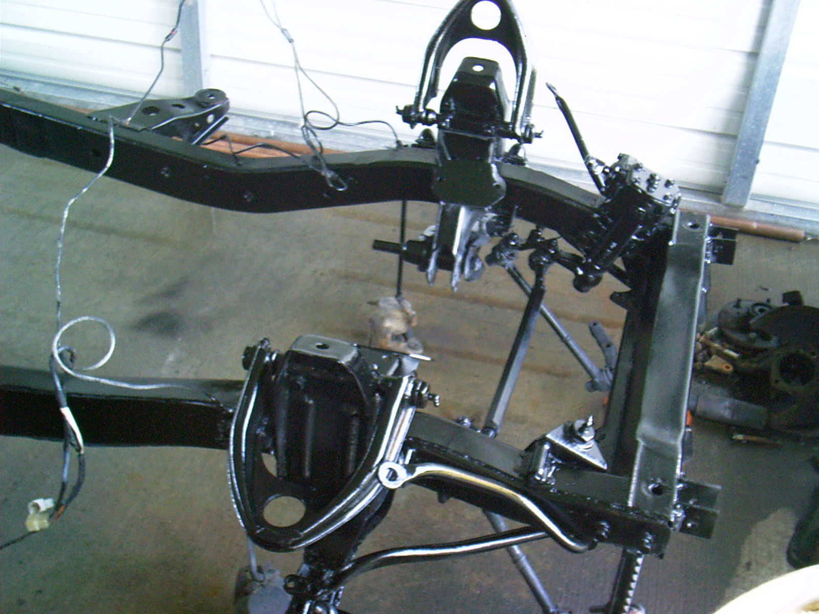

PostPosted: Sun May 18, 2008 7:52 pm
Posts: 259
Location: Murfreesboro, TN
well i took all brake hardware off and spindles etc. I am going the cheap route with s10 conversion just got the ball joints for now. I half way did the frame and painted it with one coat for now. hopefully coilovers and front end parts in a couple of weeks so i can sit the motor and tranny in to make my crossmember.

PostPosted: Sun May 18, 2008 8:09 pm
Posts: 259
this is what it looked like easter!lol
