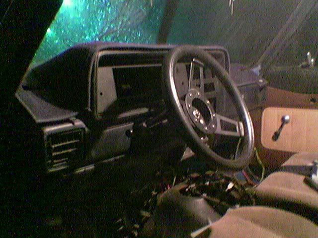

today i was bored so i cut out my old dash and decided to put a dash out of a gti in. i picked up the rabbit yesterday to scrap and get some parts for mine.

didn't see any GTi stuff.. but how far off drivetrain wise was the s-10 setup you dropped your body on? it looks like a lot, but i thought it was close to the right lenght and width

yeah i just got the picture on after you looked at it. anyways the width was right on but the front of the bed was like 4 inches to long but i fixed that and i did it on a s-10 blazer frame not the s-10 pick up

Make's me wish I was back in "CornValley" so I could come over and check it out! What are you using for a steering colom? I would love (LUV?) to do away with the stock one, and get one that was 3"or 4" shorter.

its a tilt coulmn out of a 92' s10 blazer

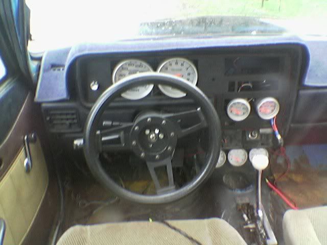

got my gauges in and my wiring tucked away i even have a lighted glove box and entry lights!
as for the swap are you talking about the column or the dash?

Well, I started askin' about the collum, but after taking another look at the dash, I want to know about both :!:
Damn that looks good! 8)

thanx! well for starters the column wasn't really a swap cause im on a s10 frame so it was a bolt on except for the bracket to mount the column to the dash. as for the dash i cut out the steal dash. then i cut out the dash mounts out of the rabbit and made some 1" spacer out of sheet metal and welded them to my kick panels then welded the dash mounts to that i had to trim off the defrost hole to get the dash to fit right. i might cover the whole thing i fiberglass im still debating it
