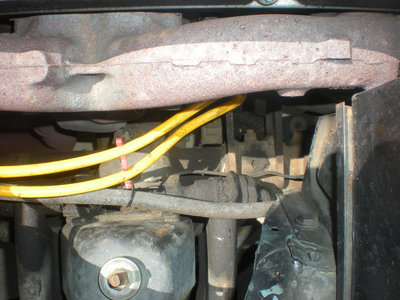

PostPosted: Mon Sep 03, 2012 9:31 am
Here is a pic of mine with the short 350

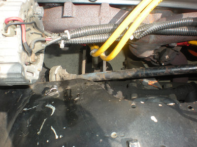

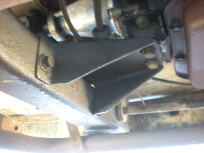

PostPosted: Mon Sep 03, 2012 2:31 pm
I believe I have Hooker mounts.
Driver side
Passenger side
PostPosted: Wed Sep 05, 2012 10:37 pm
Posts: 357
Location: Minden, Nevada
Yes you have Hooker and the TH350 trans cushion bolts should be approx 6" forward of the crossmember.
PostPosted: Thu Sep 06, 2012 3:26 am
Hang in there . It will fit with a th350 . Measure twice cut once . You can always remove more metal . it is alot harder to put it back after its cut out . Here is my factory mount modified for a th350 .
Just for grins homemaade motor mount also , these use 67-69 Camaro rubber pads and worked with Hooker block huggers and Hooker conversion headers
