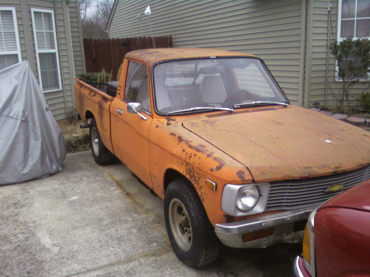

just got my motor and working on the swap. going to use ls1 swap mounts from s10v8.com and hopefully trans am factory ls1 manifolds trucks wont fit. th350 trans 3500 stall. also going for carbed set up instead of efi! Still deciding on rear end.
I think this will be the first luv ls series engine swap???? factory specs on my motor are 345 hp and 380 tq factory. carb intake free exhaust should jump it to 400 hp easily lol in my 2500 pd truck WOW :lol: :lol: :lol:

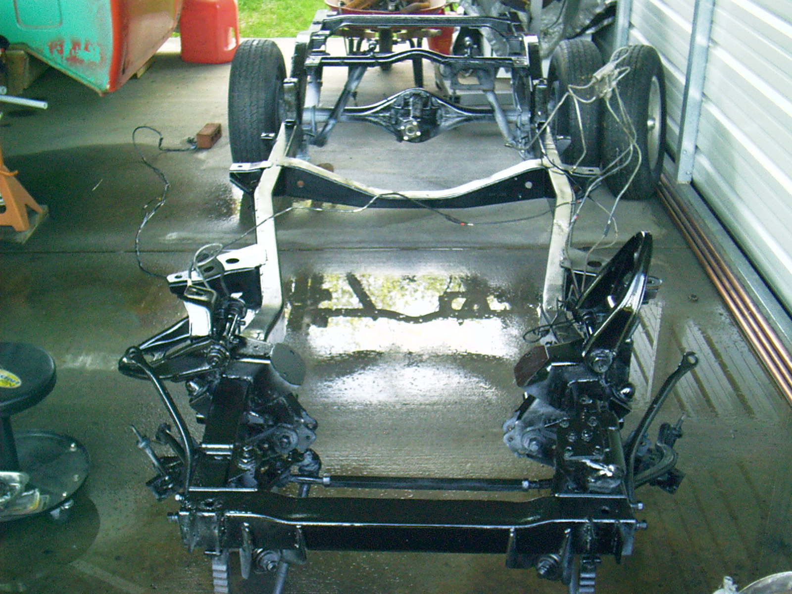

PostPosted: Fri May 02, 2008 11:50 am
Posts: 259
Location: Murfreesboro, TN
more pics
6.0l ls1 swap th350

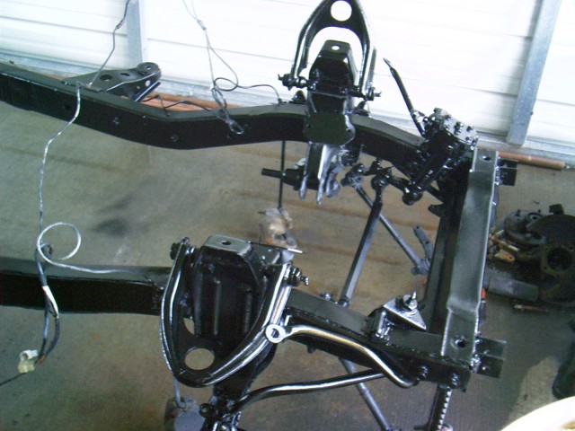

PostPosted: Sun May 18, 2008 7:52 pm
Posts: 259

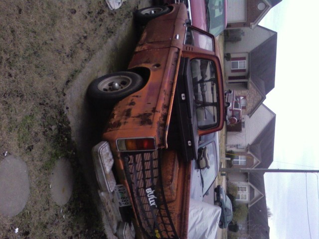

well i took all brake hardware off and spindles etc. I am going the cheap route with s10 conversion just got the ball joints for now. I half way did the frame and painted it with one coat for now. hopefully coilovers and front end parts in a couple of weeks so i can sit the motor and tranny in to make my crossmember.
6.0l ls1 swap th350

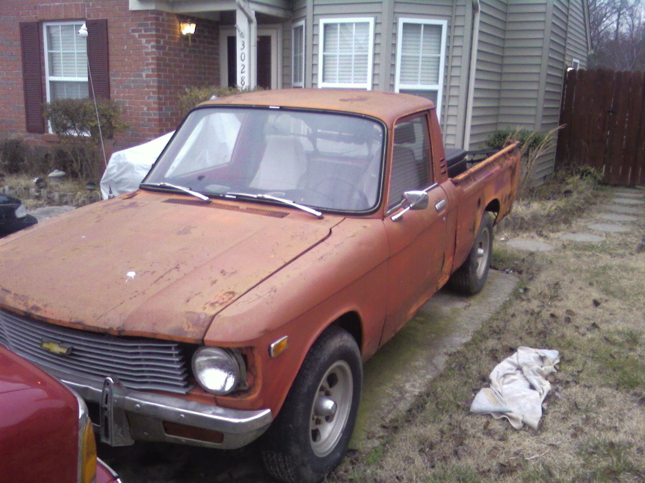

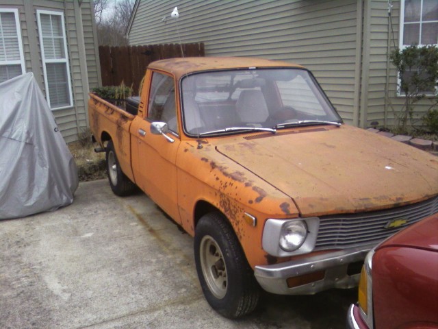

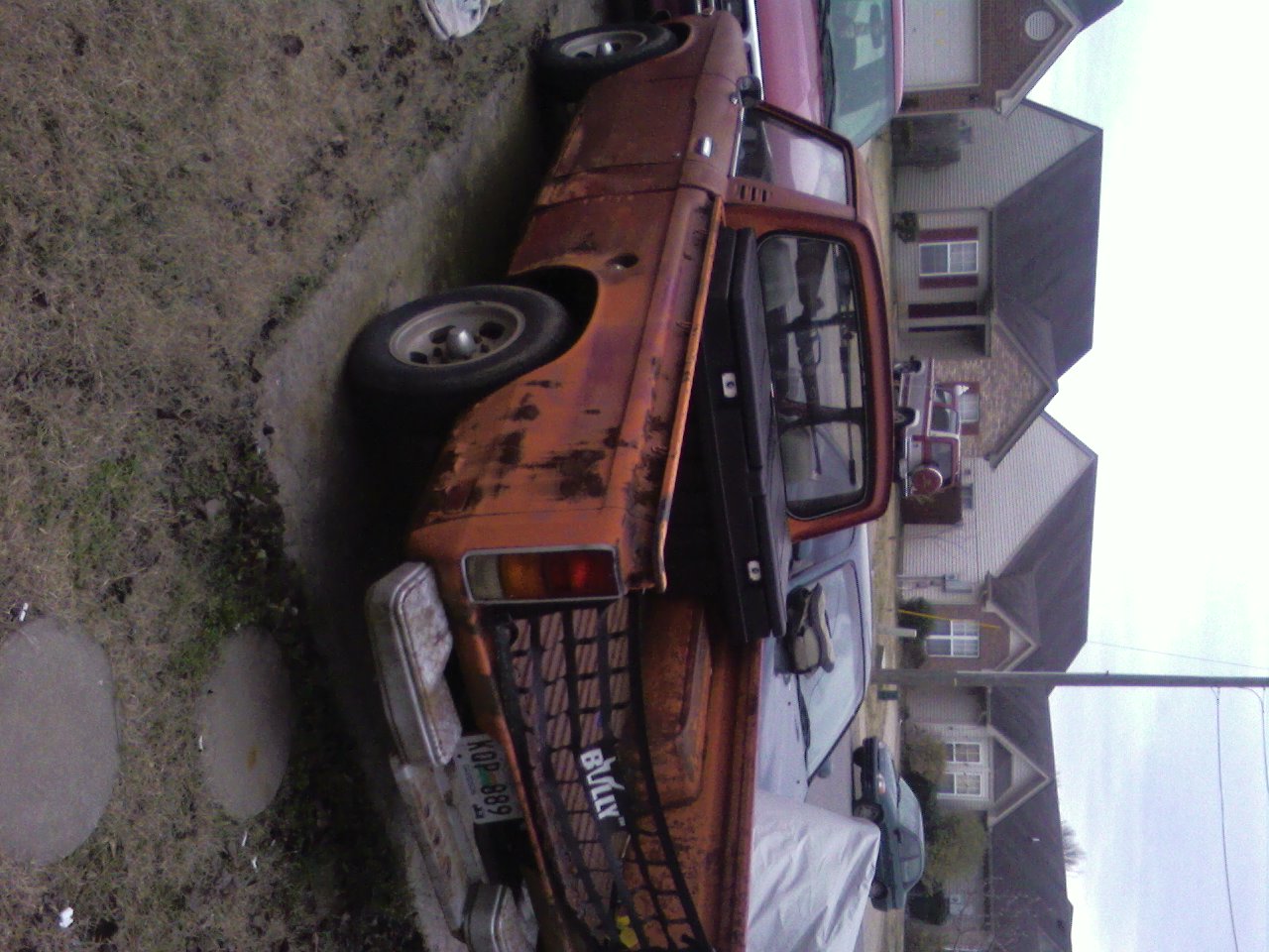

PostPosted: Sun May 18, 2008 8:09 pm
Posts: 259
this is what it looked like easter!lol
6.0l ls1 swap th350
