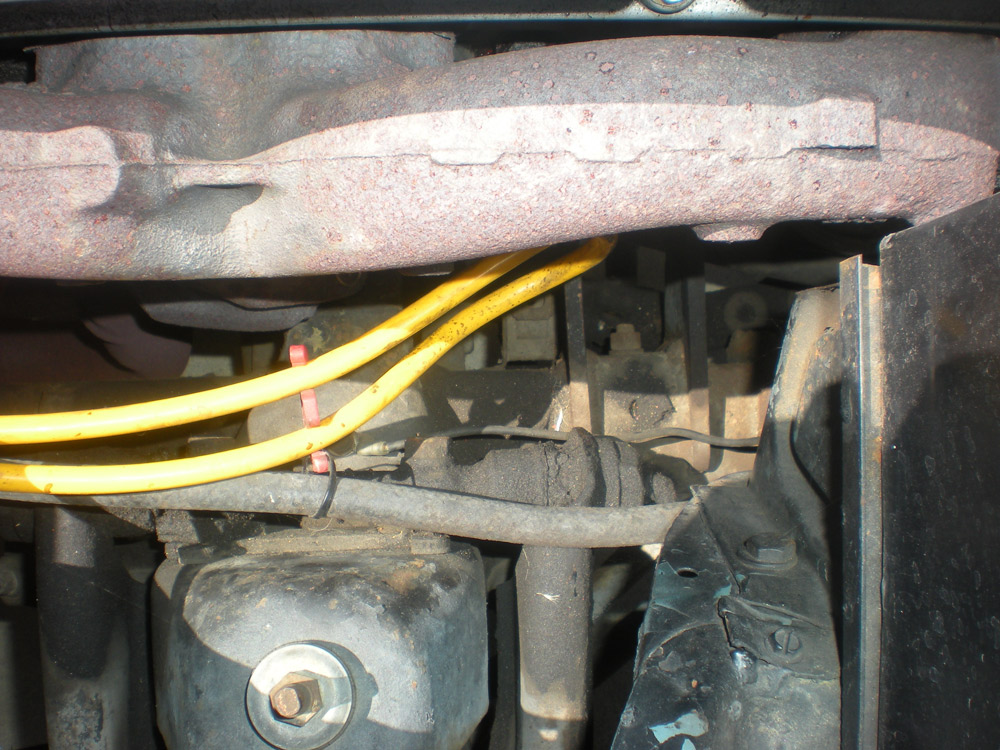

PostPosted: Mon Sep 03, 2012 2:31 pm
I believe I have Hooker mounts.
Driver side
Passenger side
PostPosted: Wed Sep 05, 2012 10:37 pm
Posts: 357
Location: Minden, Nevada
Yes you have Hooker and the TH350 trans cushion bolts should be approx 6" forward of the crossmember.
