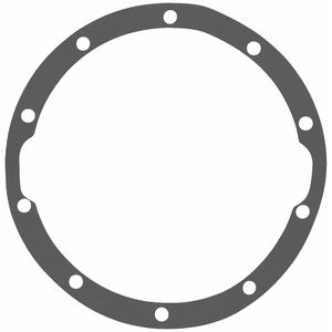

or if you mean the big round one with i think 10 bolt holes like this? Axle Housing Gasket Part Number: RDS55084

not the large main seal for the housing, just where the yoke meets the actuall differential.
