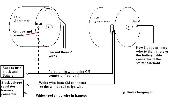

Some one had this.
Looking for that special LUV.
PostPosted: Thu Feb 01, 2007 1:40 am
Man , this is the one I was looking for . It completes my alternator wiring . My dash light will now work . Thanks guys

is that a diagram for a externally regulated GM alternator?

OK I got it put on last night, froze my ass off!
I putta 75 ohm resistor on the stock white/red wire that comes from the dash idiot light and used that as my exciter wire. (brown wire on the alternator).
I used the stock charging black BATT wire for my voltage sensor wire (big red wire on alternator) and BTW the stock wire w/o the resistor has about 6 ohms.
and then I ran new 8 gauge wire to the battery for my main chargin wire.
But of course I had to build a lower alternator bracket to hold the new GM alternator, the top one worked just fine.
