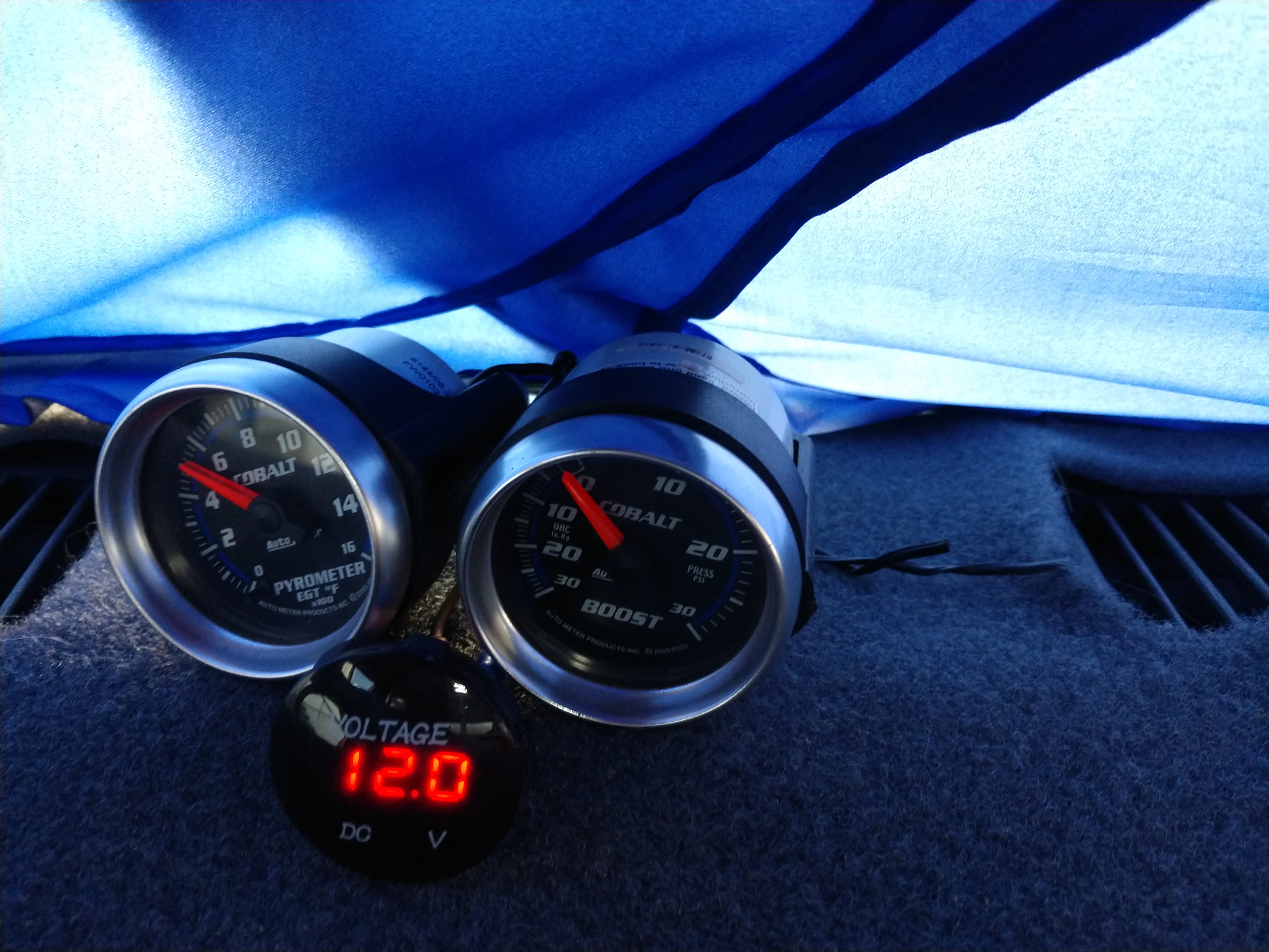

Yeah I have one on my truck. Welded the bone for the sensor just below the manifold joint.
Well I didn't have any issues with smog before I put it in so no it didn't help me. And the smog tech didn't pay any attention to it.

Yeah, I suppose. I was able to Target real close to stoich at idle. And verify that it wasn't too rich or lean @WOT.
It also helps me realize that I was having vacuum leaks and other issues, because I noticed the AFR would randomly change from what I normally was. (Carb was actually vibrating loose despite being lock-tited)
No my carburetor was actually almost new, a Weber 32/36.
donhaywood wrote:
Also....Nice Dash!! where did you get it?
It's a factory dash.
I threw in that little tack not long after I bought the truck just to know what kind of RPMs I'm running down the highway or down the trail.
I just had some gauges left over from previous vehicles (act, egt, and vacuum/boost) and then when I had the engine rebuilt I added actual water temp, oil temp, and oil pressure gauges.
