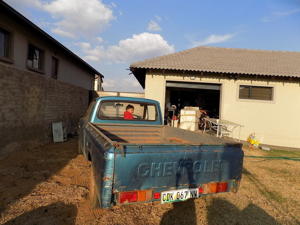

Bought a '75 luv off a farm here in sunny South Africa.
She was in a bit of a state when I received her, but not so bad as not to want to continue with the project.
There was some surface rust, the bed had a few rust rot spots, plenty of dents and a smurf covered interior.
The plan was to fix this truck and use it as a daily driver.

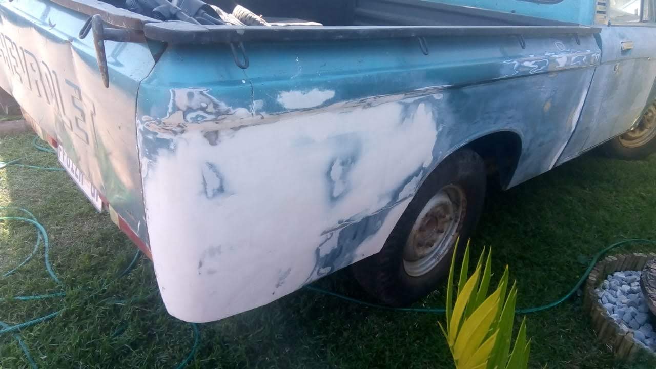

Fixing / filling dents!

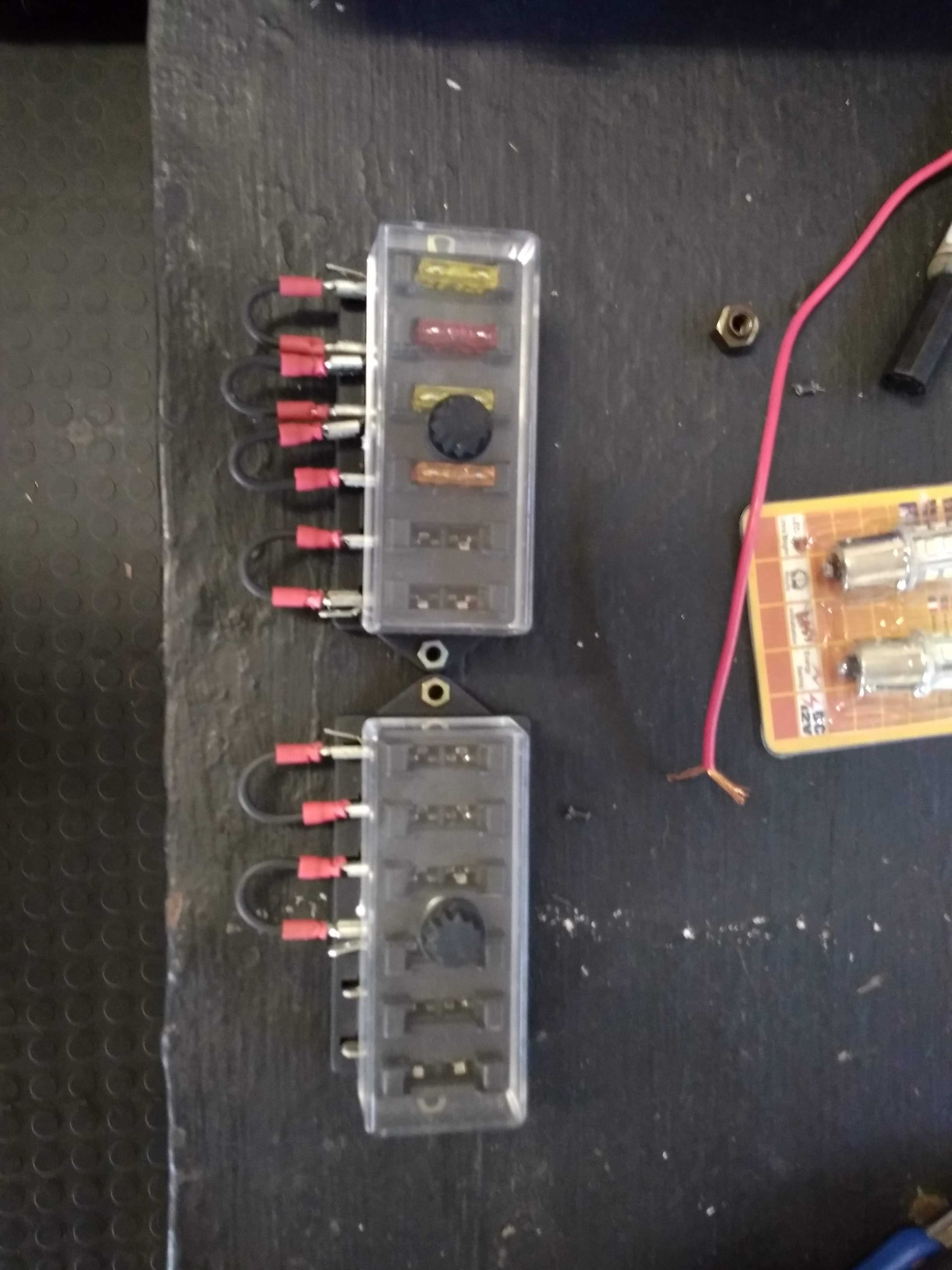

Previously did a fuse block lemon juice boil, that only held up for about six months. Time for a complete new fuse block.
Figuring out the 4 earths, 2 earths, and on the other block 2 earths and another 2 earths.

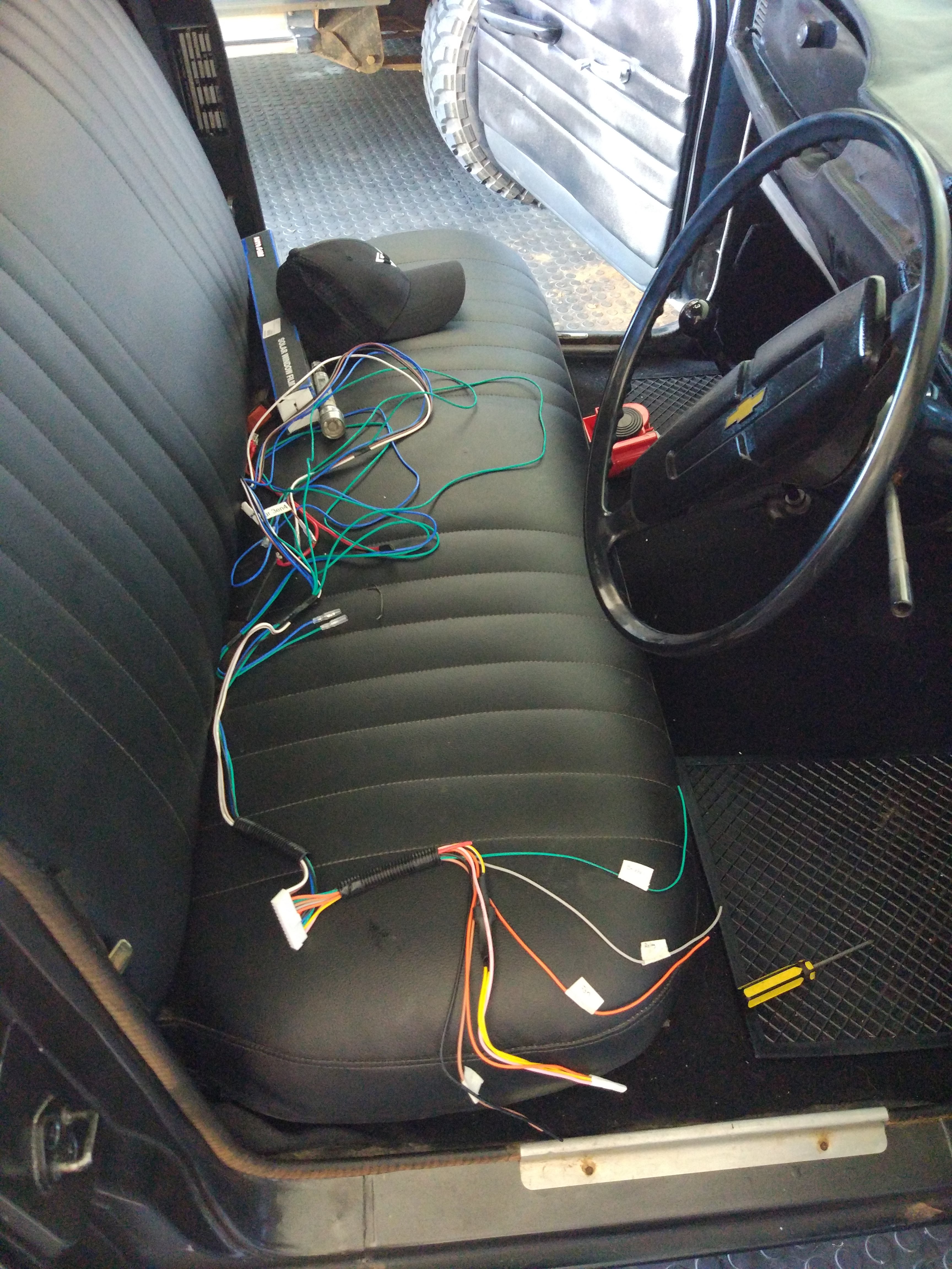

Its been ages since I posted the updates on the truck. Luckily google saves all of our photo's these days. Good or bad, the jury is still out.
So for the more modern niceties I installed an alarm and central locking system into the luv. Cost about $50, can you believe it?
Finding where everything goes was a bit daunting at first, but once you slowly layout every wire, it was actually quite easy.
File comment: Instruction manual saved my bacon!!!
File comment: Initial layout

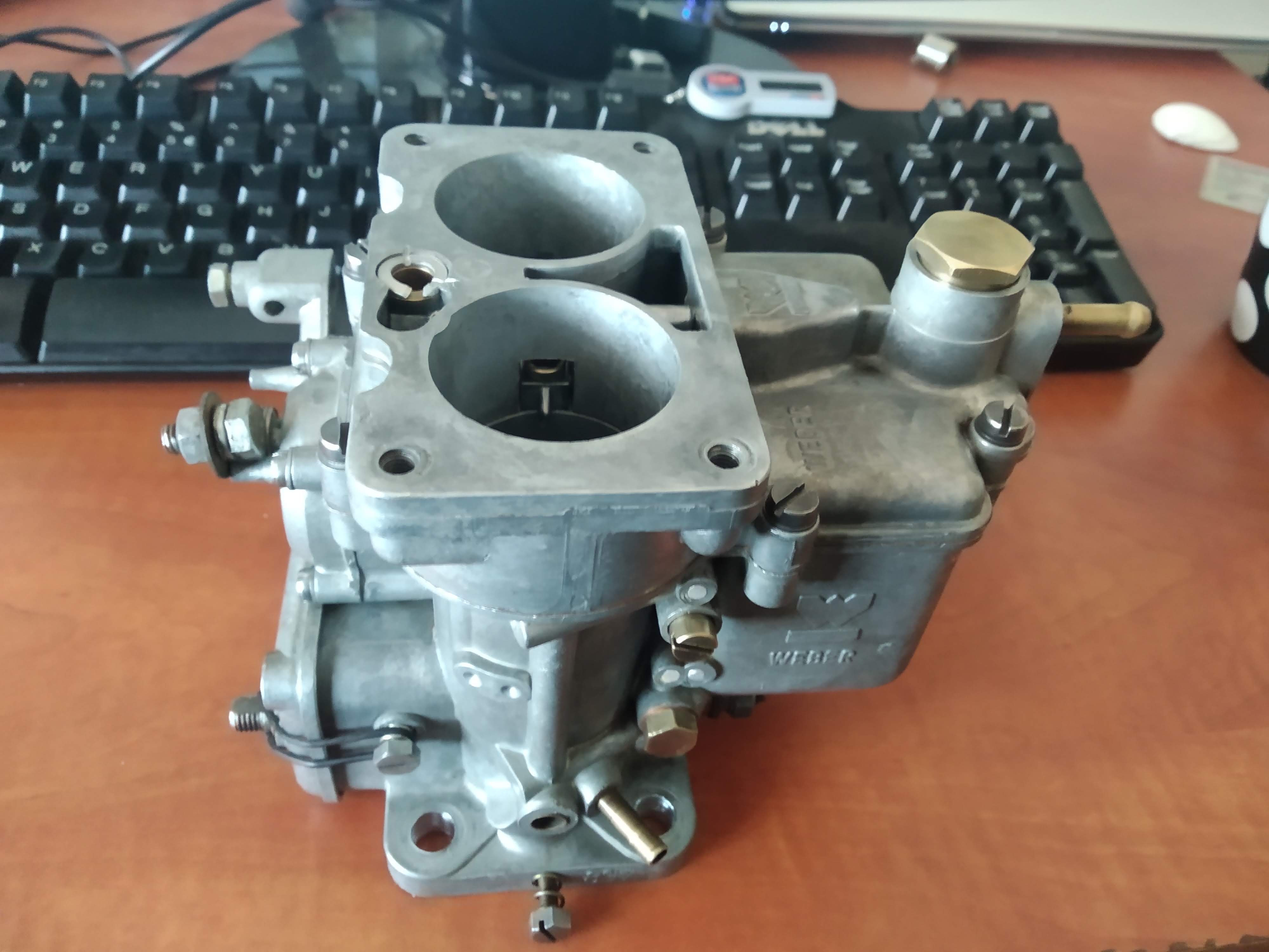

I started noticing that the truck would either idle high, or not idle at all. Which all pointed to an air leak. I double checked that the manifold(s) and carburetor was bolted down fine. Yes sir, all bolts are tight.
This truck has a modified Weber 36 DCD carburetor on it, with specially made adapter plates.
File comment: 36 DCD Weber baby!
My assumption was that this might have a leak somewhere. So I removed all of them, and cleaned the three plates properly and installed new gaskets with sealant. Rookie mistake, I did not use fuel compatible sealant and I'm still waiting for that to come bite me in the ass.

Fixing this supposed air leak did not solve the idling problem for me. After thoroughly cleaning the carb and making sure everything is perfect to the best of my knowledge, we figured out that the little button/nipple (don't know what its really called) that runs in conjunction with the choke bounces around depending on the vacuum created by the throttle openings. We looked at 36 DCD manuals on the internet and found that there is a little spring missing. Sampling a few ball point pen springs, we finally found one that makes it hover at the right elevation and the truck purrs like a kitten again.
File comment: Missing spring

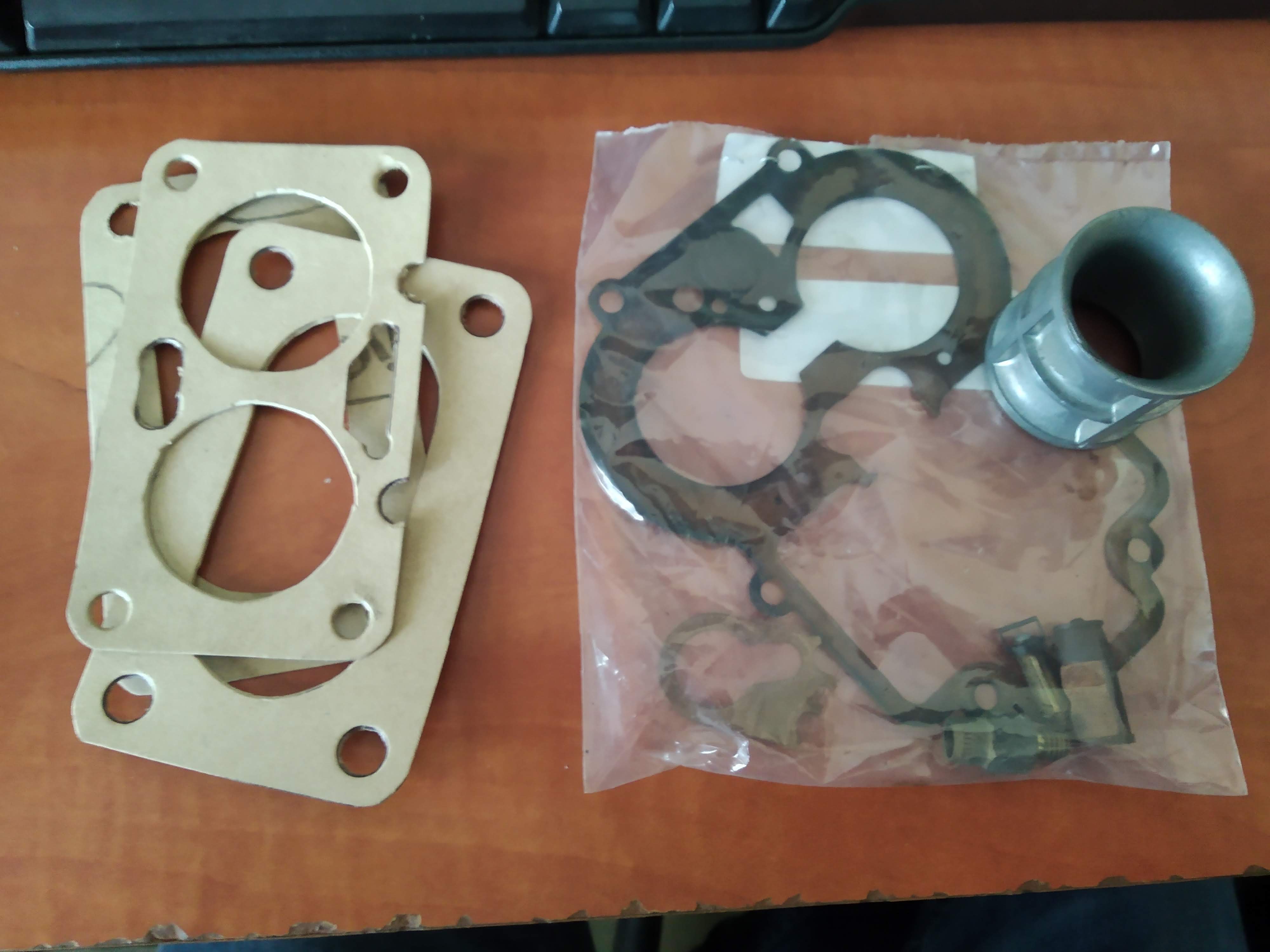

With the truck looking and running sweet I started driving it more often. But, every hundred odd miles the plugs foul and she sputters and chokes like an untrained porn star. Okay, maybe we had dud plugs. I replace all of them again, and low and behold. One hundred odd miles, plugs fouled again.
Okay, so I have given this 36 DCD carb a good go prior and I have to admit that I'm out of my depths here. Off to carburetor overhaul city we go. They charged me $95 for a complete rebuild. Look how pretty she is now!
File comment: Shiny, like the crab song!
File comment: still very very shiny
This is everything that was replaced.
File comment: out with the old, in with the new
