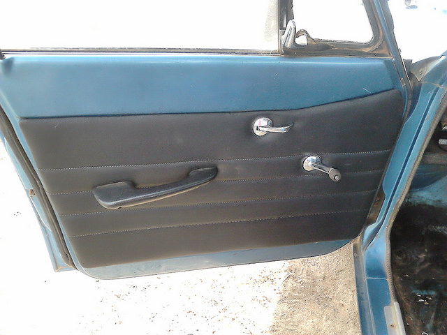

New window winders, trying to keep to the style of black and silver.
