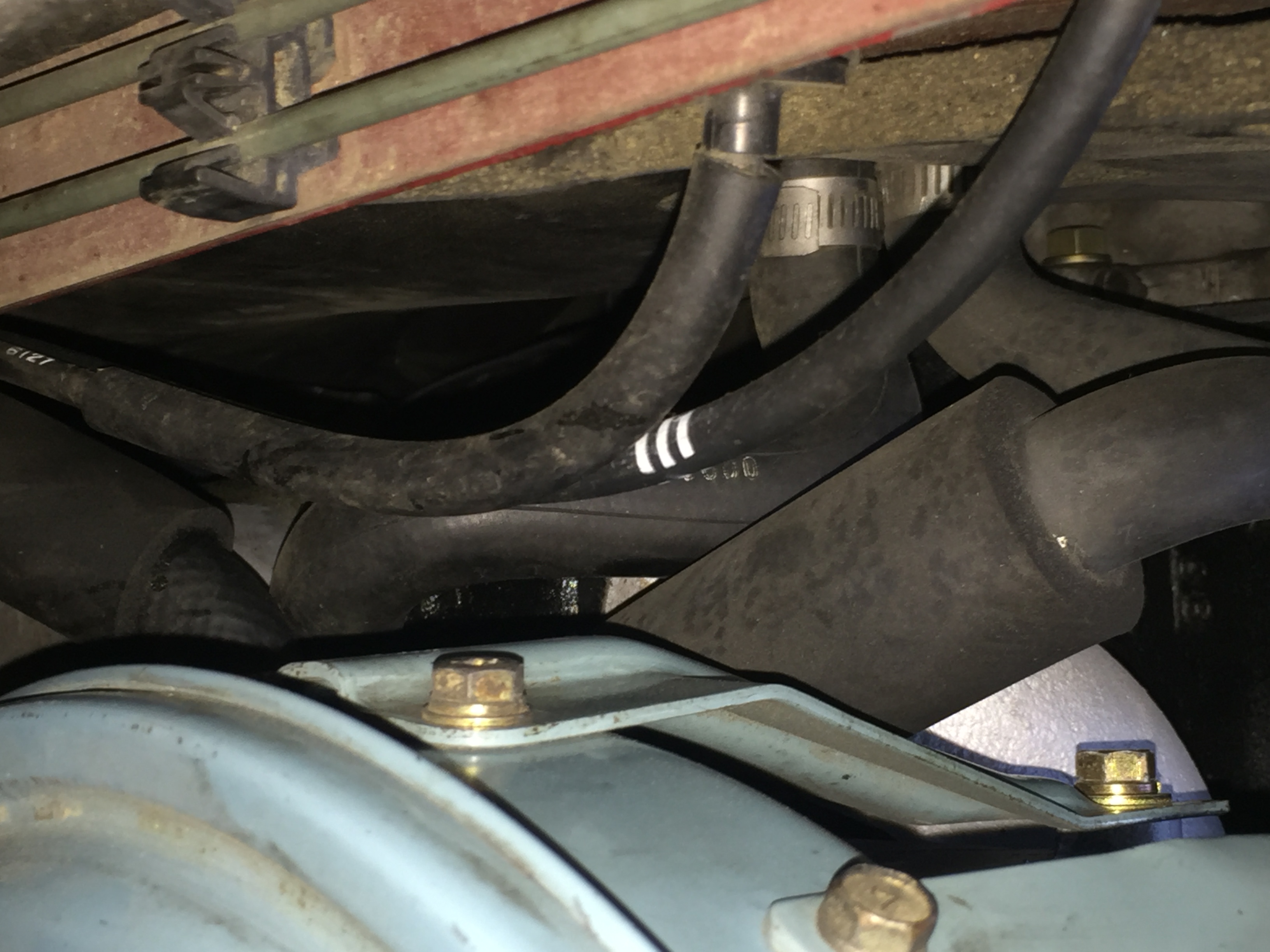

Finally got heater fixed can anyone tell me what heater core hose goes where

Driver's side goes to the control valve. And I do believe the passenger's side goes to the back of the head.

I'll see if I can get a good pic this afternoon. My '83 P'up is the same.

Here's the best pics I could get without removing the air cleaner. If you click on each image, it should appear right-side up.
