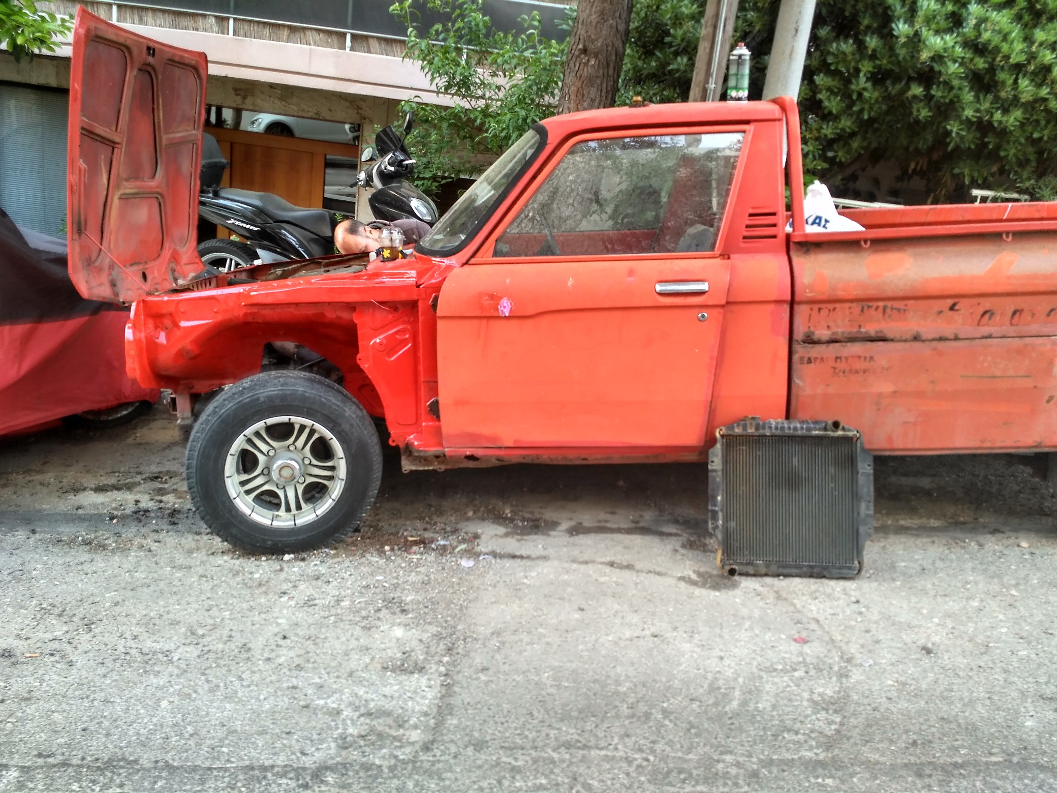

Hello guys from Greece.
I am trying to restore my dad's luv.It is an 1980 rwd greek import with a greek made bed.
It is in a pretty bad shape cause of the rust.
I am looking for a good bed and if not i will repair this one.
Also both driver's and passenger's floor are rusted.
Anybody knows of what other cars radiator fits to luv.
Also anywhere i can find rebuilt kit for the nikki carb?
Here are some pics of what i've done far.

PostPosted: Sat Apr 15, 2017 9:48 pm

PostPosted: Sat Apr 15, 2017 9:49 pm
Welcome. Looks like you've got a good start on it.
