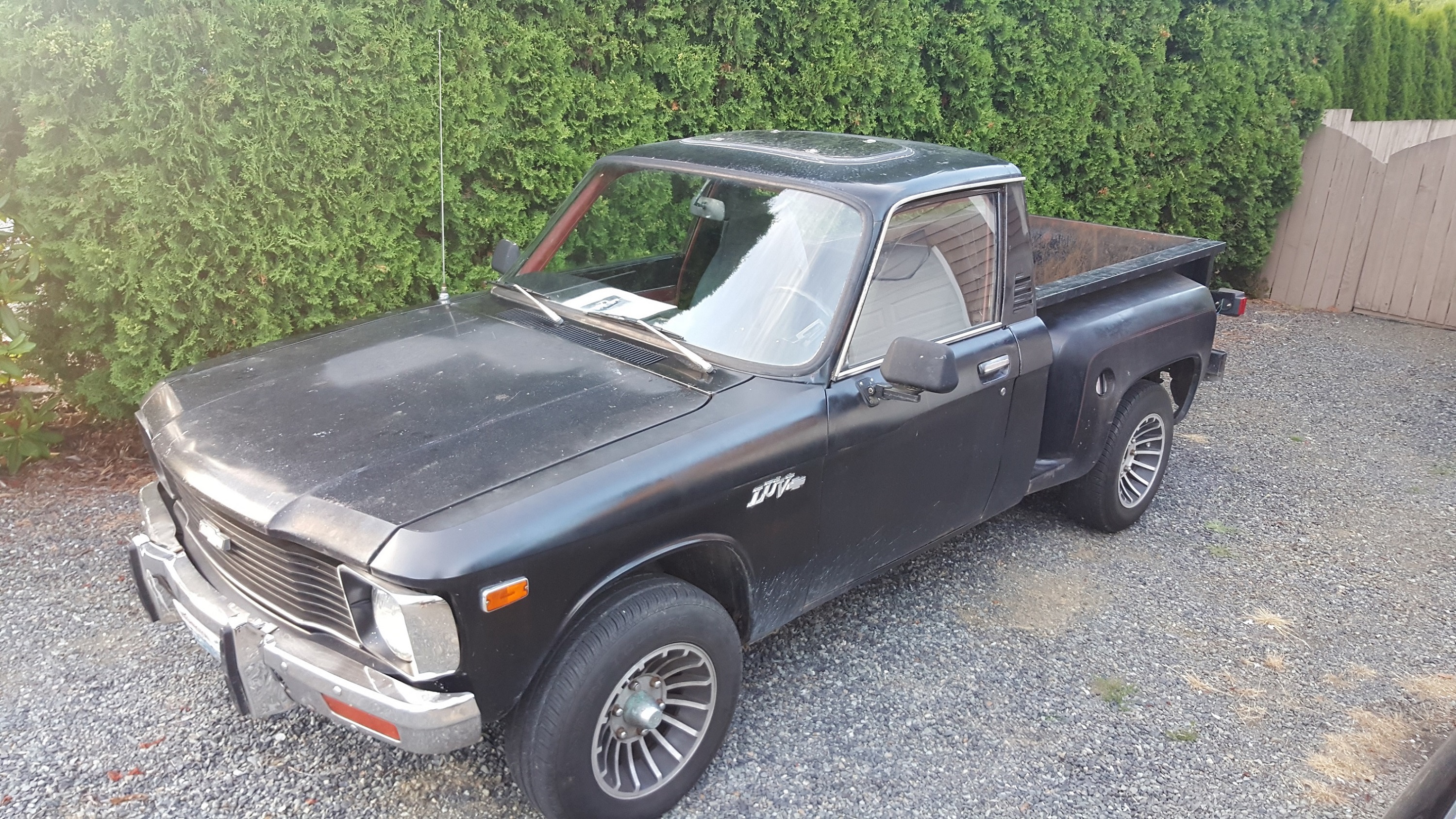

Hello All,
Just picked up my 1978 Chevy luv Mikado stepside. Runs n drives got it for a steal of a deal. Just needs a carb rebuild or tune up, idles rough and stalls also sputtering at low rpm. Then misfire going about 55-60 mph unless I'm coasting haha. Still working on naming this luv.
It has about 82,xxx miles (I dont know if it lapped over to 100k) but barely any rust mostly just surface rust. Deciding on which route to go with this project, I know I am not sticking with this 1.8L, need more power :D Missing a few odds and ends but most is complete.
Well this is all for now.

Welcome, Looks like a great truck to start with. 8)
PostPosted: Thu Jul 07, 2016 1:56 pm
Good lookin truck, the stepsides are getting more and more rare, always someone lookin for one
What part of the pnw are you in?
Many of us went with the more power route and got rid of the 1.8s. Couple options for mainstream swaps.
Isuzu 4 cyls 1.9 and 2.3
Buick 3.8 (older rwd ones not the fwd)
Smallblock chevy
Chevy 4.3 v6 the 3/4 350
Or pretty much whatever rearwheel drive 4 banger you feel like fabricating your own mounts for

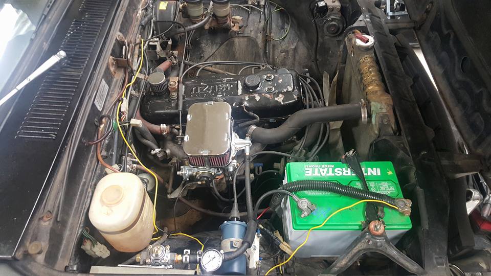

Update:
Weber 32/36 installed, New coil, plugs, condenser, fuel filter, fuel pump, battery, valve cover gasket, etc. Added a semi-new bench seat, removed the ugly bucket seats. Cleaned out added new fuses to fuse box, connections were not too badly corroded. Resealed the sunroof, minor leaks.
Just need to add some gas and ready to roll for the past fuel months of being down.
Need to find a fan heater blower motor to fix my seized one before winter hits.
Pictures to come soon.

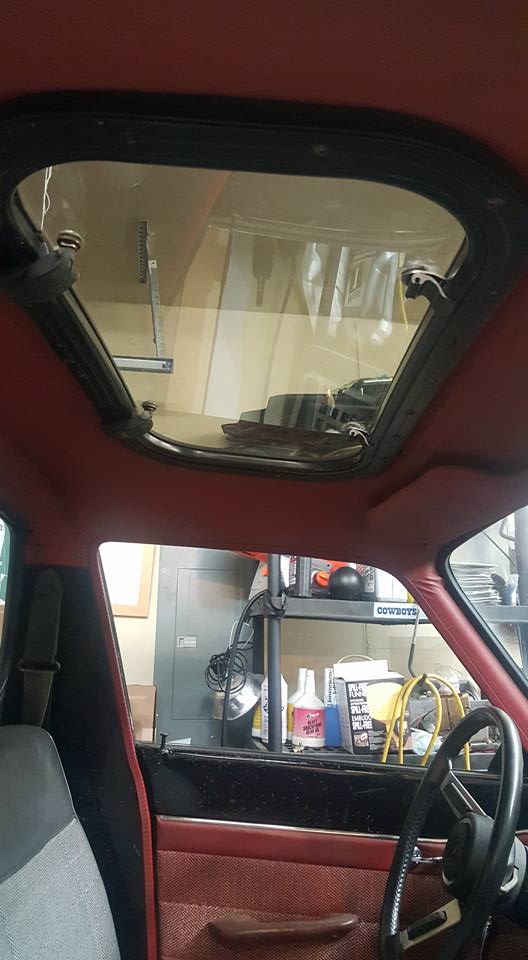

Any idea what that sunroof was originally from?
Waitin on pics
PostPosted: Fri Oct 07, 2016 11:27 am
Posts: 54
Location: Lake Stevens, WA
Waitin on pics
Seems to me the sunroof look to be from the factory. As it fits in perfectly with the headliner.

Looking good. The sunroof is aftermarket, but could have been put on by the dealer. They made good kits back then. 8)

Ok sweet good to know!

Ripper86 wrote:
Welcome !!
The factory carbs are garbage.
Swap it to a Weber 32/36.
3 rebuilds on mine. Still useless.
Does the carb kit come in a kit, or just bolt on? Never had any trouble with points. Is it worth $300 to go electronic?
PostPosted: Sat Oct 08, 2016 8:23 pm
Posts: 131
Location: Lewiston, idaho
Don't need $300 to go electronic get the ignitor kit from pertronix. Around $90.
https://www.summitracing.com/parts/pnx- ... /model/luv
For a weber carb need an adapter to go on your stock intake. Comes in a kit.

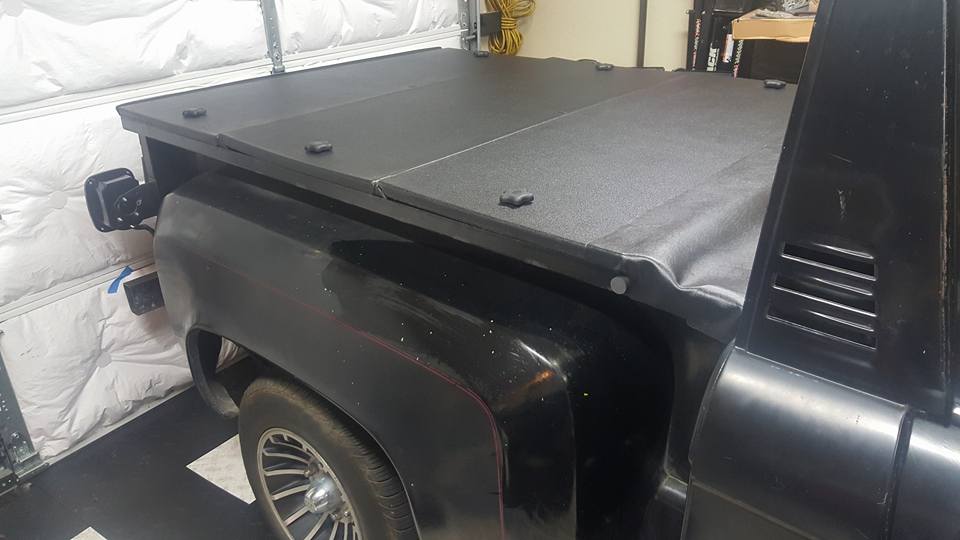

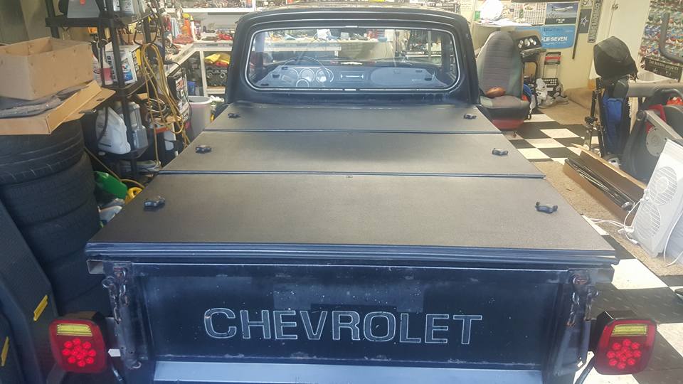

Update:
So I made a semi custom tonneau cover for my Tuff Luv stepside. What you guys think?
Came from a tonneau 3 piece cover from an avalanche or escalade. Bought it for cheap and decided to see if it will fit. It was 4 inches to short so I covered the rest with vinyl and magnets
