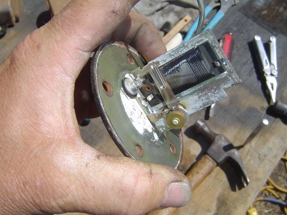

my notes show the couple i have tested that & that came out of a Luv (assuming their stock) measured were between :
Spare Sending unit ohm range reads :
Empty 15.0 ohms to Full 119.0 ohms ...=/- 5. ohms & the one in my truck read
Empty 25.0 ohms to Full 126.0 ohms ...=/- 5. ohms
& for those reading here's a >> How to test them video ......find others watch a few and learn 8)
https://www.youtube.com/watch?v=yU1BDBZWl8A
Once sending unit is out of the tank ....i took the cover off you see this.
This 1st pic is the range your traveling to get low to high ohms ...when testing
The 2nd picture show my fixed connection see that glob. of shiny solder.. :lol:
