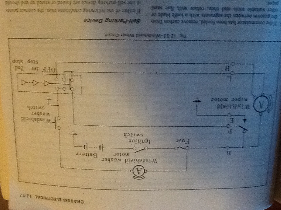

Like others have said. Make sure the wiper shafts are free them hake sure there is power at the switch. This is a easy circuit.
