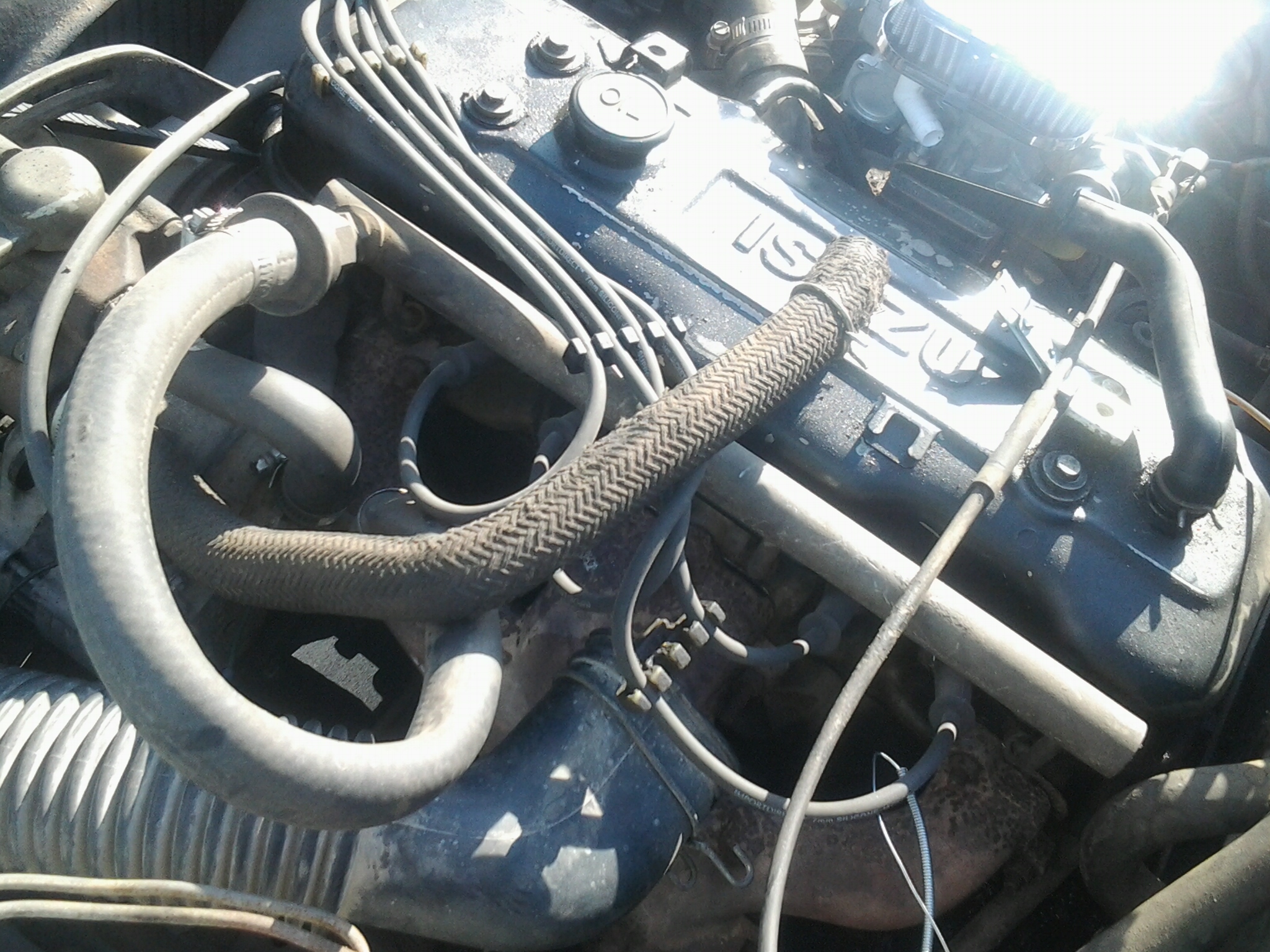

Figure 2: the air filter came with a white plastic L shaped tube that come out the bottom side of the air filter, am i supposed to connect it to anything or plug it off? Follow up question, there is a 6" black hose coming off the top of the oil pan, it used to be connected to the old air filter. Do i need to plug that or somehow connect it to the small white plastic L?
Figure 3: The mesh looking hose that comes off my emissions BS... same question, plug it or don't worry about it? I should probably just do a smog delete but i will save that project for another day. Baby steps. :D

The fabric covered hose supplies air to the air pump for injection into the exhaust ports, normally it's hooked to the bottom of the stock air cleaner similar to the PCV hose. The Weber has no provisions to re-attach it. Is the pump functional? Will it remain functional? If so put some type filter on the end of the pump intake. If not toss the hose & the pump.

As far as the cloth covered hose coming from the smog unit that i needed to put a filter on... I found an old sock, stuck the hose in it, and put a hose clamp around it. Stuffed the hose up to the side by the fuse box so the sock wouldn't catch on fire and that's where it rode during my 30 mile journey to check my mpg.

the emissions junk can be removed fairly easily. the egr is the copper pipe from exhaust to under intake manifold. u would need to remove it and plug both ends
the smog pump and air injection rail over the exhaust mani can go. u can plug those four holes with spark plugs or a 14mm x1.25 thread plug
