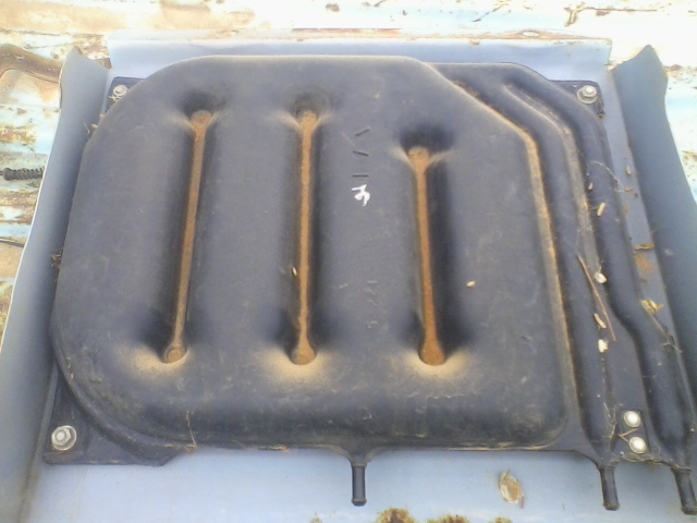

So first off, what is this? (Pic below... Located on driver side of the bed, behind a panel. 3 lines from the gas tank run to this.) Is it needed or can I bypass it?
^ I'm not sure what that is....

That is your fuel expansion/vapor recovery tank. One line goes to the front of the truck and connects to a solinoid. The other lines go to the fuel tank. It does nothing to remove it. If you do remove it make sure you plug the lines going to the fuel tank and get a vented cap. You will smell fuel at times with this removed.
Okay, the line that goes to the front of the truck has been removed by previous owner (and left open on the metal fitting on the tank....)
What about putting a small venting filter on the main hose?
The only reason why I'm considering removing this is because I don't want it to possibly contaminate the gas tank after its cleaned.... It was easy to remove but I only want to do it once. Looking into the fittings on this vapor tank it looks rather dirty....
