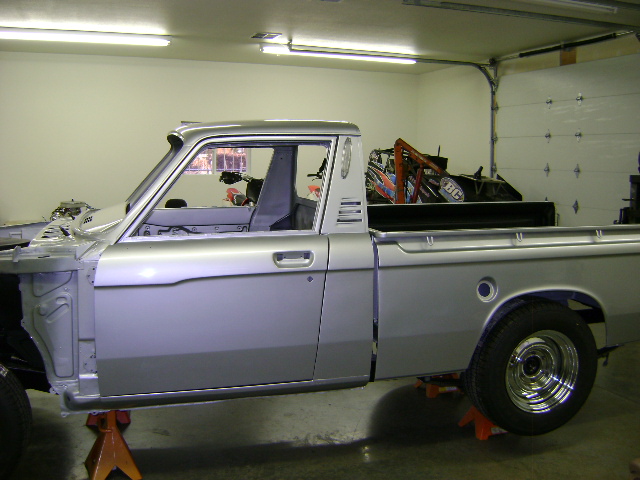

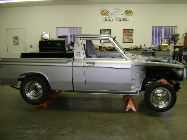

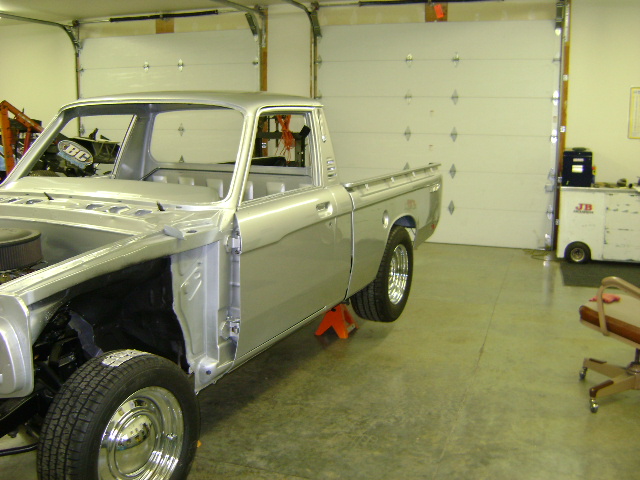

doors on and ready to put the guts in it

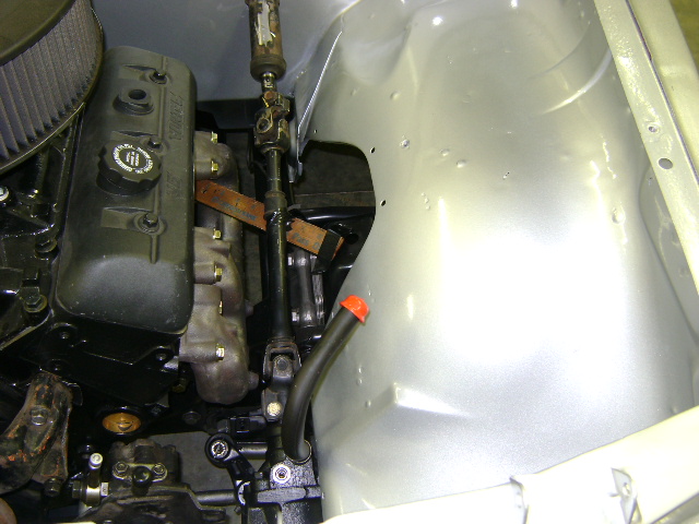

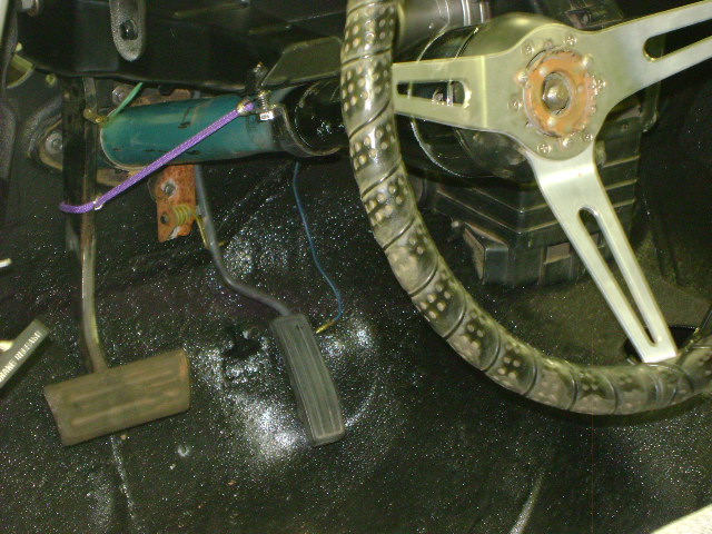

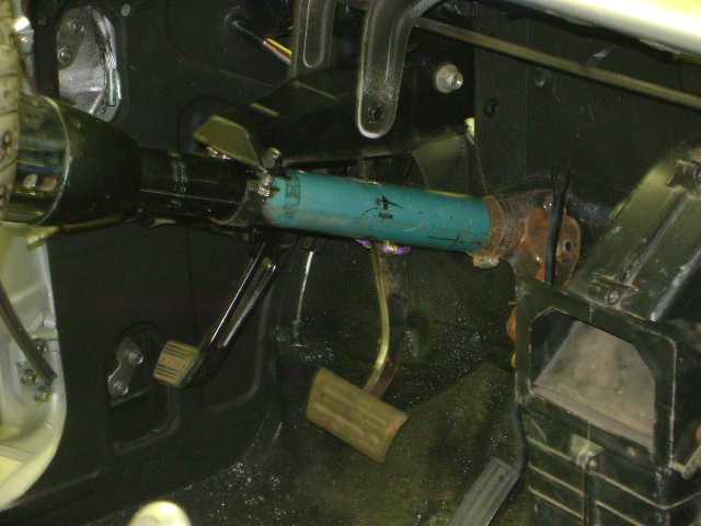

got the steering column made and the stafts to the box made

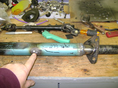

the steering column is a piece of work . from the 90 tropper power steering box , the shaft from the box to the column is a 2000 nisson frontier , the lower shaft is a 90 tropper and the lower housing is 75 luv . the upper haft of the shaft and housing is 67 chevy . when i take it apart for paint ill get some better pics . the pump is a 90 tropper .

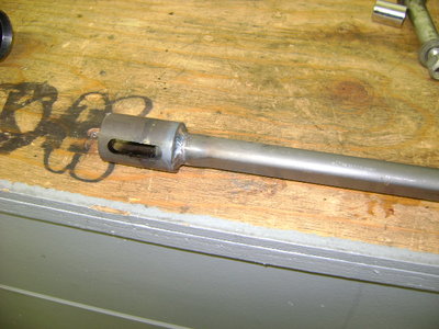

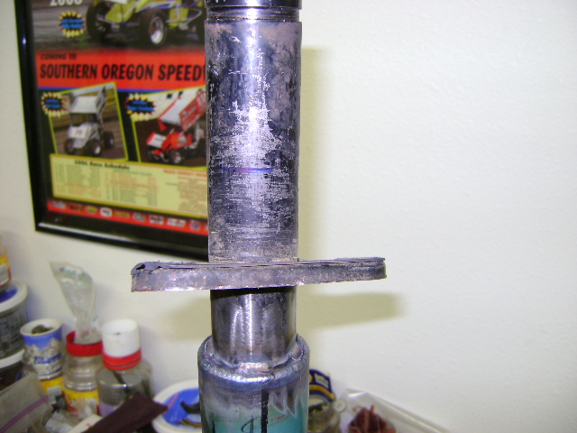

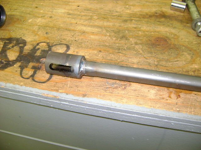

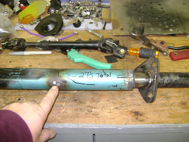

the steering column is welded
we made a washer to fit over the 75 tube and in side the 67 tube so it would keep a straight line through the tube
the coupler made it all possible

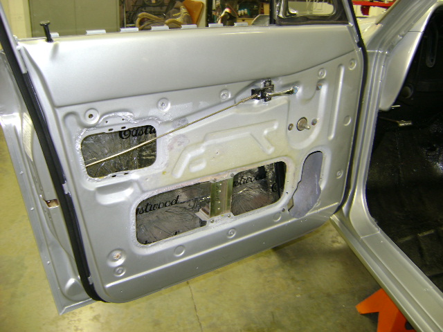

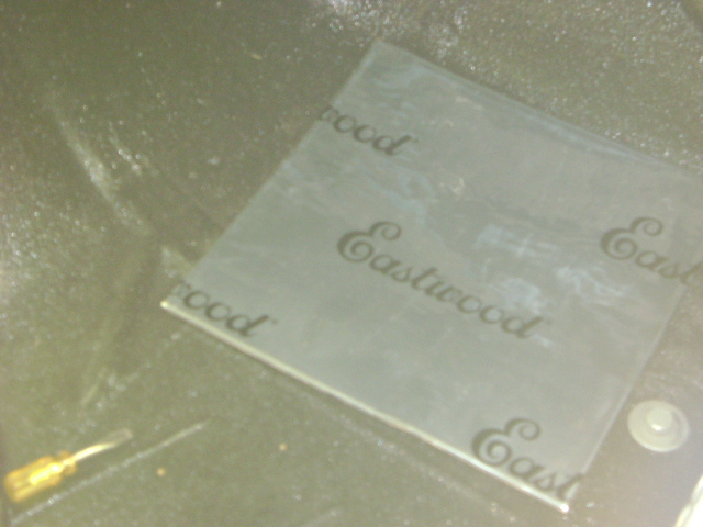

got a great deal on sound deadner EBAY 1999 and free shipping for 5 square feet . half the price of dynamat .

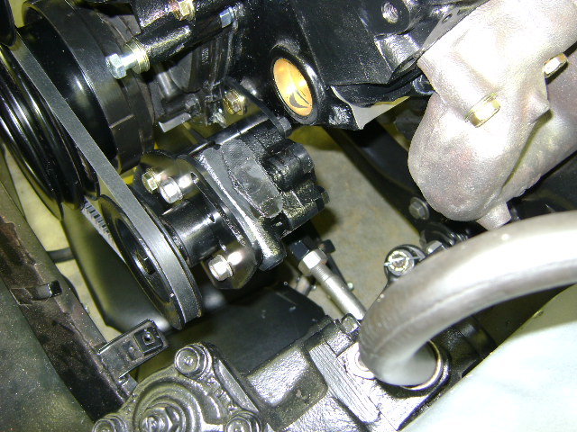

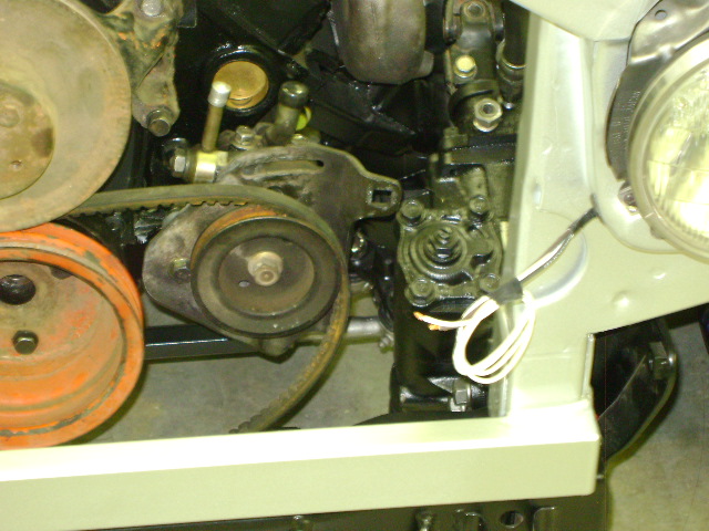

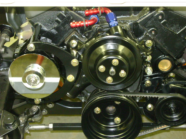

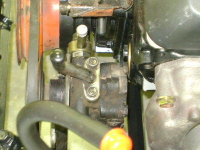

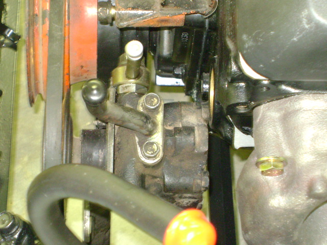

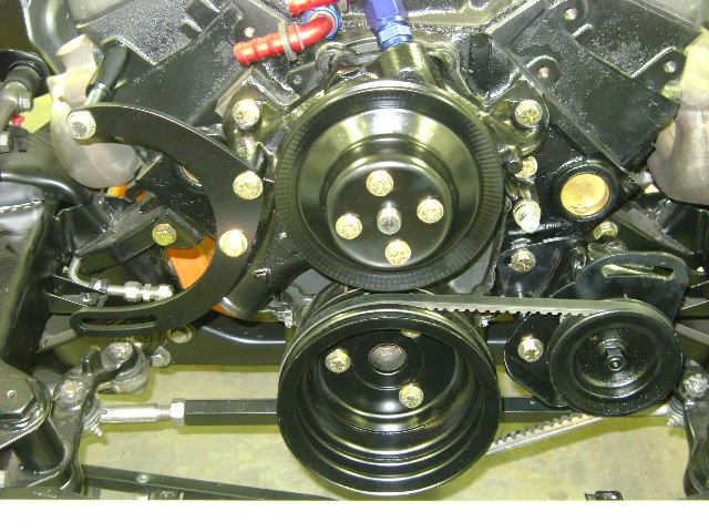

a littel more progress , pulleys and mounts for the alt . and power steering all done and powder coated
 Post subject: Re: Norms 75 luv build
PostPosted: Thu Dec 29, 2011 8:03 pm
Joined: Mon Jan 03, 2011 5:33 pm
Posts: 12

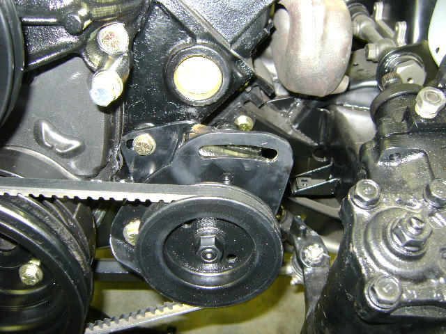

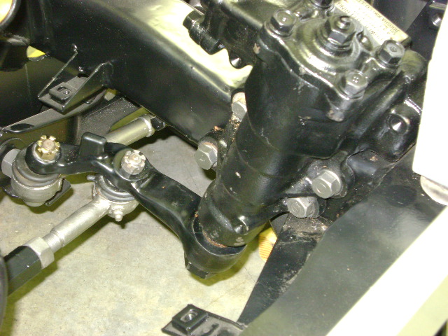

Is that the trooper pitman arm on the PS box? or was you able to install the stock LUV on the PS Box? Maybe I have the wrong PS box because my shaft on the PS Box is larger?........Please advise and explain thanks!
PostPosted: Thu Dec 29, 2011 10:35 pm
Posts: 158
Location: cental point oregon
Hello sdeiter544 thanks for the intrest . the pittman arm hub that bolts on the tropper box stays , then cut the luv pittman arm . remember to take alot of measuerments and right them down . pay close attention to the up and down of the pittman arm so as not to hit the frame as you turn . the best way is to have a 2nd luv pttman arm so you can get the up and and side to side correct . the pittman arm is made of cast steel not cast iron so welding is easy . BUT I WOULD HAVE A PRO TIG WELD IT . I hope this helps if not ask again and ill try to come up with the right answer .

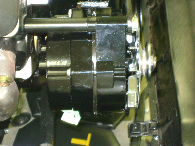

got a little done on the luv today . got alt. mounted and wired .
