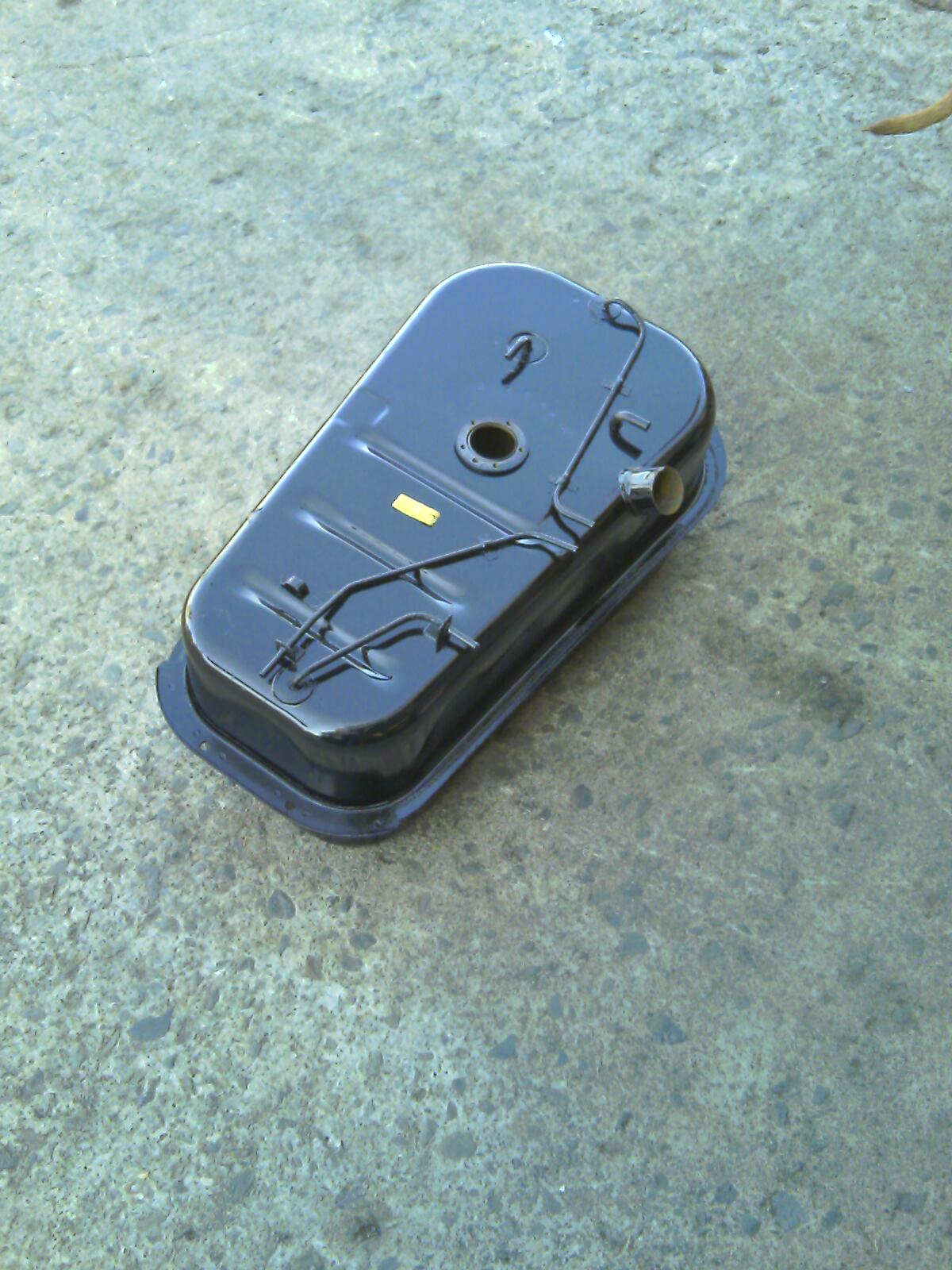

I got it started on Friday !! I spent the whole day wrenching on the 72 , I removed the smog pump and changed the oil , sucked out the old gas , new radiator fluid with new cap , and a new battery …
I turned the key and it turned over but wouldn’t stay fired …. I poured some fuel down into the carb and it fired right up / so I thought the fuel pump was toast ( it was ) so I updated it with a electronic EMPI fuel pump ( a VW part ) and tried to fire it up again ….. nothing , so I figured I had a few pieces of old crud blocking the fuel line . Which was the issue after I pulled the tank and looked inside I found the culprit ( rust everywhere ) I’m sending the tank out to get refurbished and I’m looking for a replacement gauge for the tank , I hope to have it running and driving in two weeks

all better now !!
