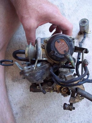

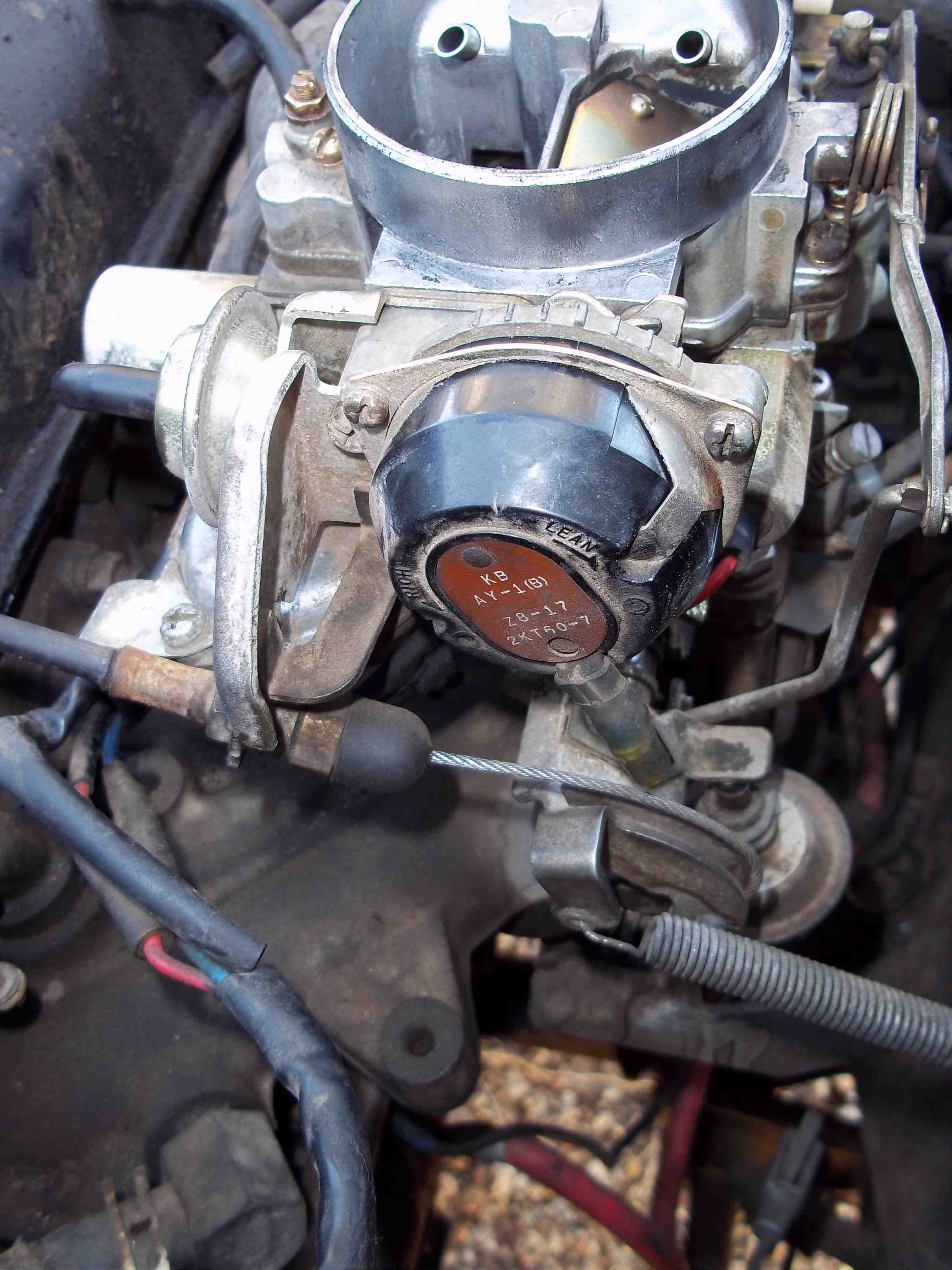

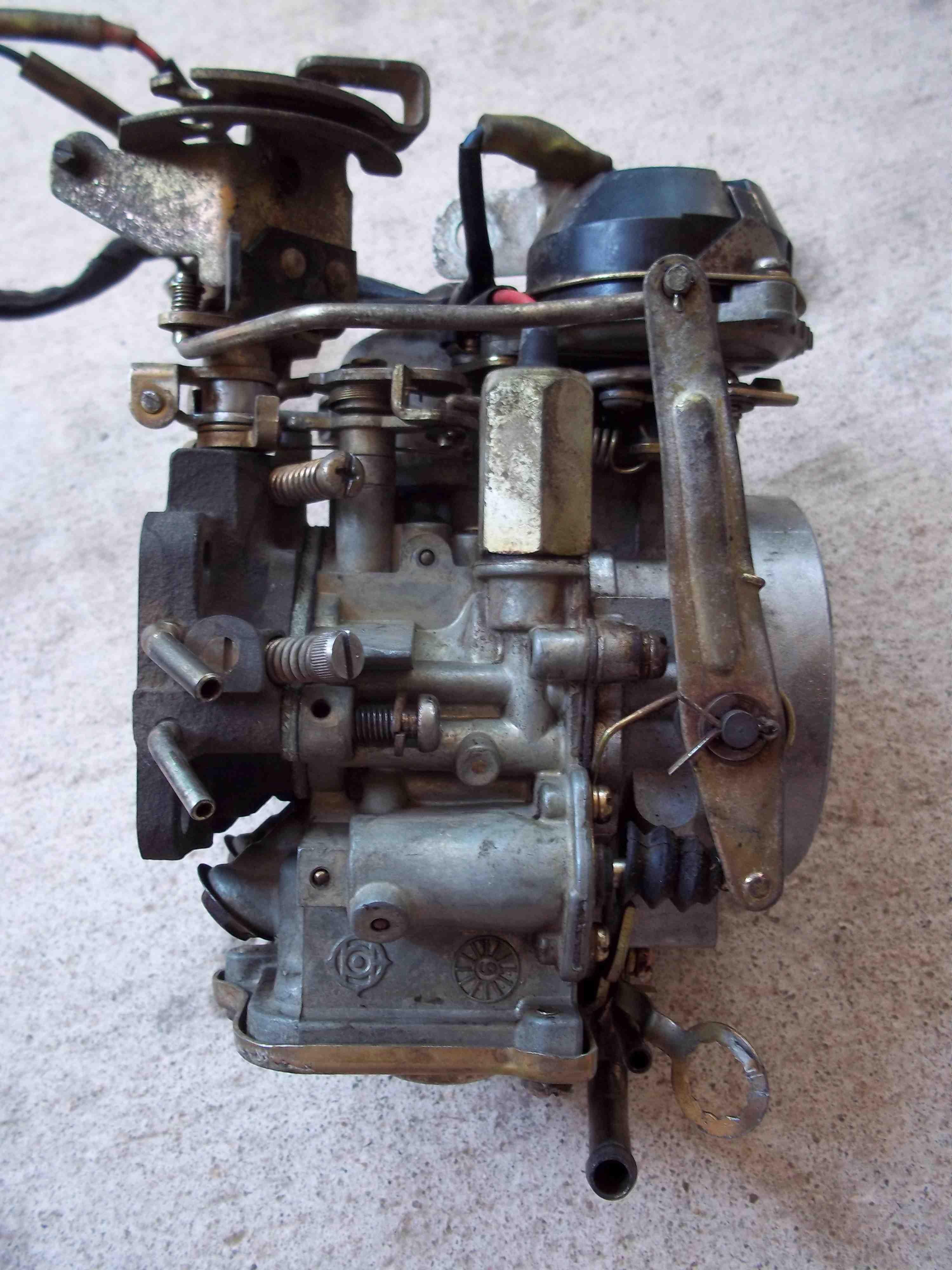

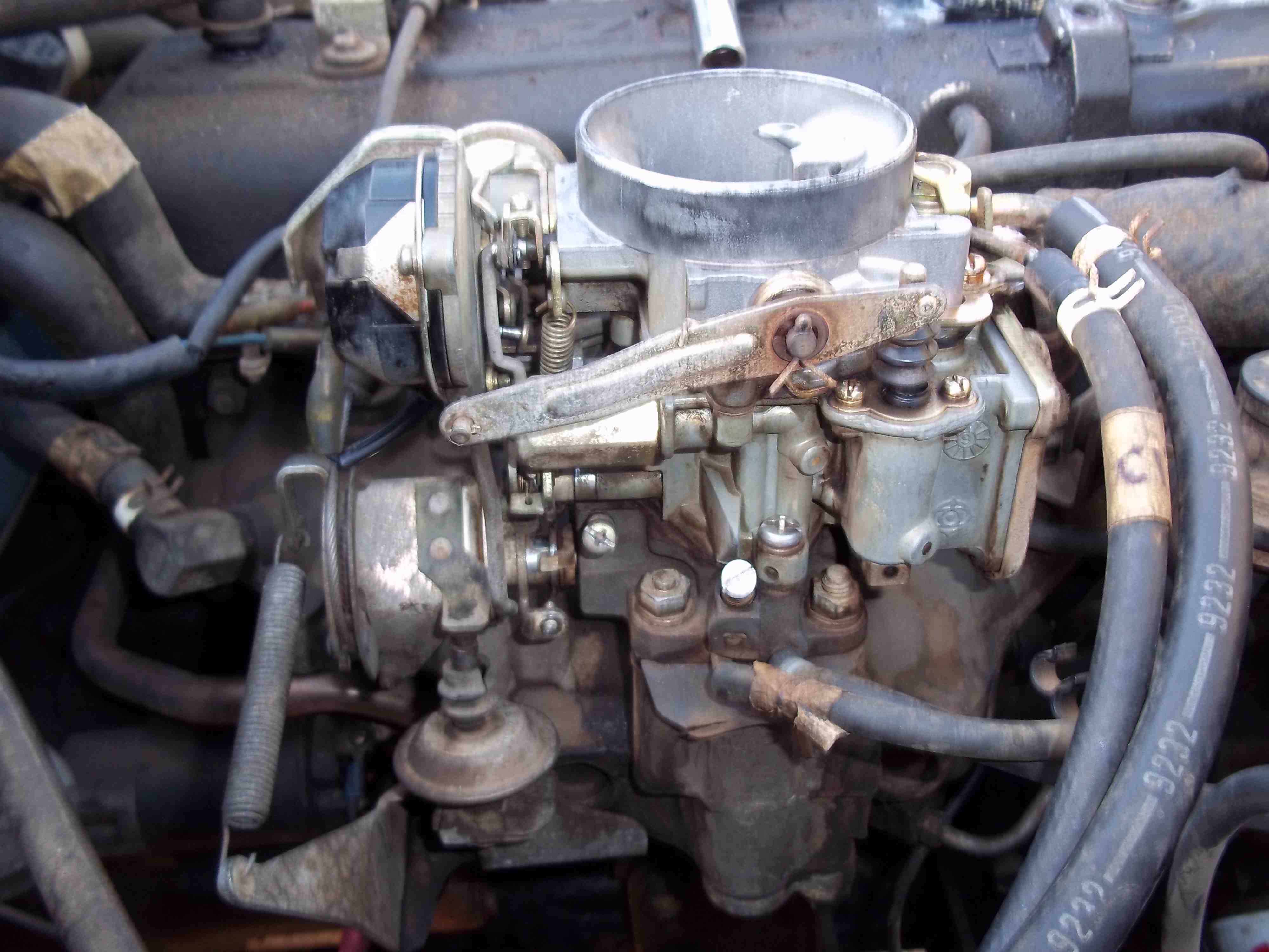

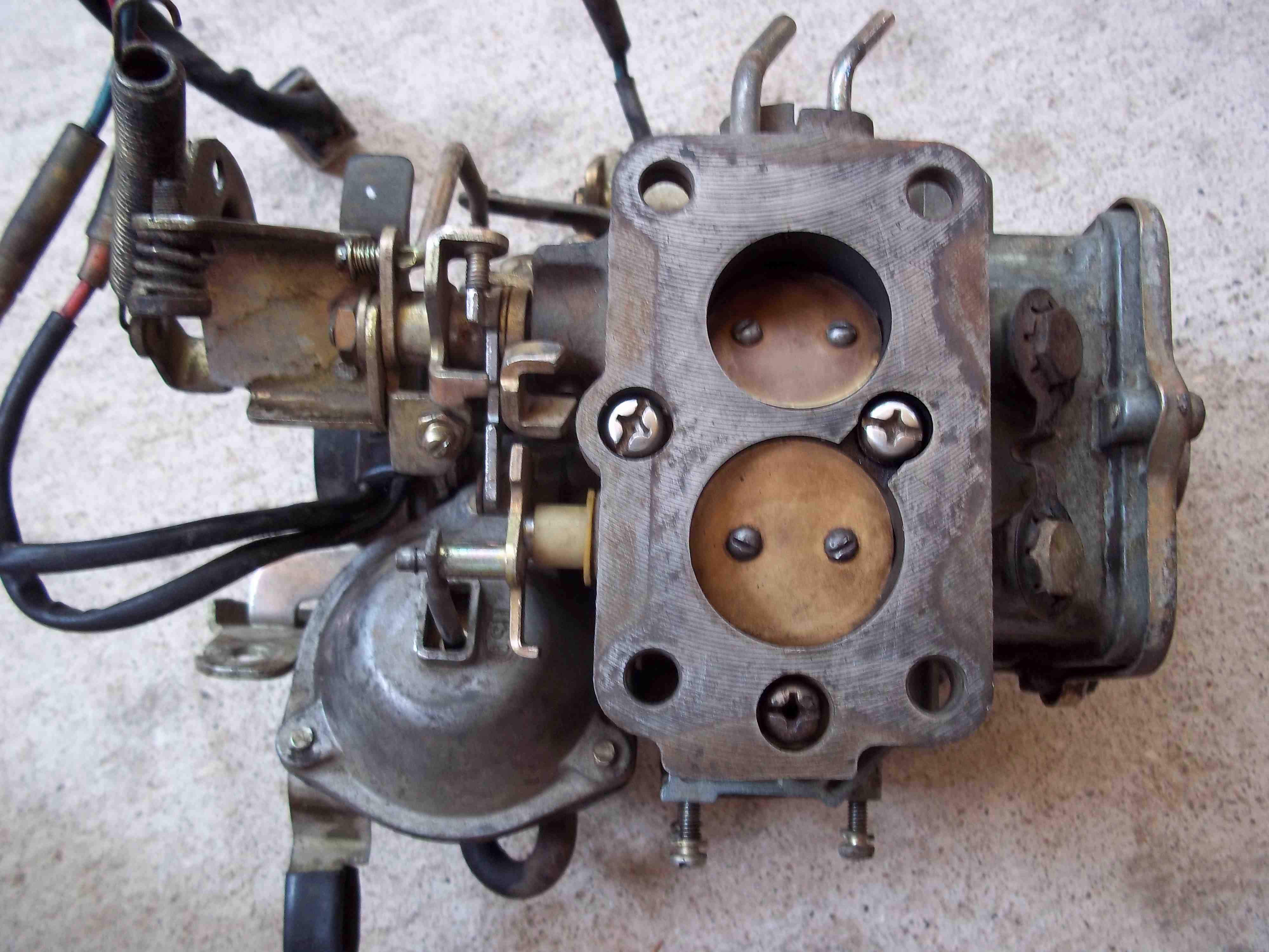

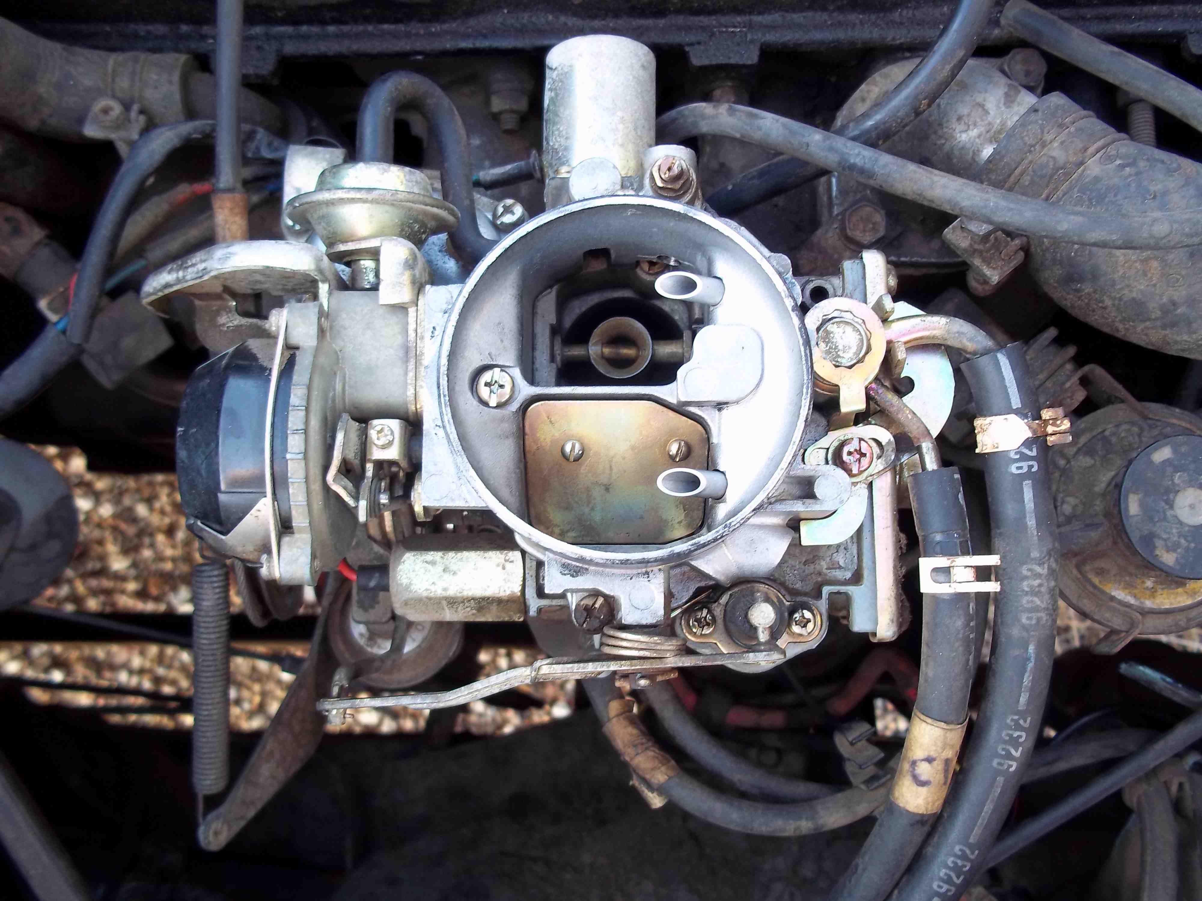

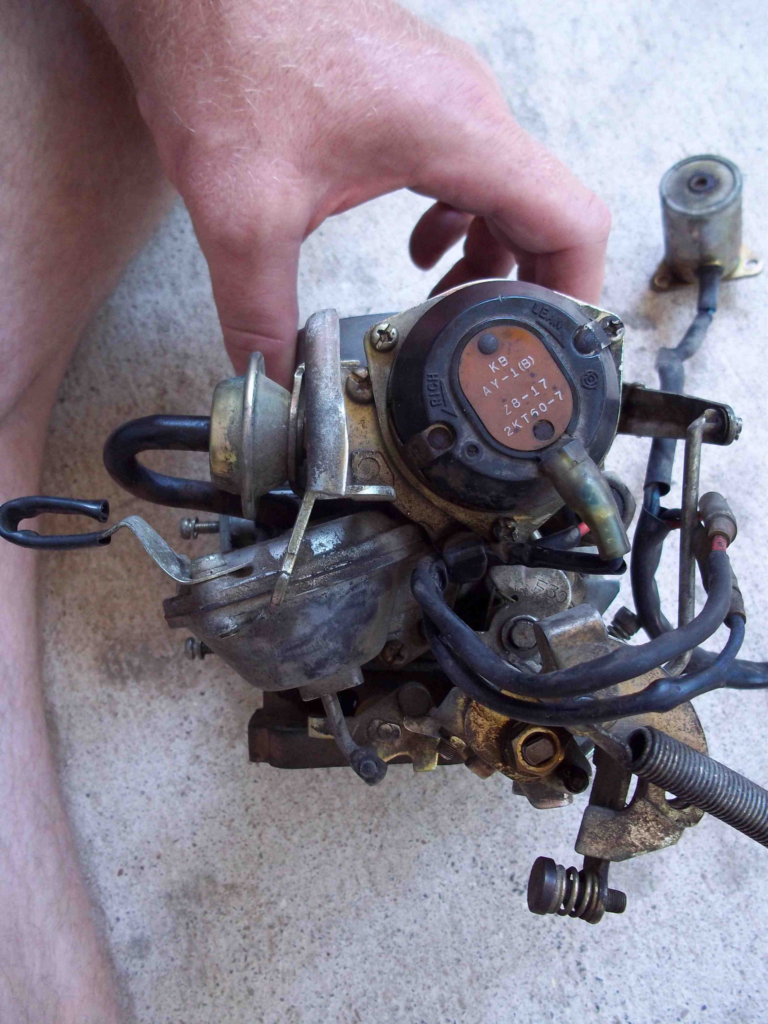

more stock carb pics:

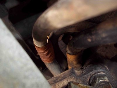

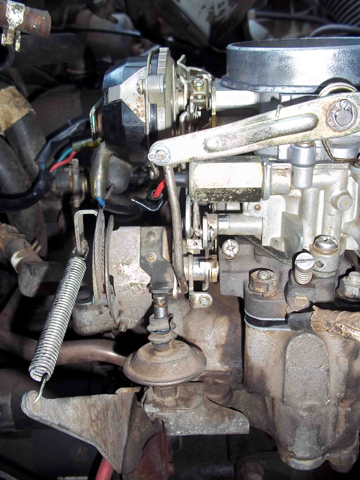

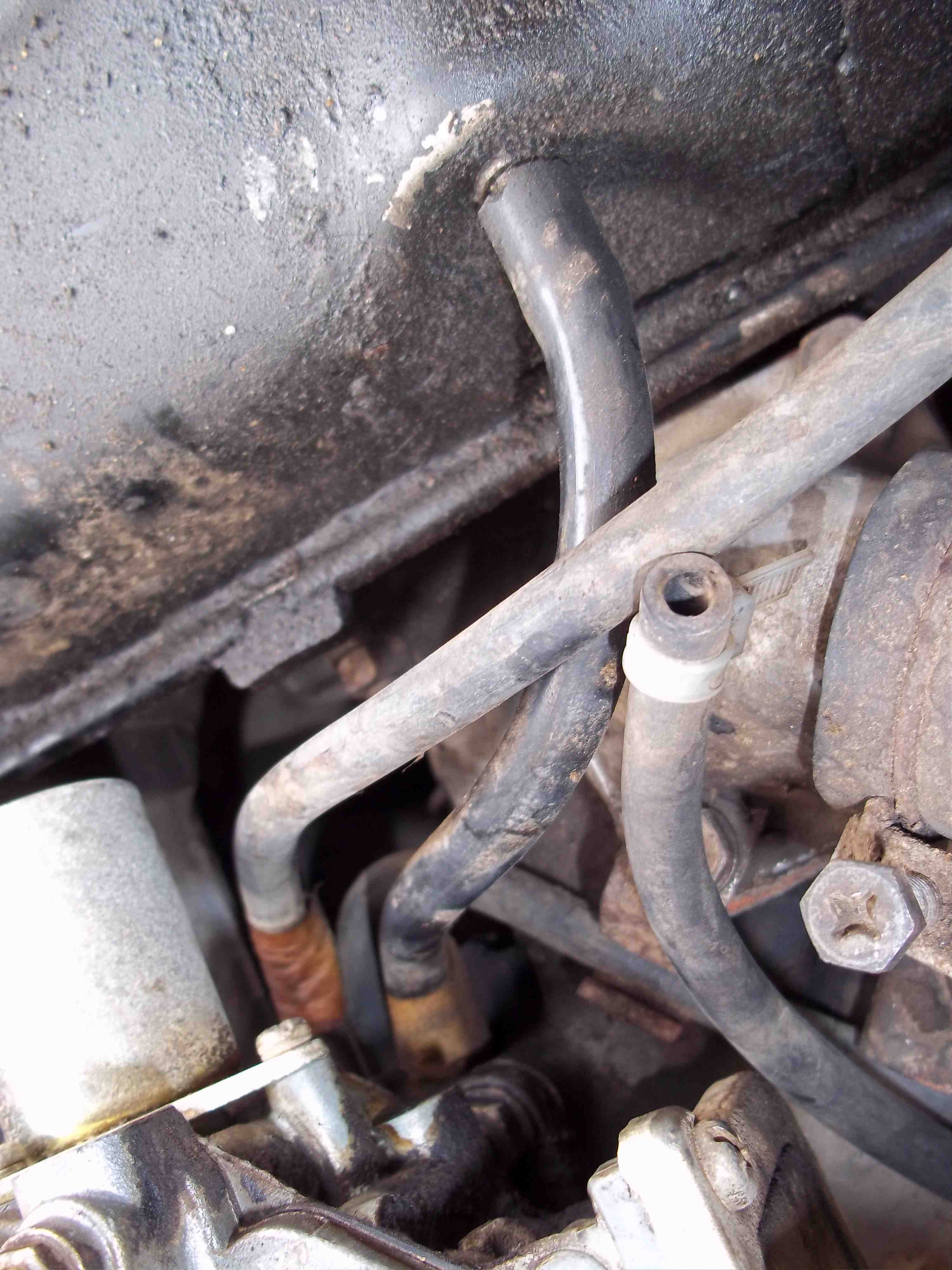

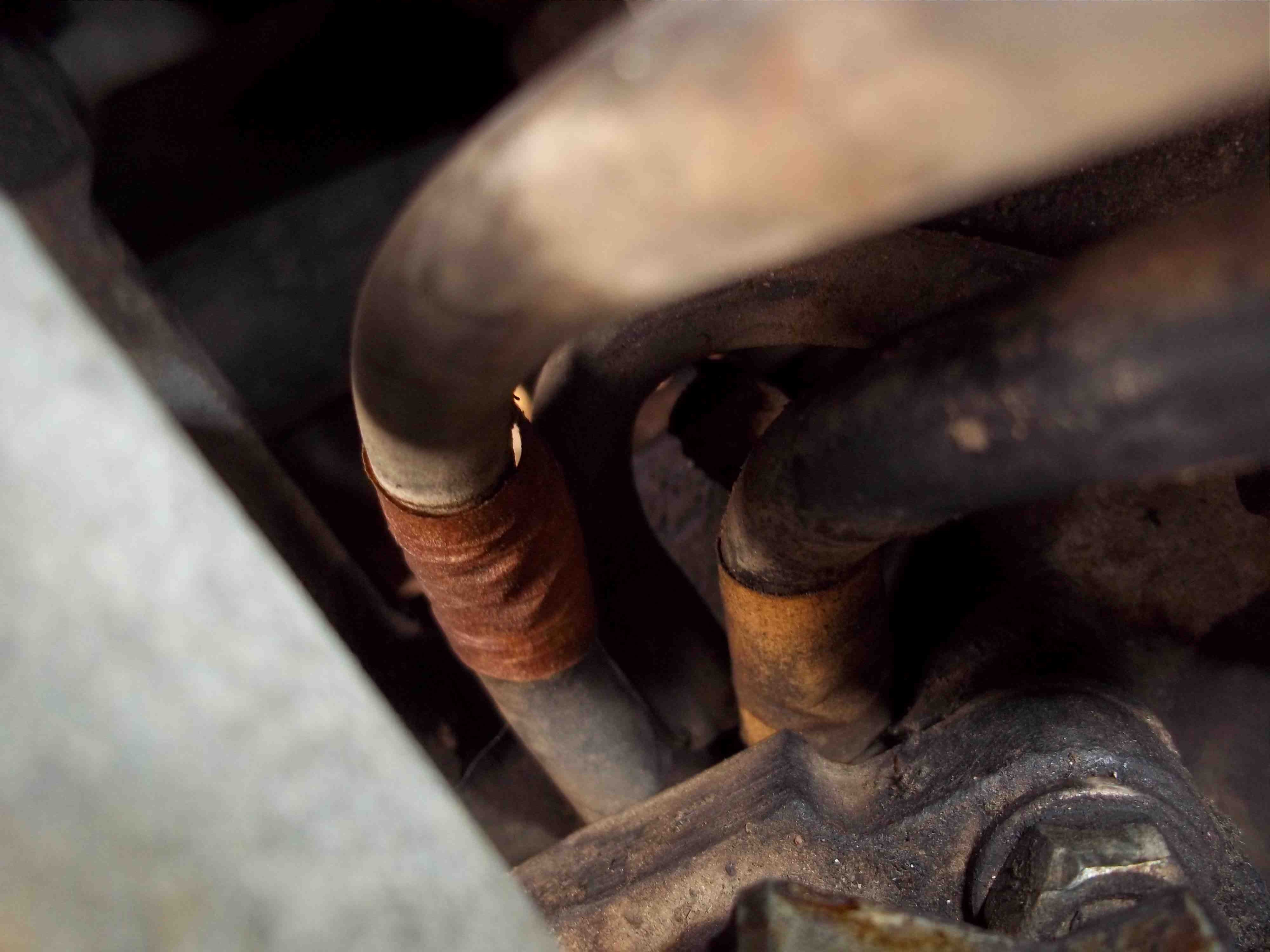

vacuum lines to intake manifold:
File comment: the three vacuum lines to the intake manifold, can be a bit confusing...
File comment: close up of the three lines
File comment: the three vacuum line attachments on the intake manifold

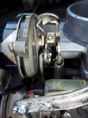

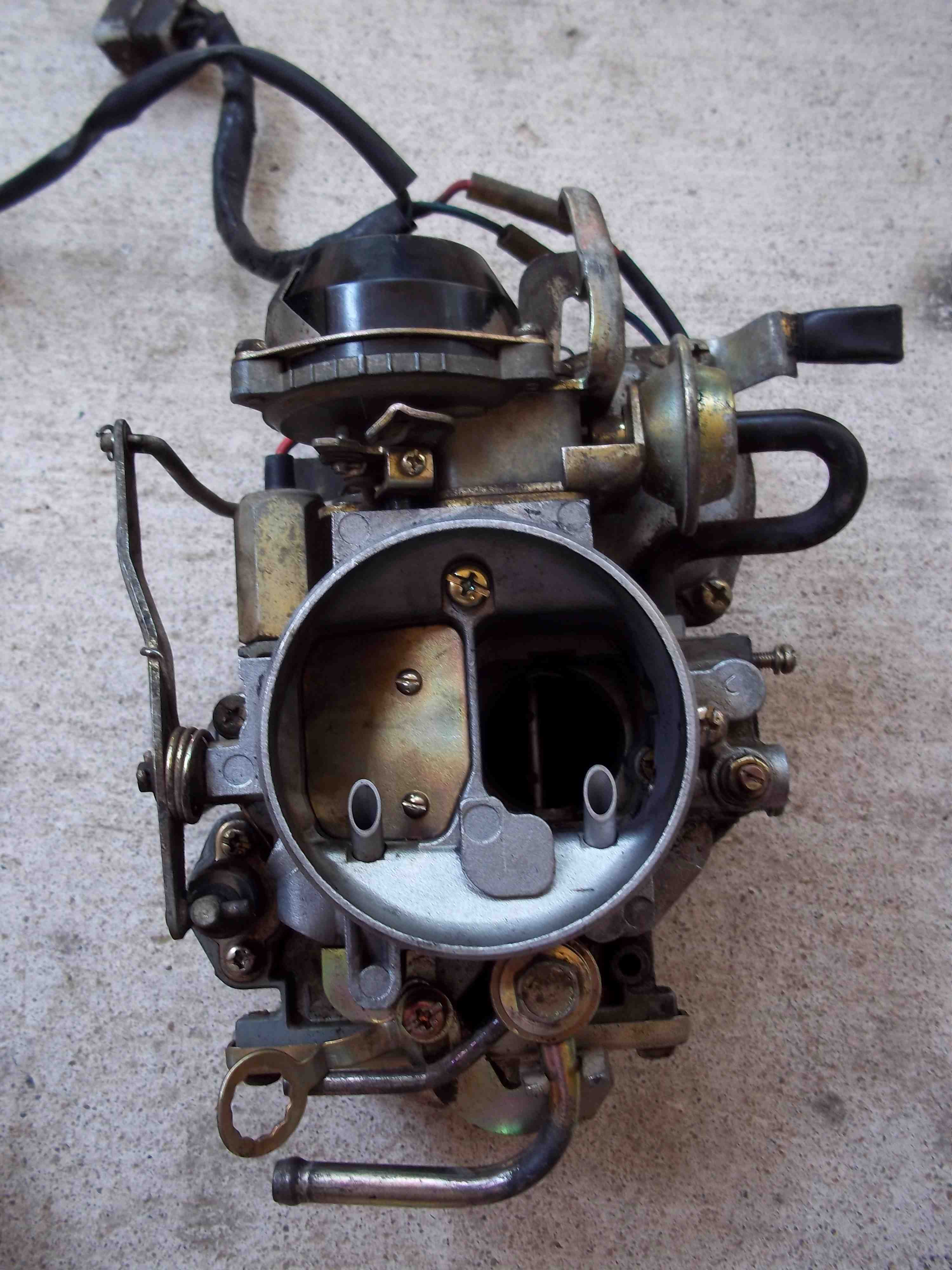

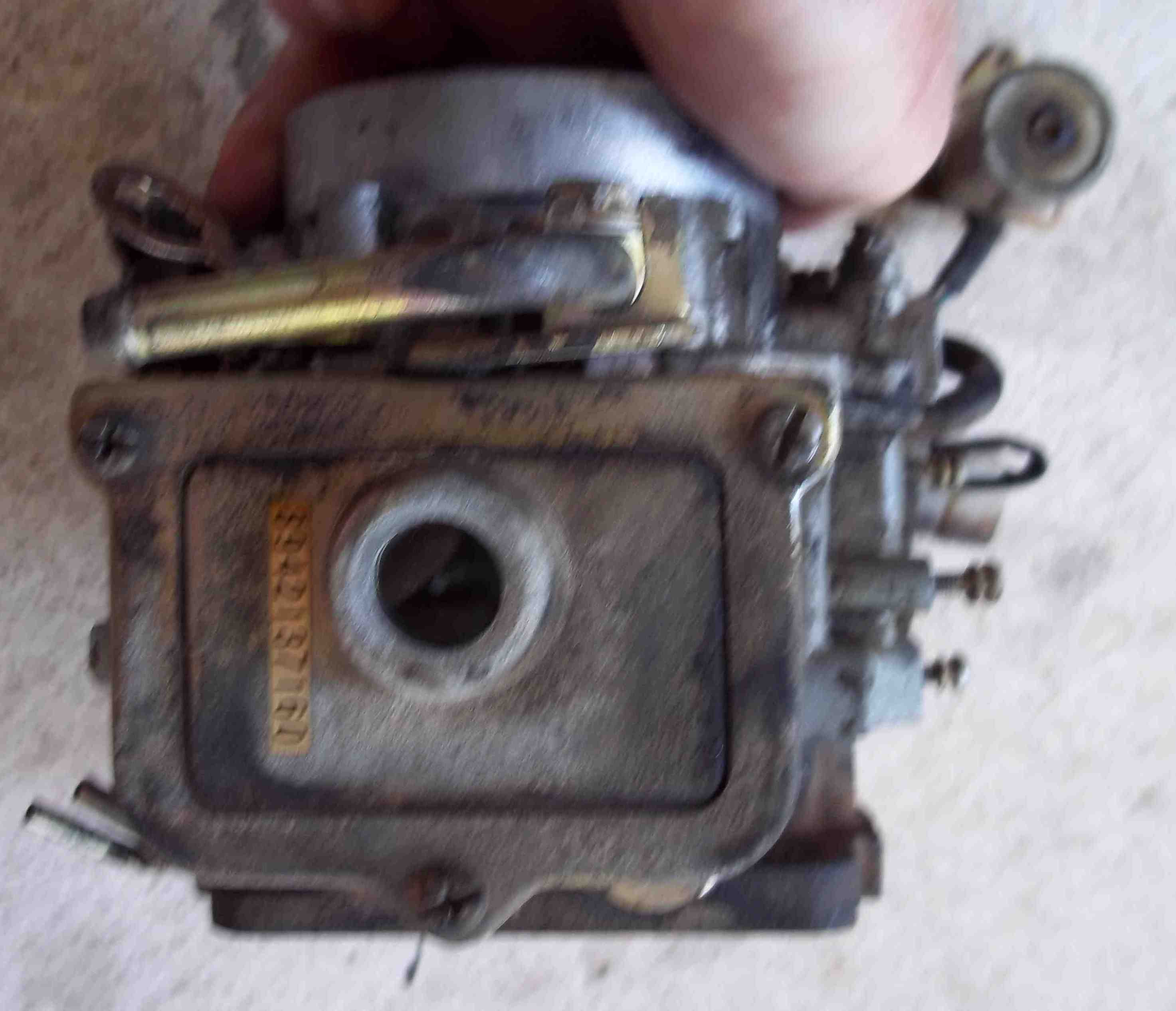

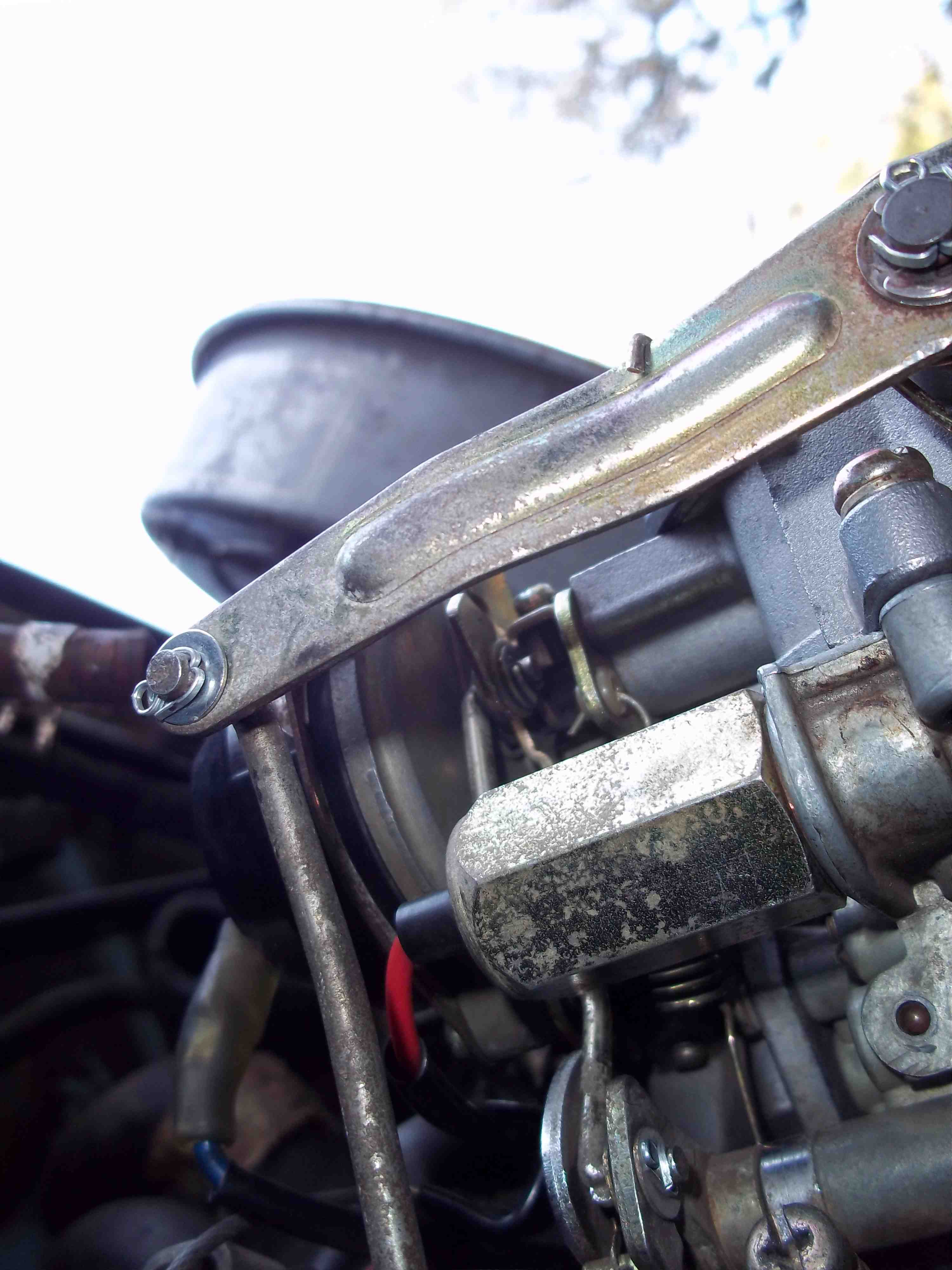

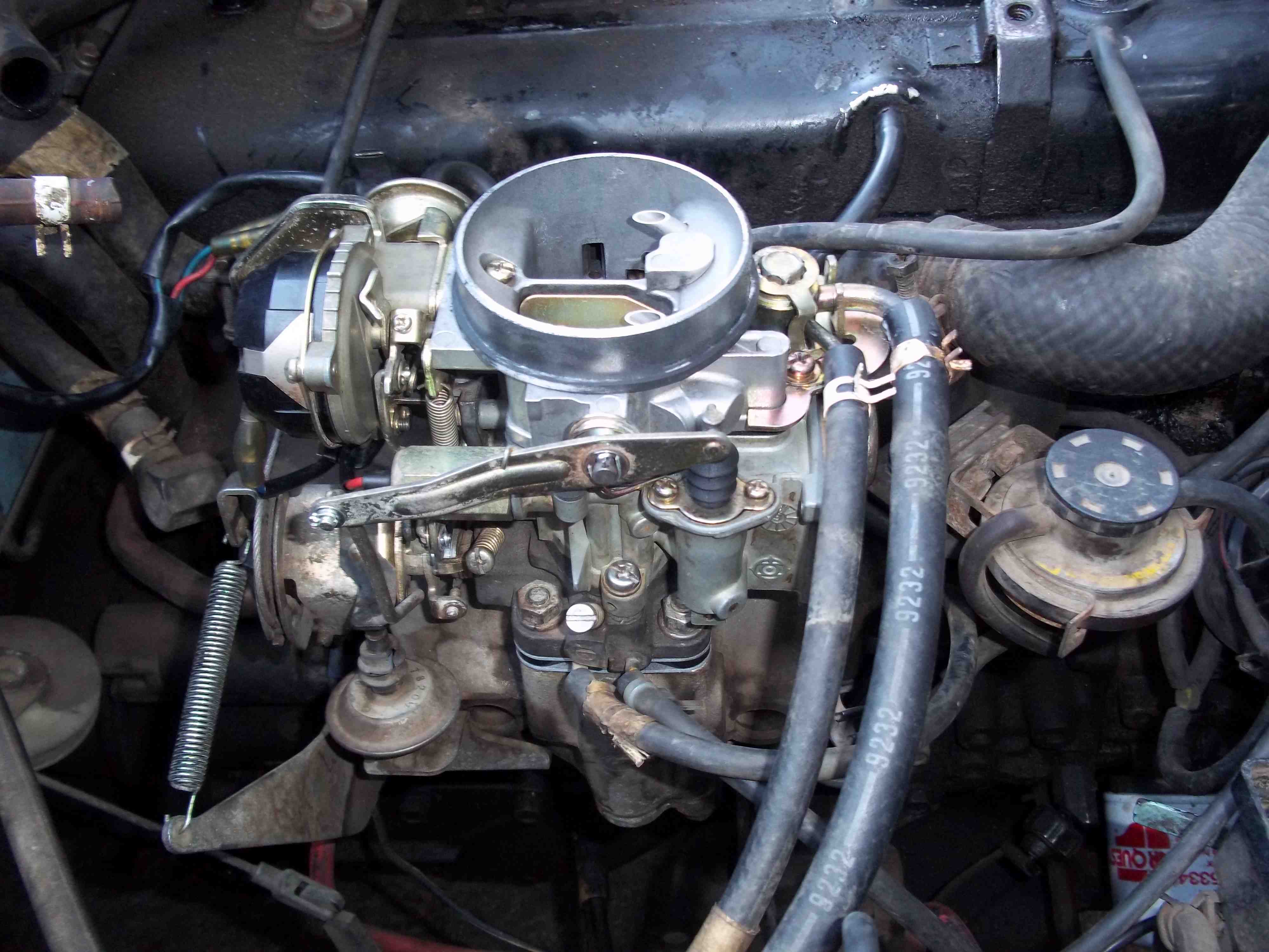

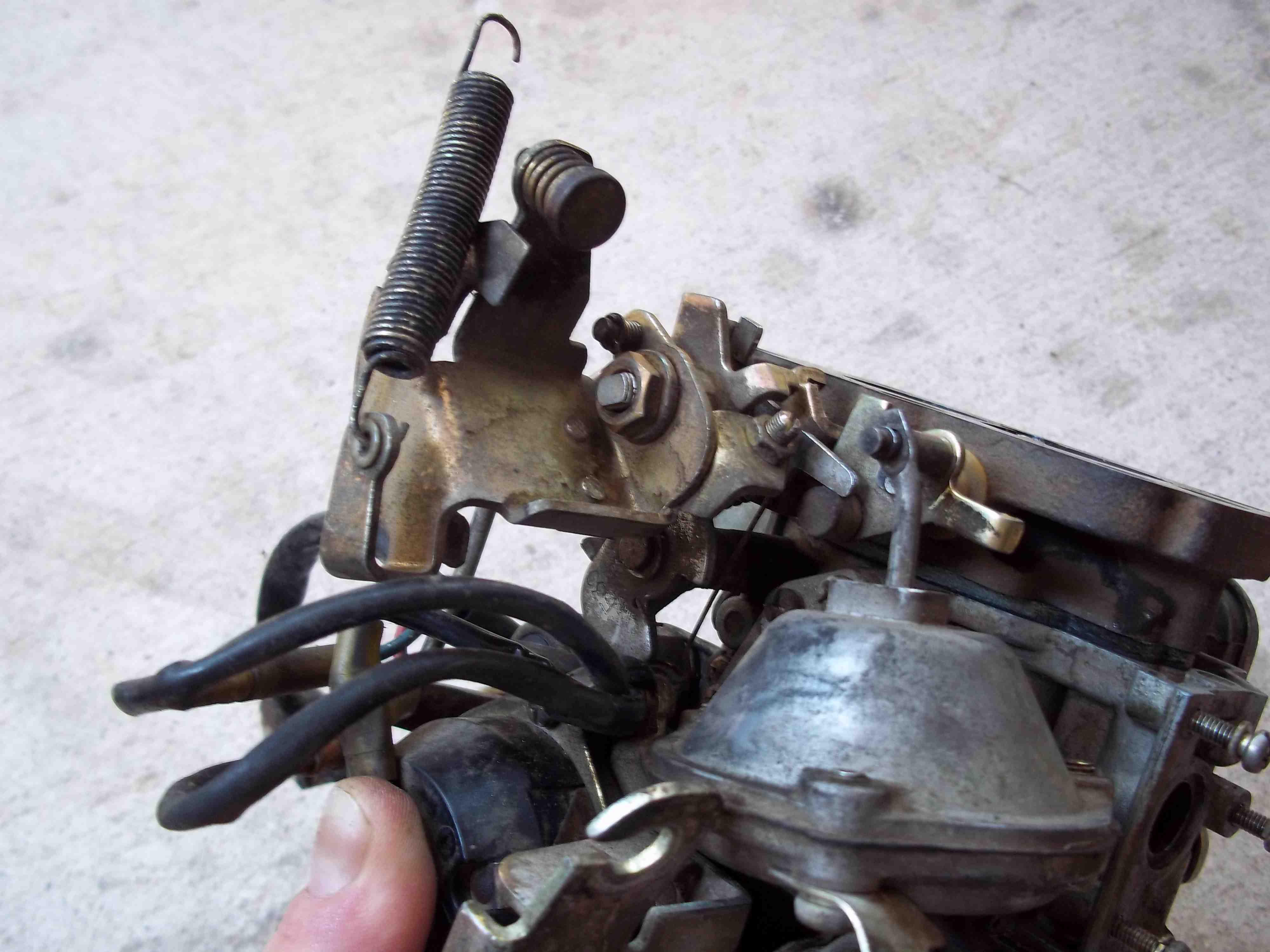

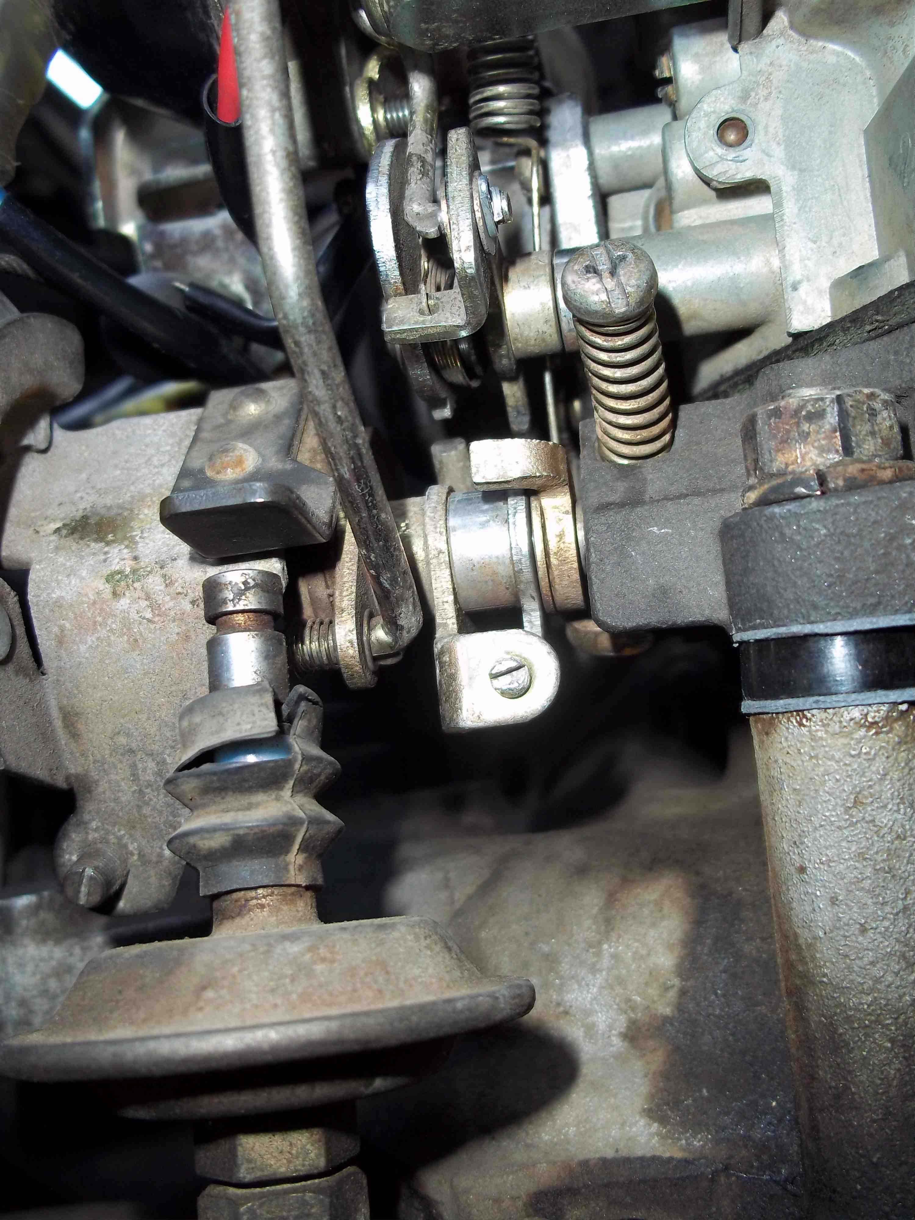

more carb pics:

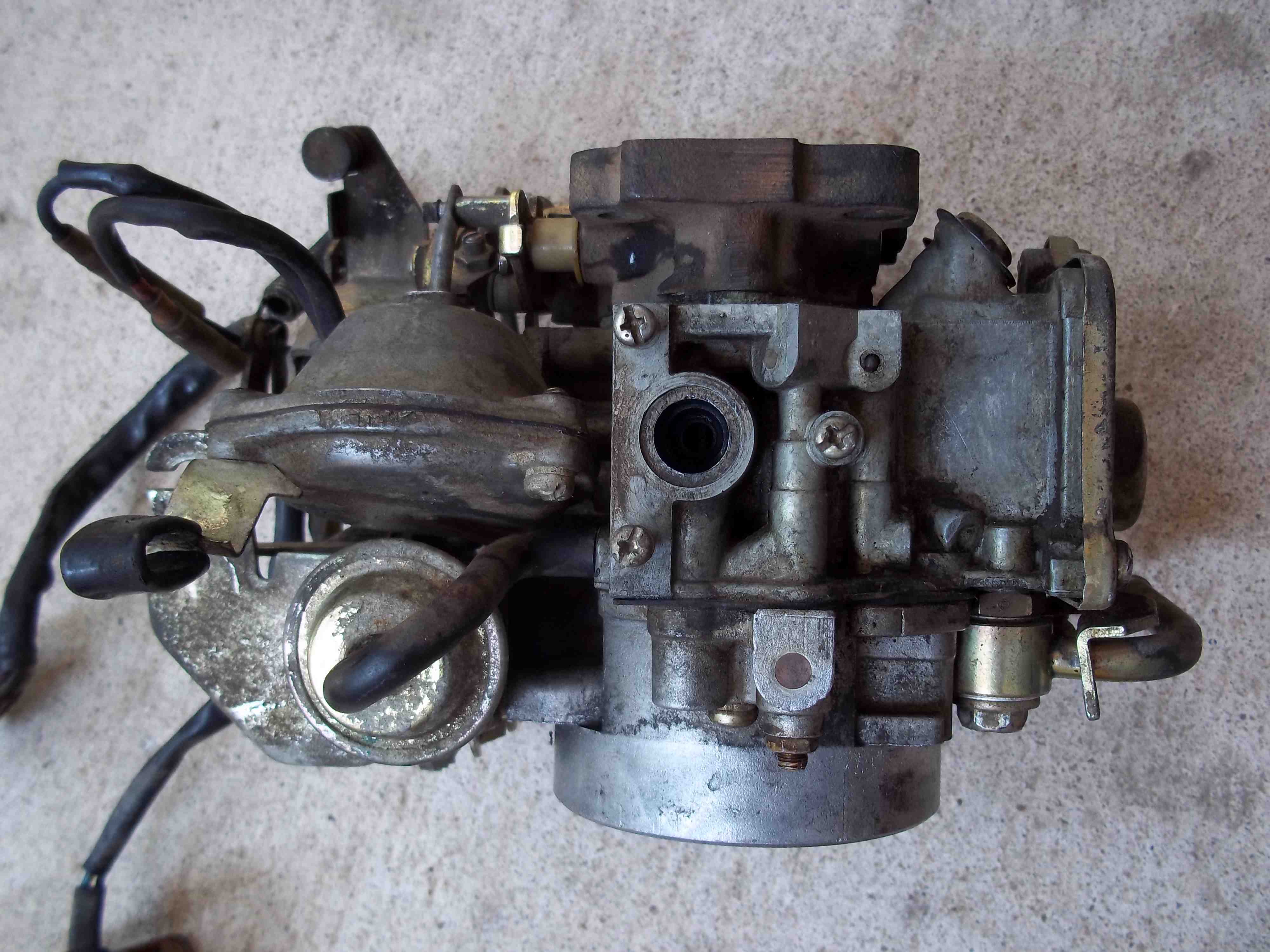

more:

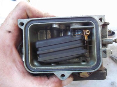

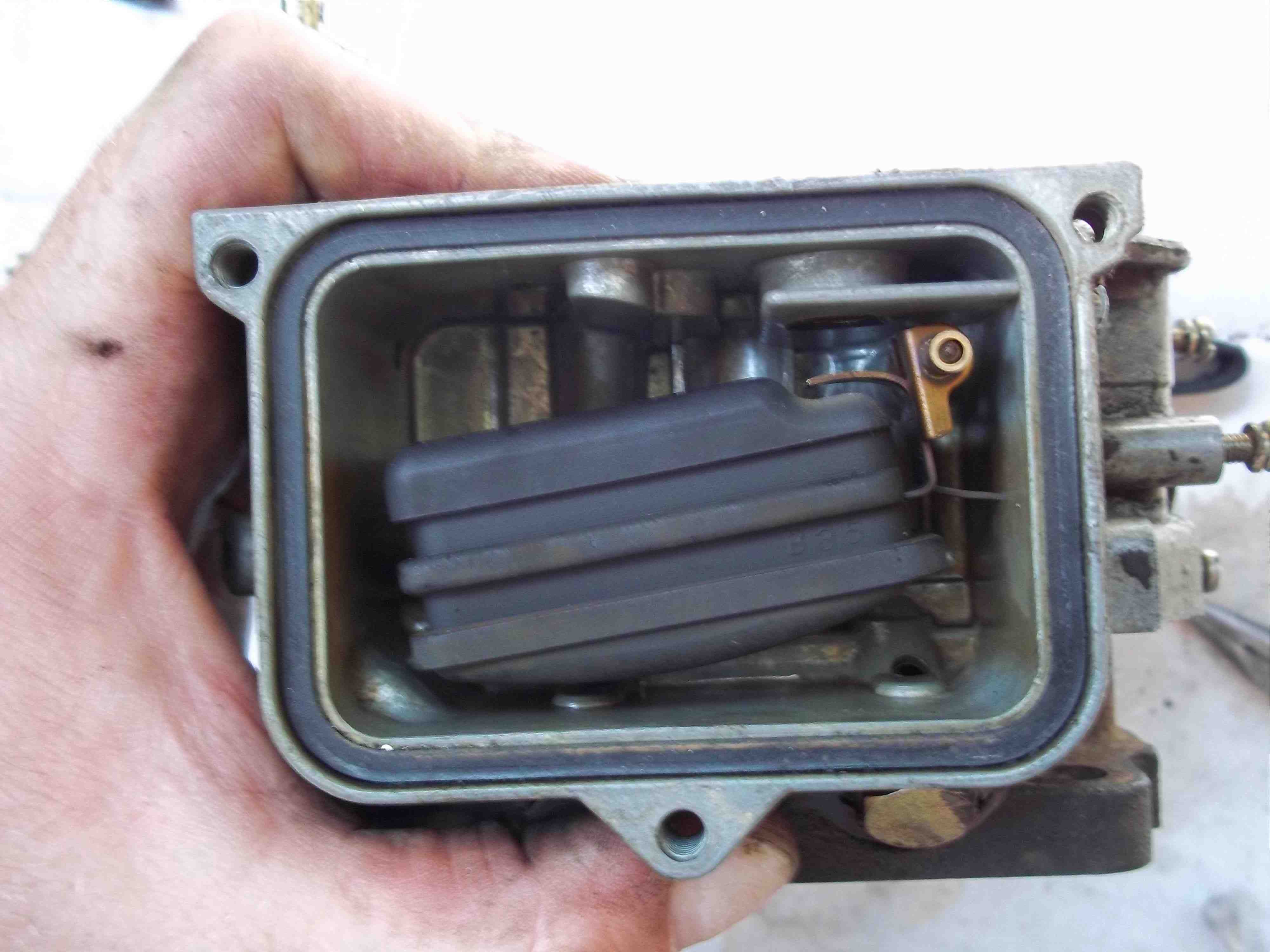

float bowl and float:
File comment: float bowl with cover on
File comment: float bowl and float, don't lose that brass spacer on the pic when you take the float off!!!

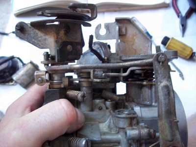

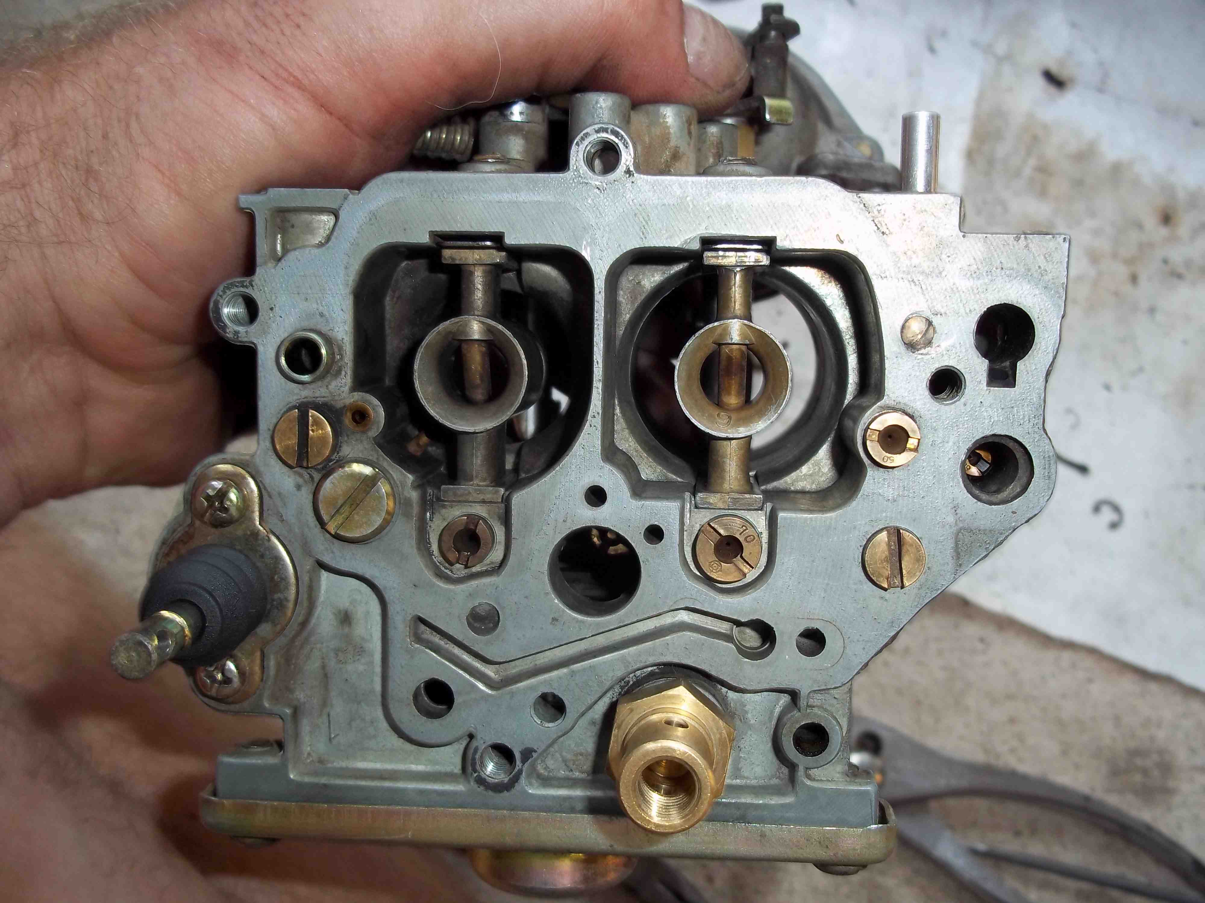

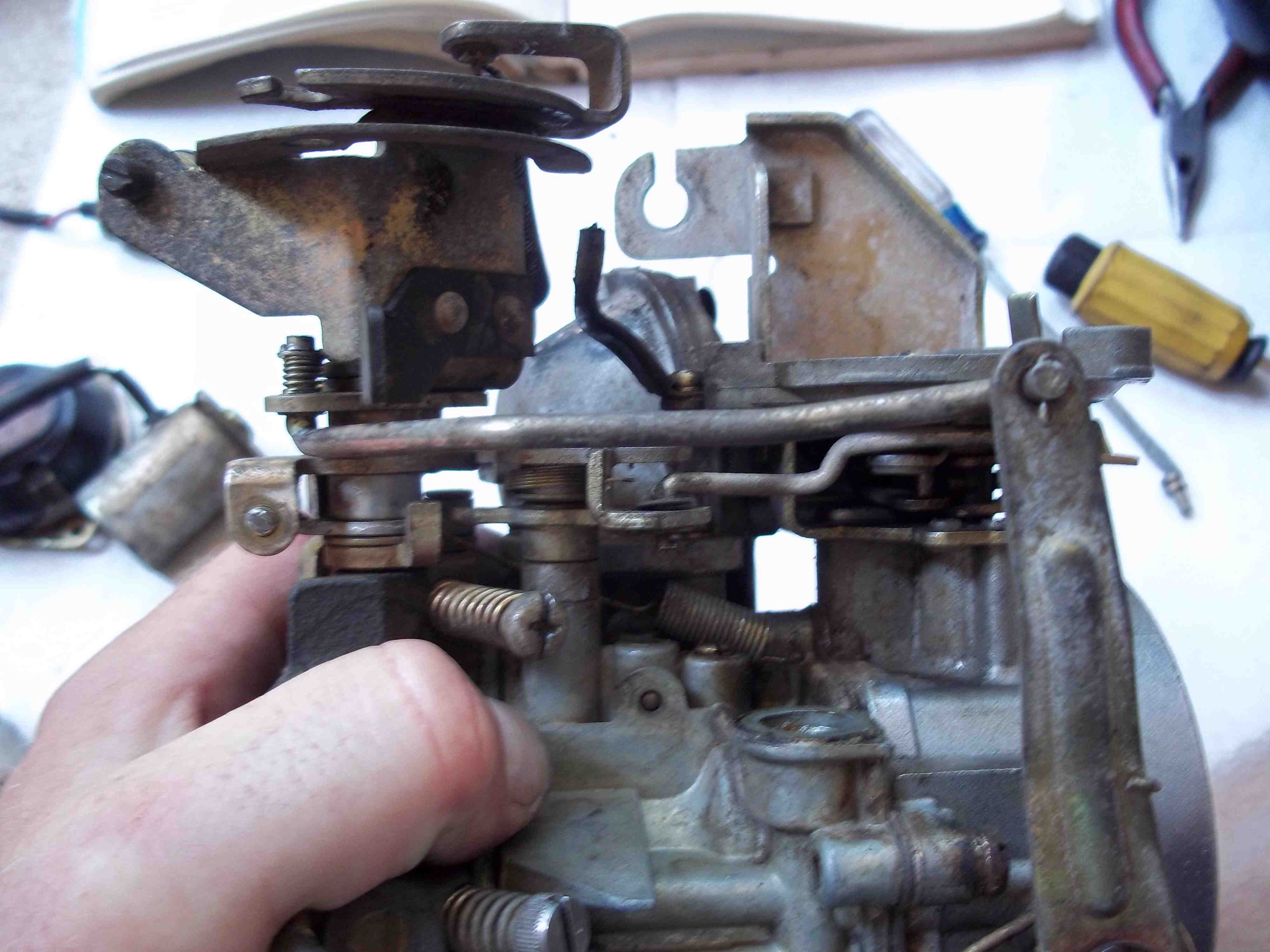

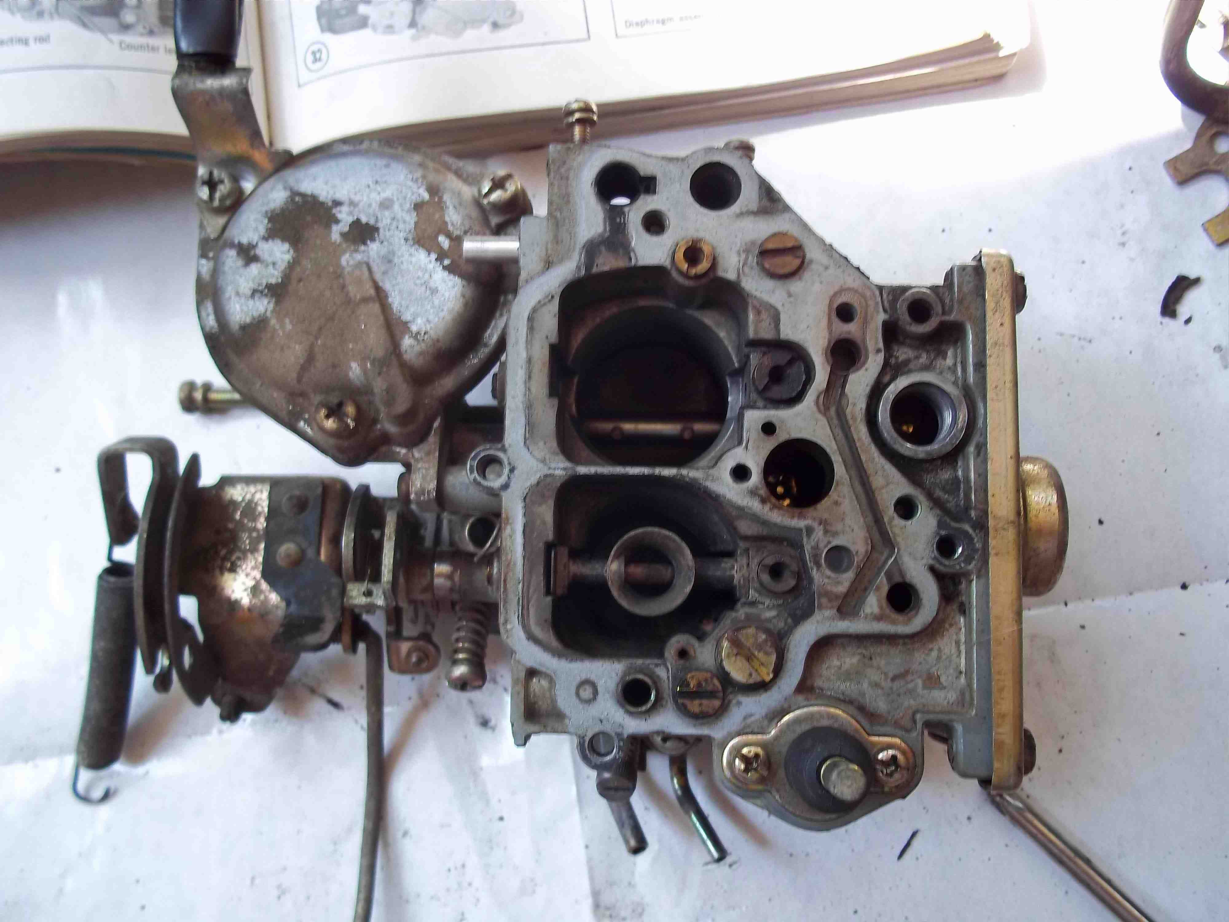

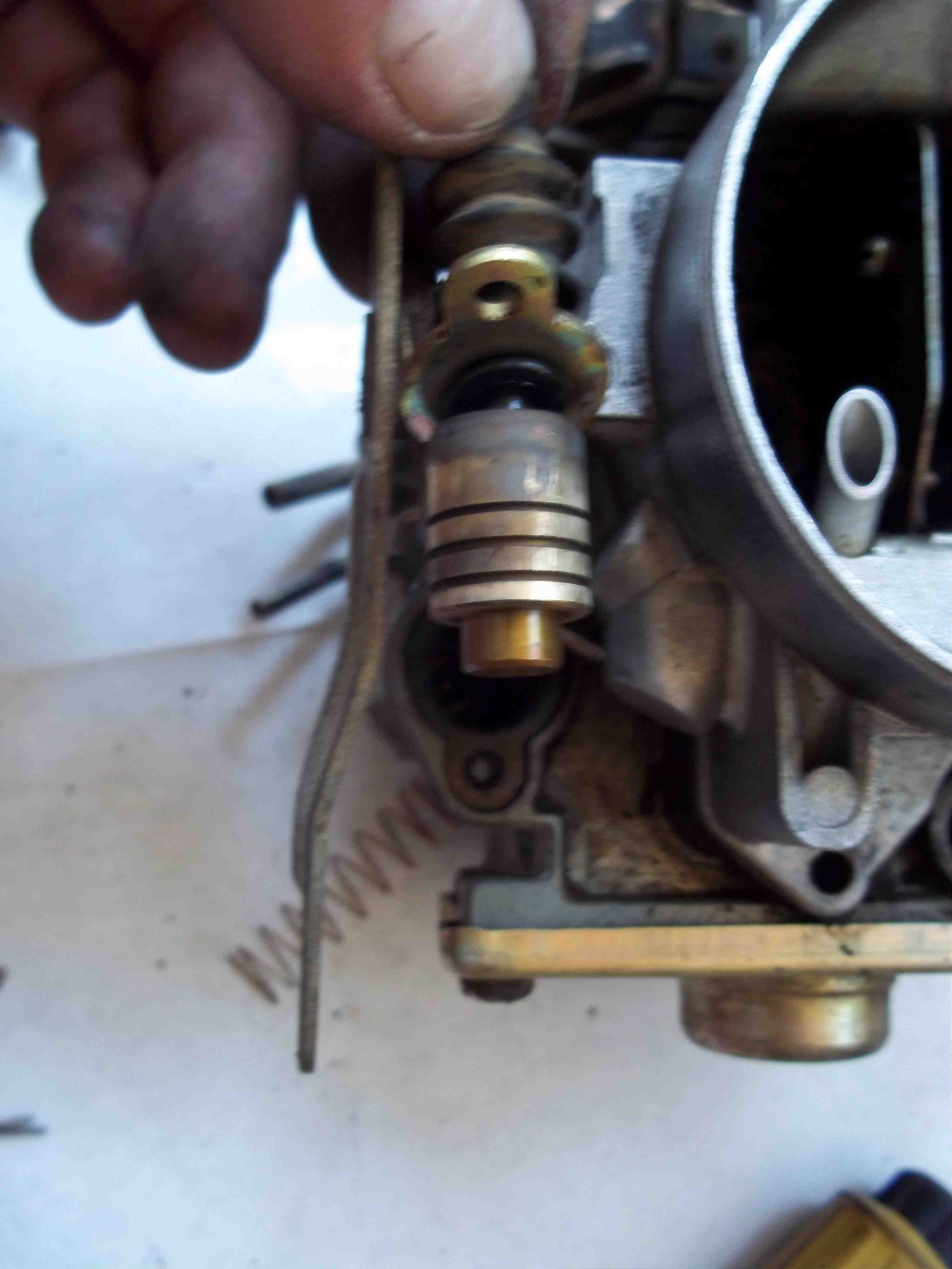

takin' her apart:
File comment: accelerator pump

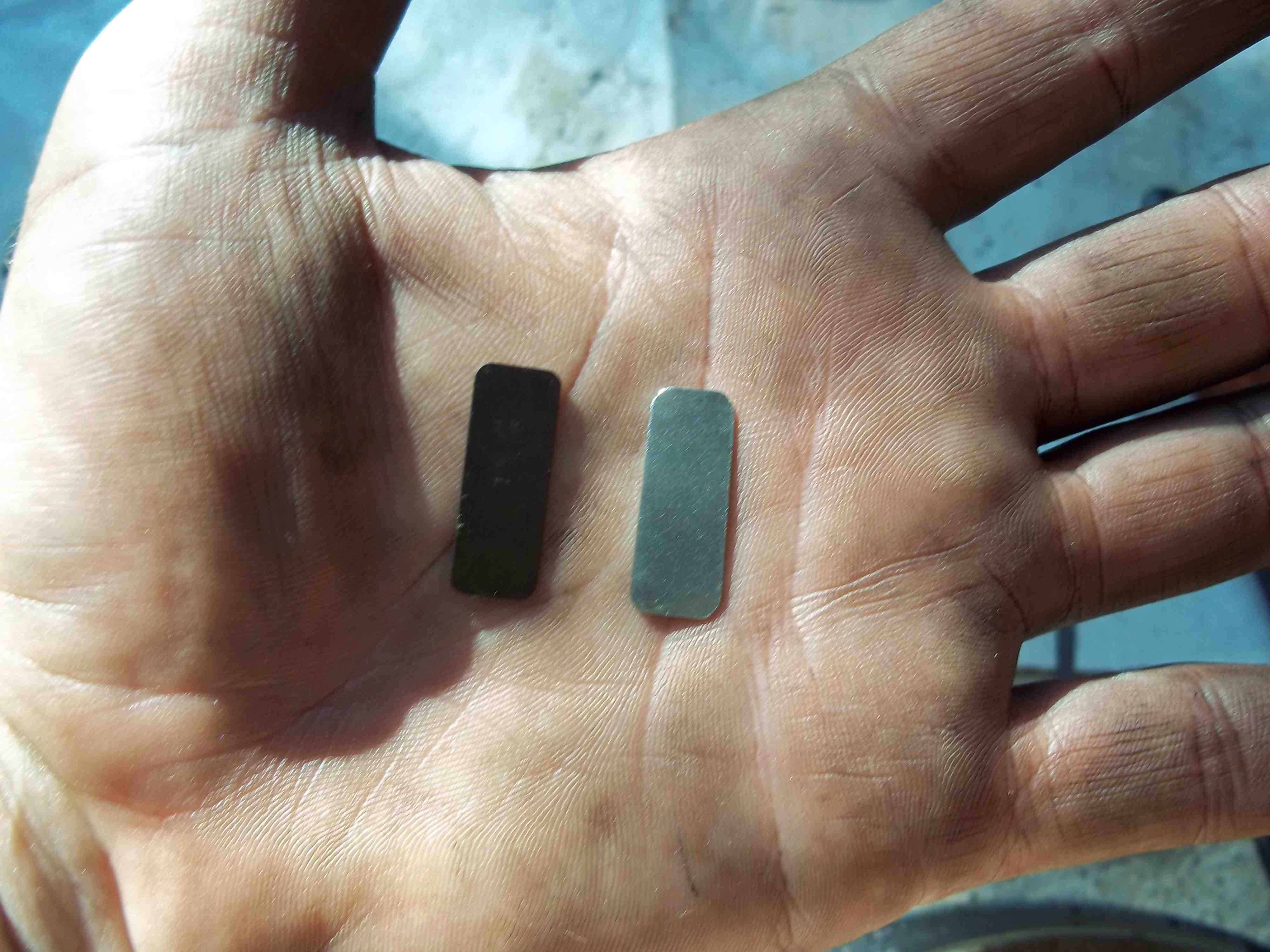

made a shim to replace missing one:
File comment: I noticed that a shim was missing from the behind one of the jets, the jet was totally loose... I created a new one (on right)
File comment: shims in place behind jets and secured with set screw

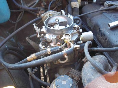

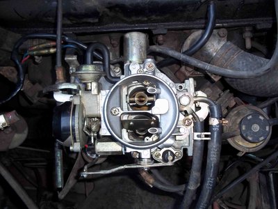

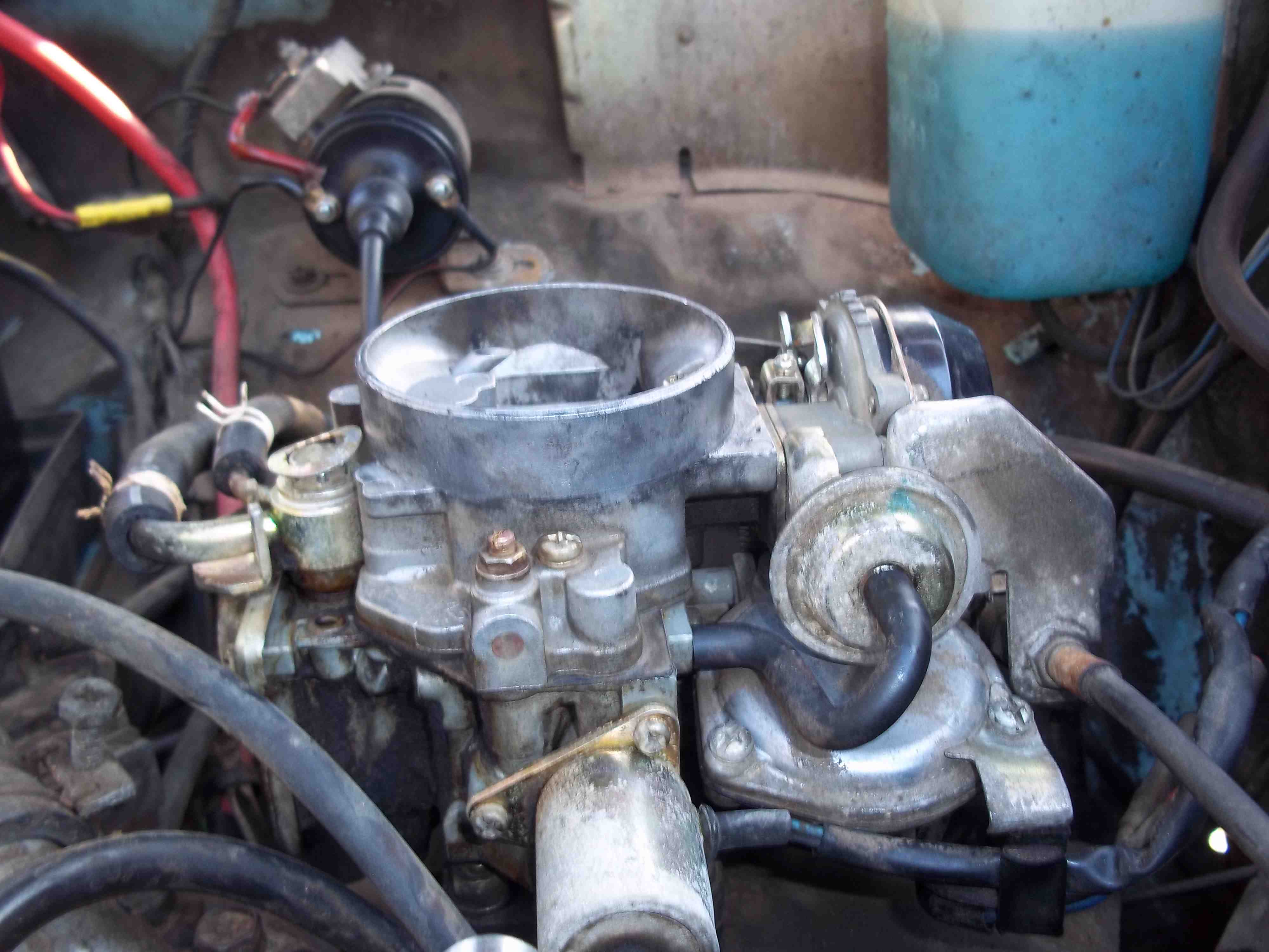

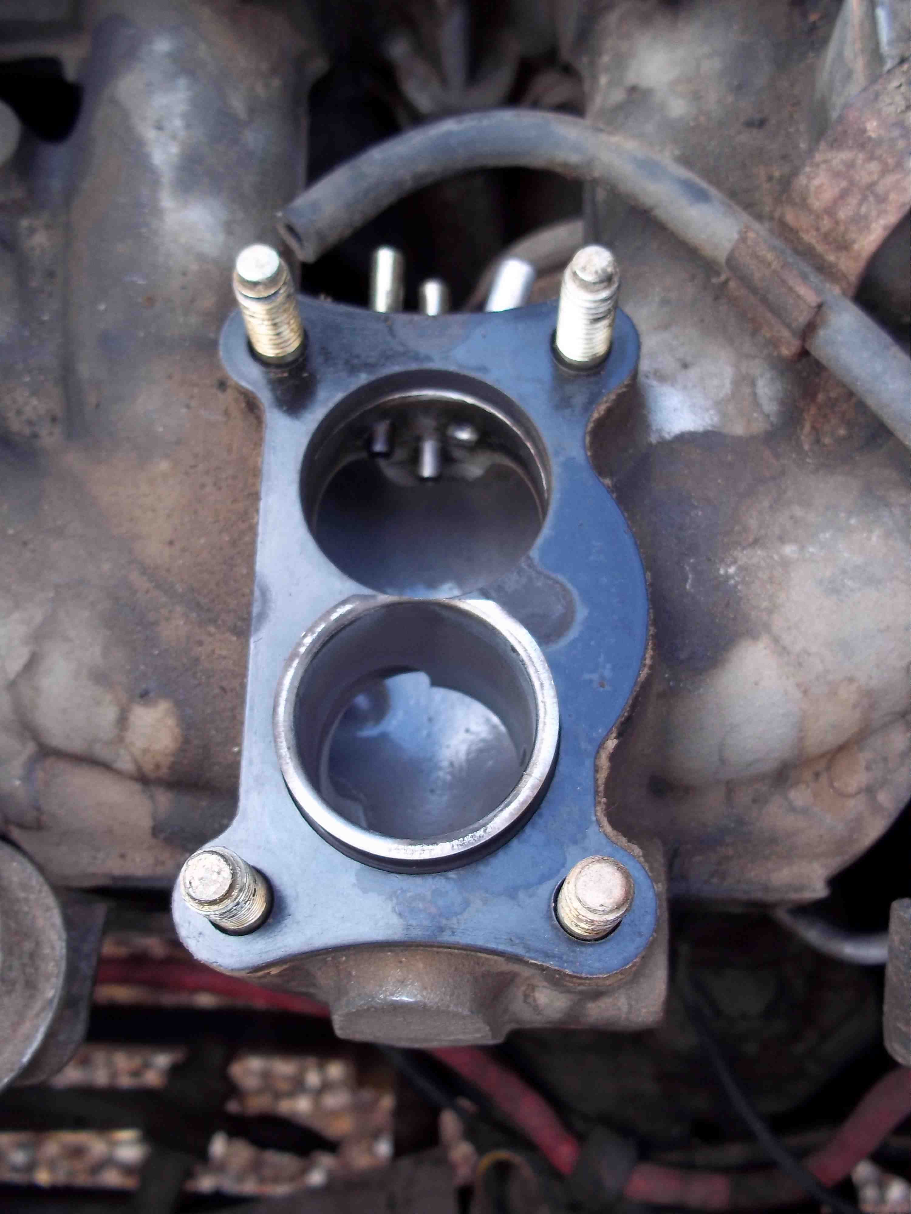

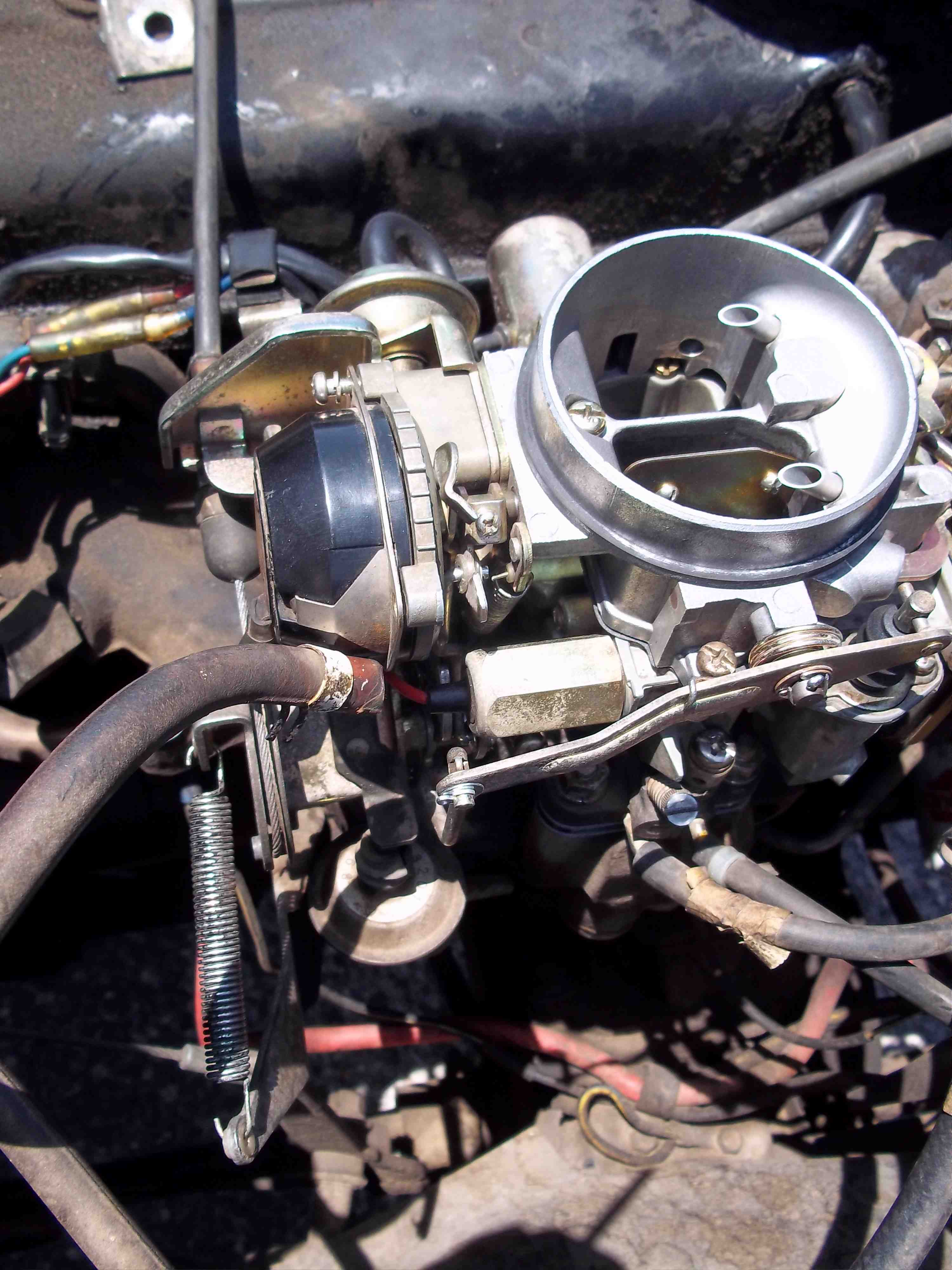

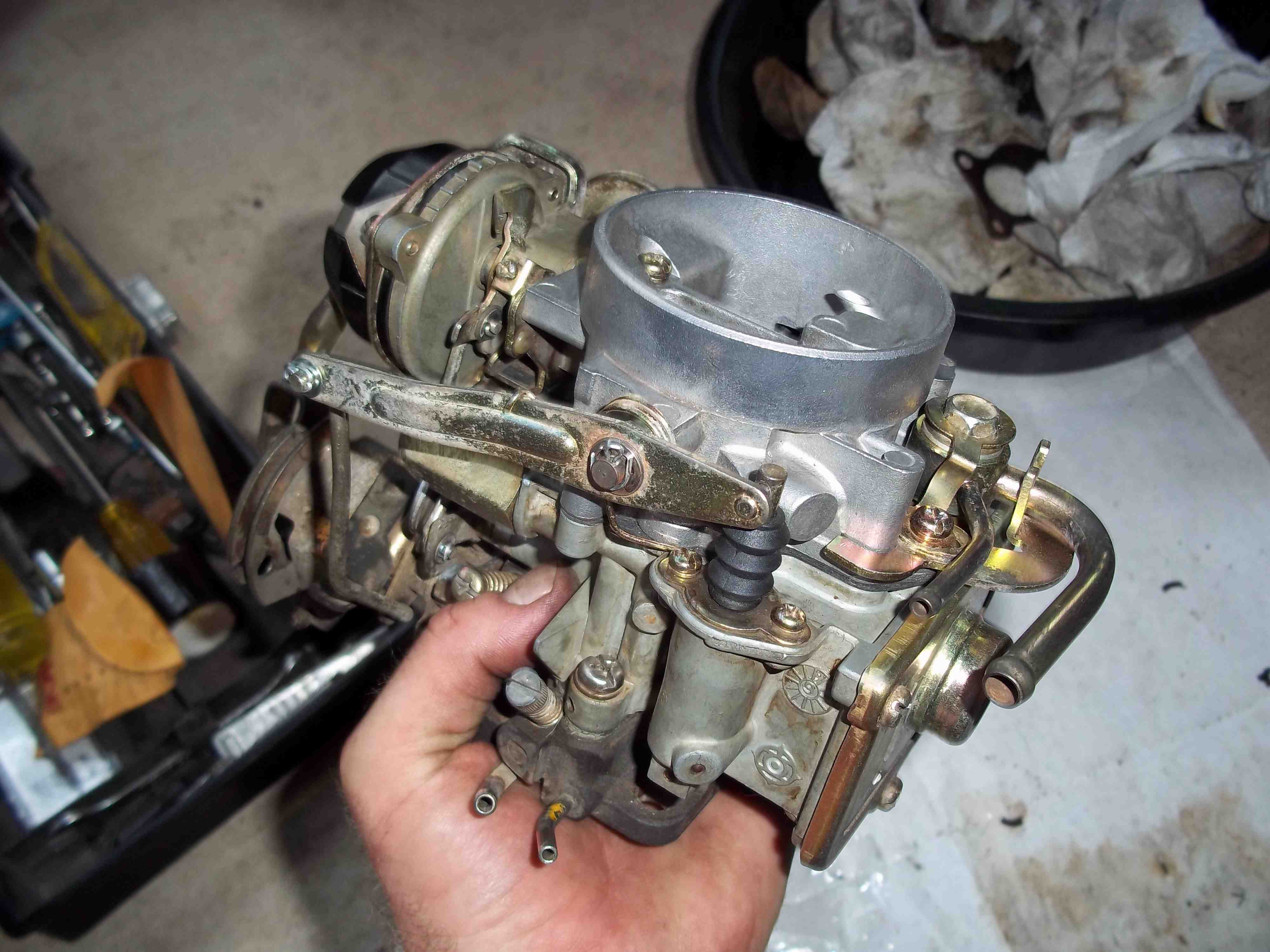

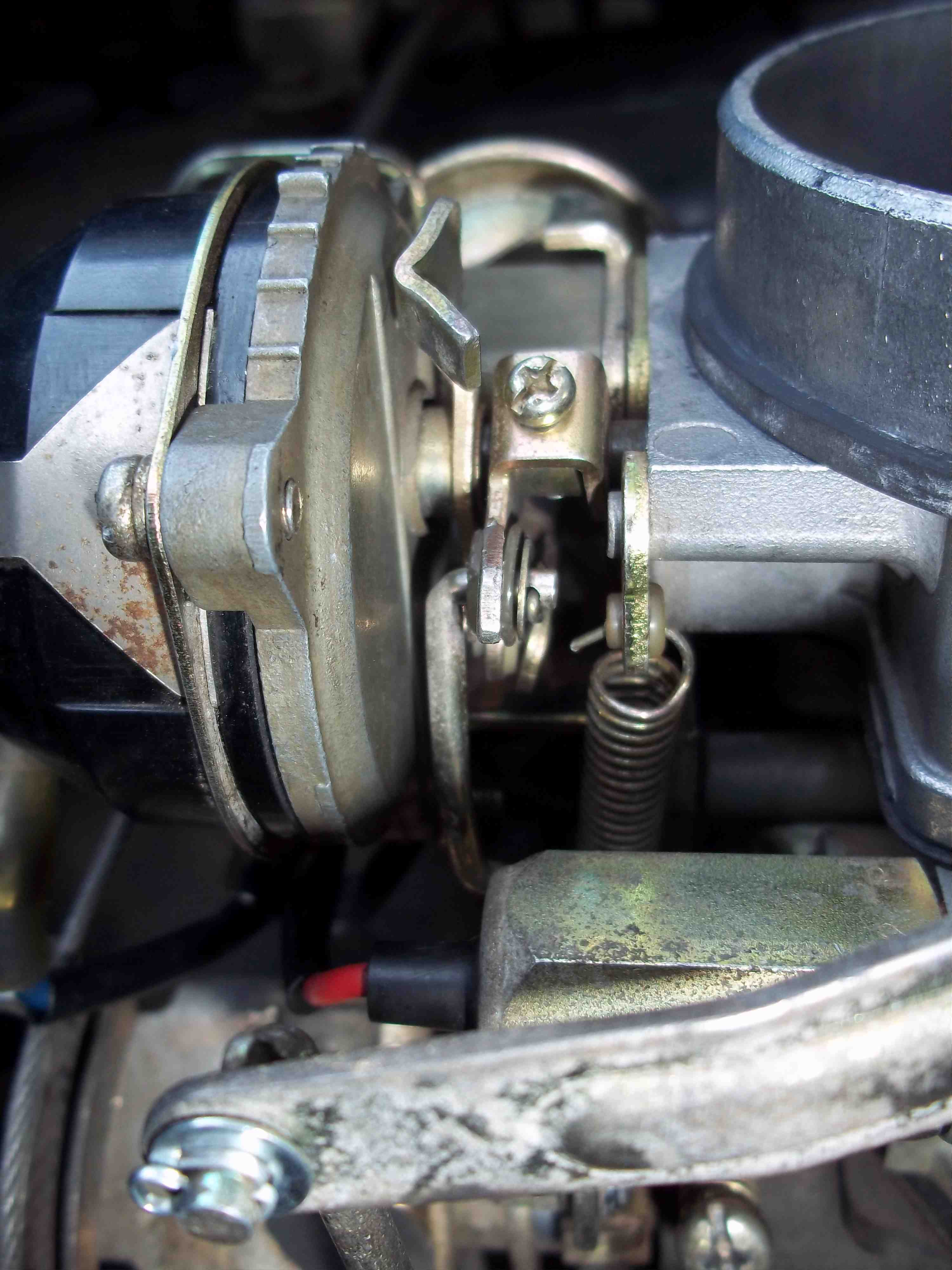

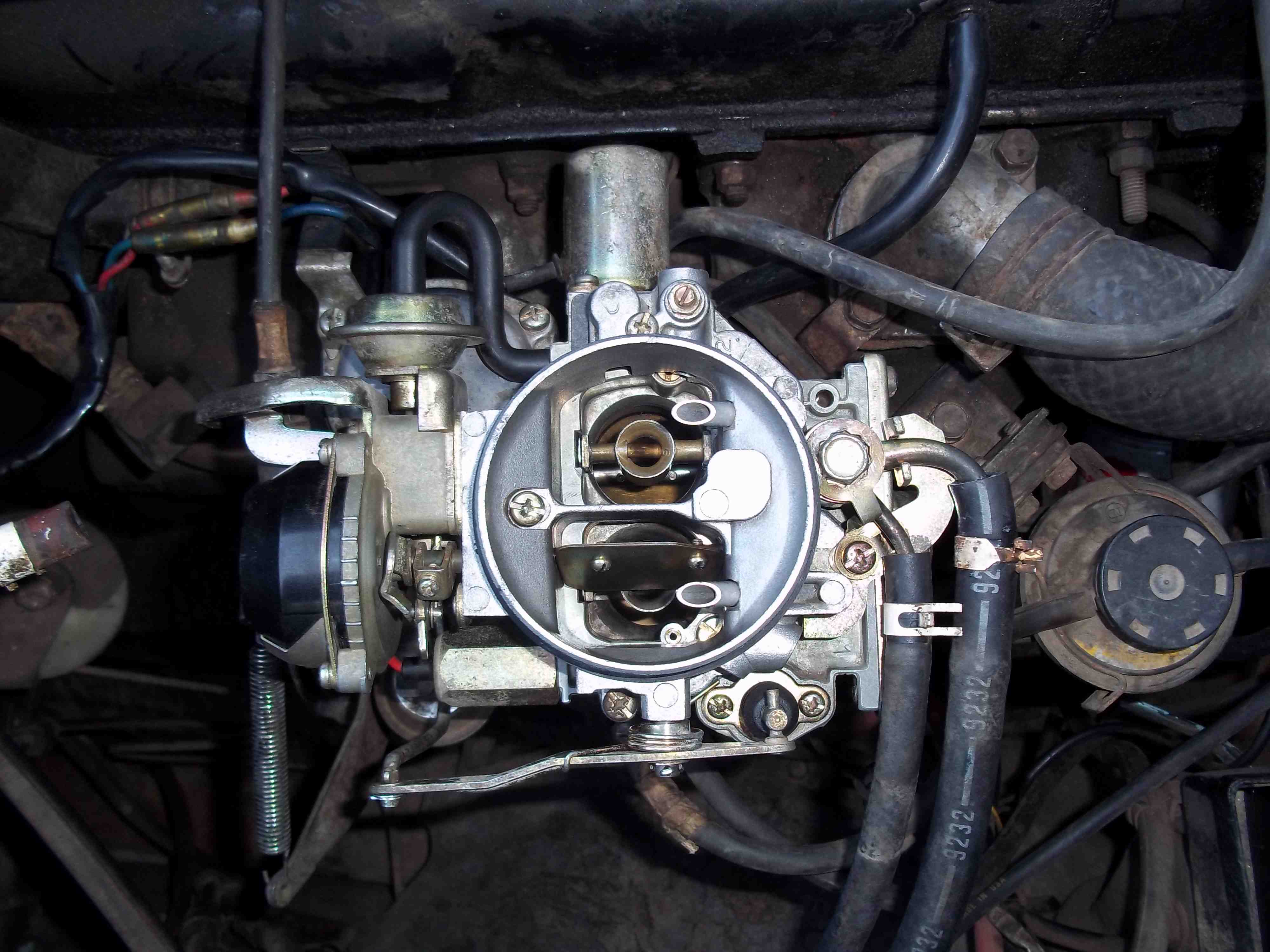

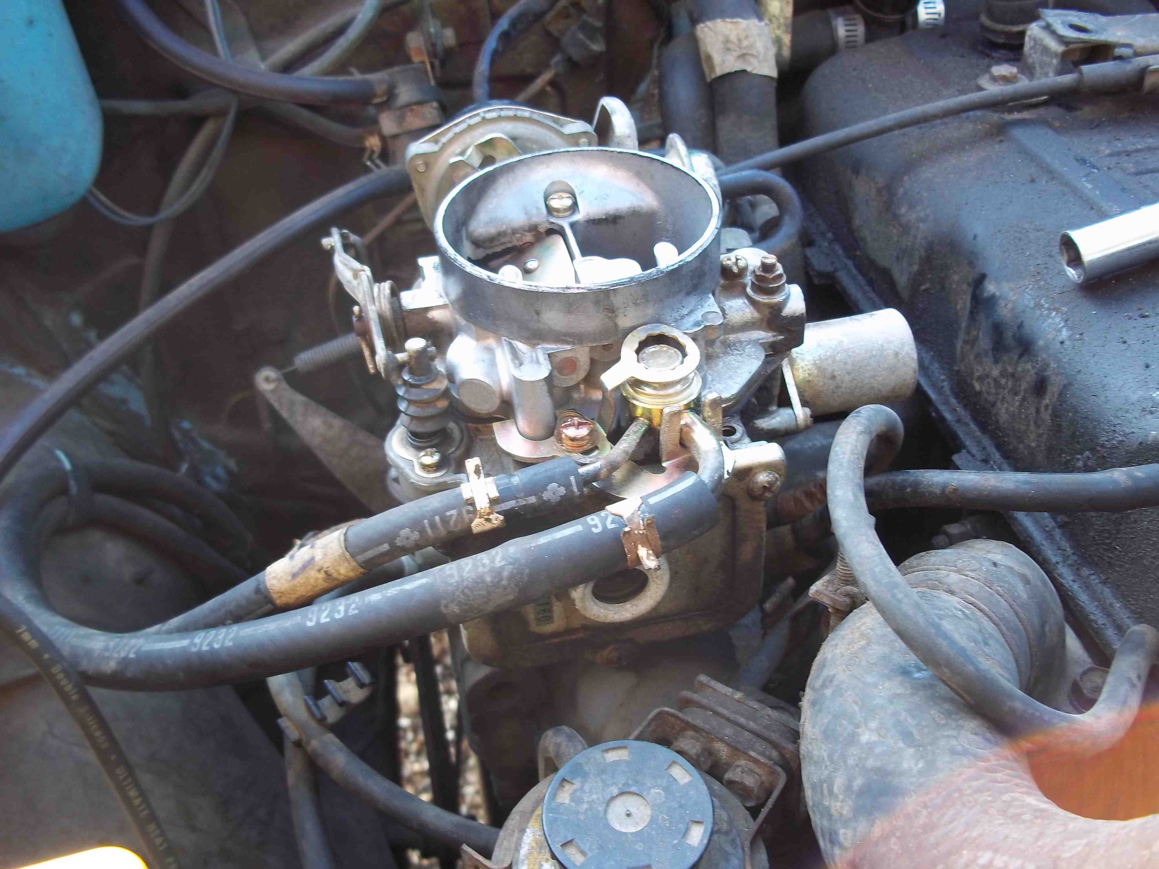

installed the rebuilt carb!!!!

some close ups:
PostPosted: Sat Jun 25, 2011 2:58 pm
Joined: Sun Jan 29, 2006 9:11 pm
Posts: 148
Location: Tucson AZ
last but not least, a couple more close ups... thanks again all!!!!!
