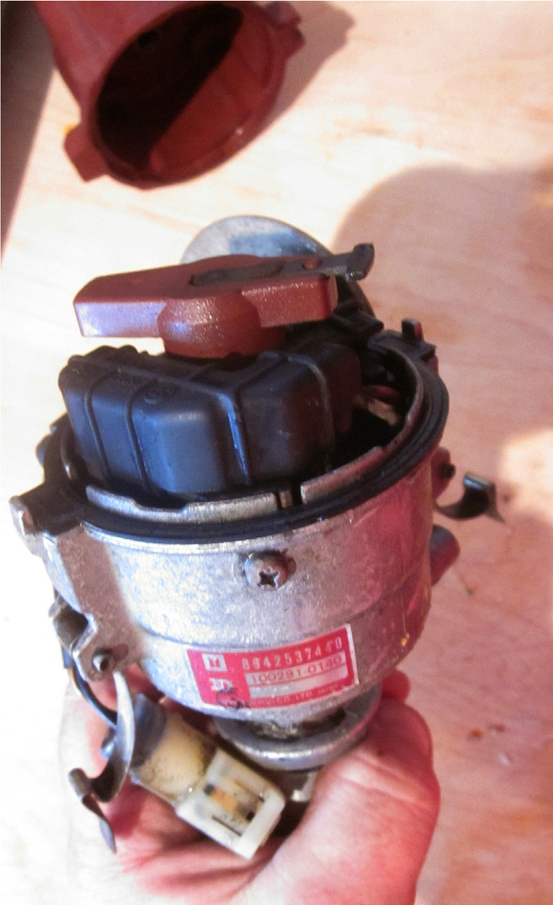

I bought this distributor represented as a 1983-1987 Isuzu PUP 1.9 engine electronic distributor. Is this the right one to convert my Luv to electronic ignition? If so how do I hook up the wires?

PostPosted: Thu Apr 28, 2011 5:47 am
Joined: Tue Jan 19, 2010 6:55 pm
Posts: 337
Location: Webb City MO
exactly what I have... your good to go

Ok cool thank you, on the plug/connector did you cut it off to wire it up with the two individual wires or is there a mating connector that you used?

When I bought mine off ebay it actually had the other end to it so I wired one hot wire and used the old ground wire

There are two types...an earlier one with the ignition module mounted externally on the outside of the coil, and a later one that has the module mounted inside the distributor.
The internally mounted one is the best - but both will work.
