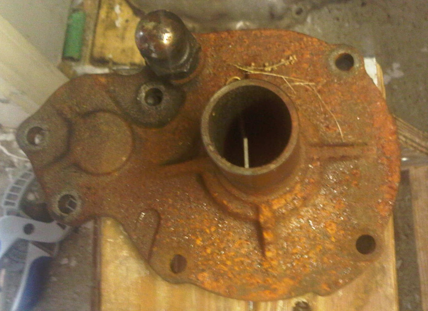

That's the only way I know to tell. Here's what you're looking for, inside the bell housing. This holds the main bearing and countershaft bearing in place. You can count six bolt holes around the circumference. Some 4wd 4-speeds used six, and some used only four. If you count six, then your front case half will bolt up to an MSG-5 transmission from any Isuzu 2.2 diesel or 2.3 gasser, as well as some Impulse transmissions.
File comment: Six bolt holes. Count 'em.

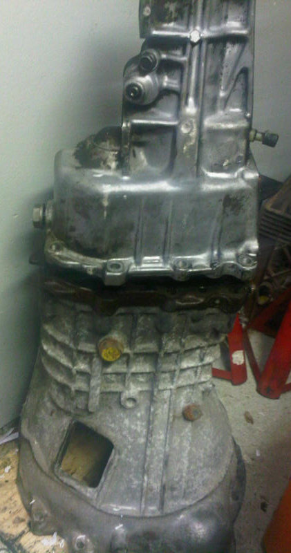

Here's my old transmission sitting on the front case of an Impulse transmission. On top is the rear case, and the dark plate in the middle--it's got all the gears and shafts attached.
