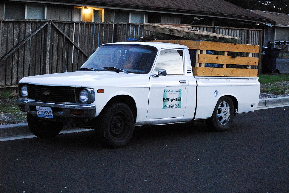

Actually at the moment I don't have a bumper,, I use the LUV for my Lawn company, and getting a little tired of playing musical lawn equipment. I am however wanting to transport a 5x8 enclosed trailer that I currently own that is being unused. I completely understand that it is a Light Utility Vehicle, I just need it to work for 2 months or so until I can get a NPR dumper, which I'll use the same trailer with.
 Post subject: Re: Chevy luv tow hitch
PostPosted: Fri Jun 11, 2010 12:27 am
Joined: Sat Oct 25, 2008 6:52 pm
Posts: 4
2500lbs in back
