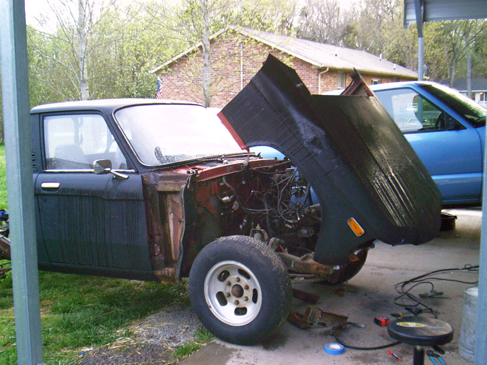

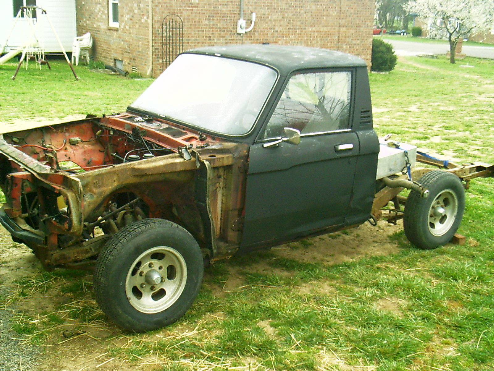

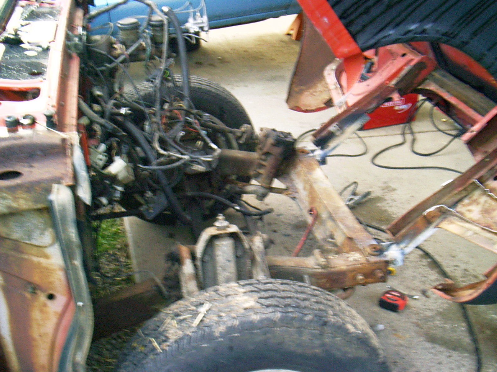

about halfway done got it tilting just got to put in supports and frame it up.

Wow, that was really fast! Looks great, did you weld the fenders to core support?
Would you post some additional pics if you get time? I'd really like to see it with the hood open from the driver's seat. I'm curious what you did to remove the inner fenders also, especially the upper support section of the inner fenders. What did you use to cut out the fenderwells? How did you weld the hood to the fenders, what did you use to fill the gap? Would you post more photos of the hinge points? Are you going to use liftgate struts for the tilt? What have you decided to use for a latch? Are you still reading this? LOL, ok enough questions...
I've read the articles on this too, but I just don't have the skill or confidence to try it myself. I think Luvprojects has got the equipment to help make it happen for me, but I'd like to pick your brain as it comes together. For me, I think the cutting is the tricky part...
Thanks for posting this, I'm really excited to see one that wasn't done in 1974... :egeek

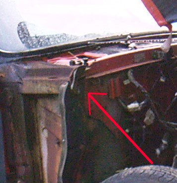

File comment: Would you post photos of the cuts on both sides, here?

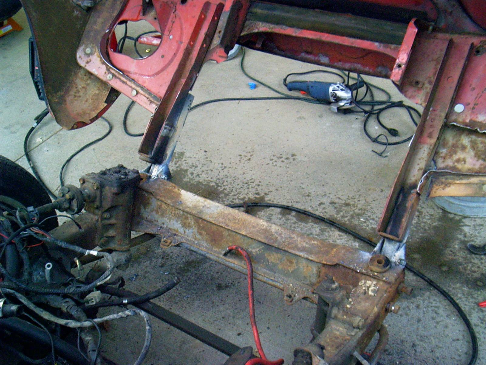

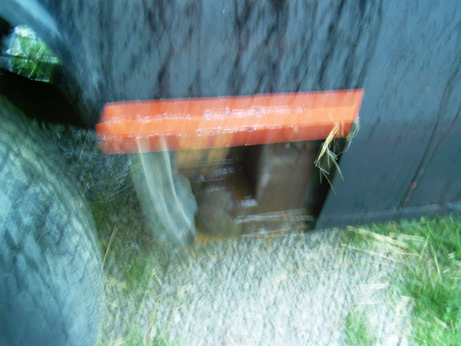

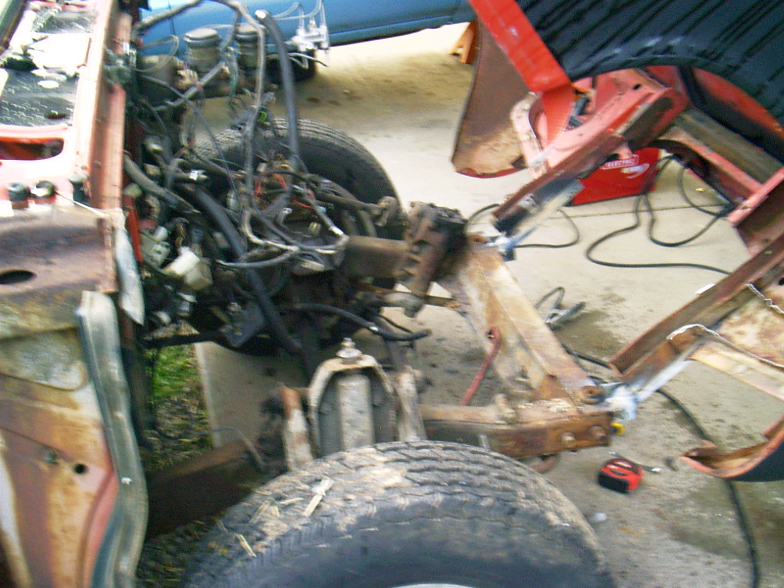

ok lots of questions lol
This is tricky for me to as im 20 but im ok at fabrication of about anything.. First i took off fenders hood and everything off fenderwells lights grille bumper etc.
Second i took the two bolts in front that hold core support down.
Third i took a sawsall with 6 inck blade and cut as close as posible to firewall starting in front of that metal lip that fender touches..
fourth took everything off and bolted fenders and hood back on. I lined bodylines up by eye.lol and tacked hood to fenders.
Fifth i cut where fenders bolt up all the way to core support then towards bottom so basically nothing but fenders hanging.
oh before i put fenders back on front end i cut them at body line.
six i sat everything back on truck to line everything up and it was good so i slid bolts back through front end so it didnt move.
seven i cut support out near bottom of core support and grided smooth. i took a piece of ten inch long sqare tubing and 2x2 square tabs . welded tabs to frame and tubing to core support. drilled and put bolts in.
eight took the two bolts back out of core support to test it out.
worked good even latches on hood still. I am going to use a gas shock so when i pull hood latch it just pops open. It is flemsy for now on fenders but im going to frame it up as lightly as possible. one note is to be careful when welding the hinge parts make sure you keep it lined up good. I had my buddy help me pick it up and down but i got it done in two afternoons. you really have to hack the front end up so dont attempt unless you really want to cut the heck out of everything!lol oh gap is not filled up on hood tacked a bolt underneath hood to fenders to keep bodylines straight

i think the pics are too big not to good either ill try to get more tom.
6.0l ls1 swap th350
PostPosted: Sun Apr 13, 2008 10:27 pm
Posts: 259
Location: Murfreesboro, TN
agian

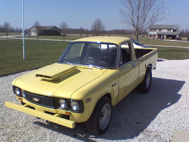

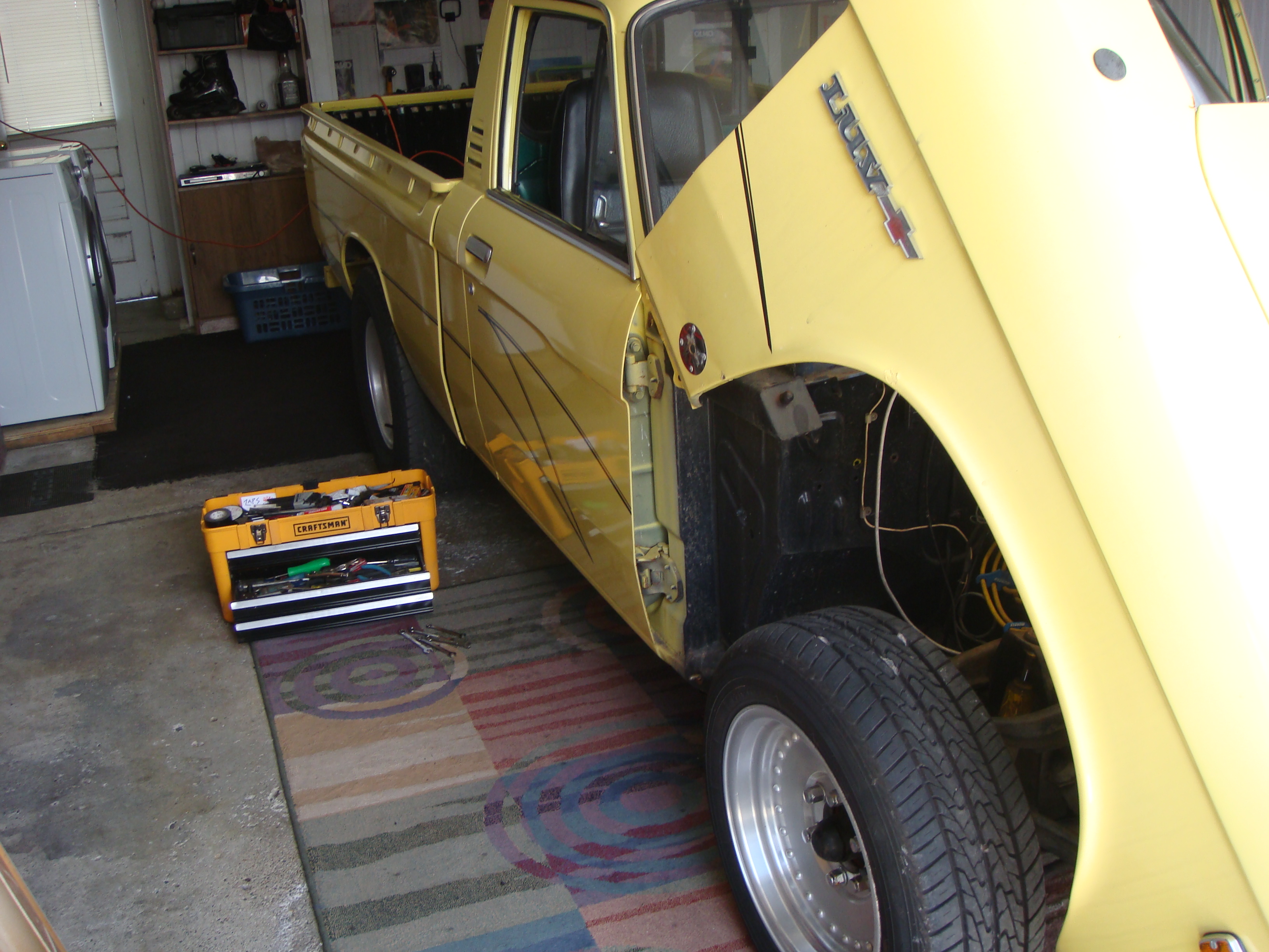

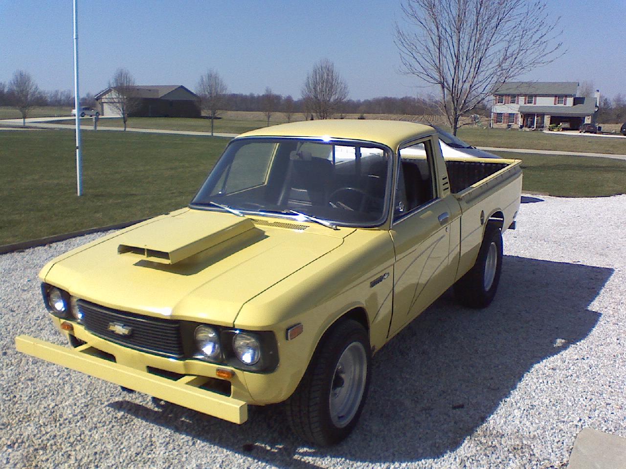

I have a tilt doghouse on my '74 LUV Im not sure I like it but it is kinda cool!!!

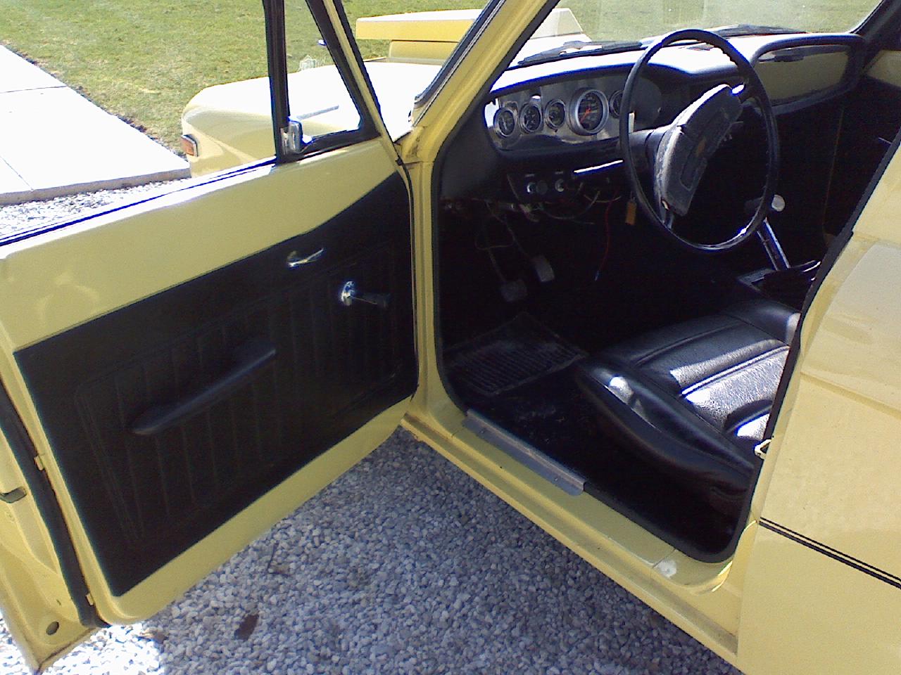

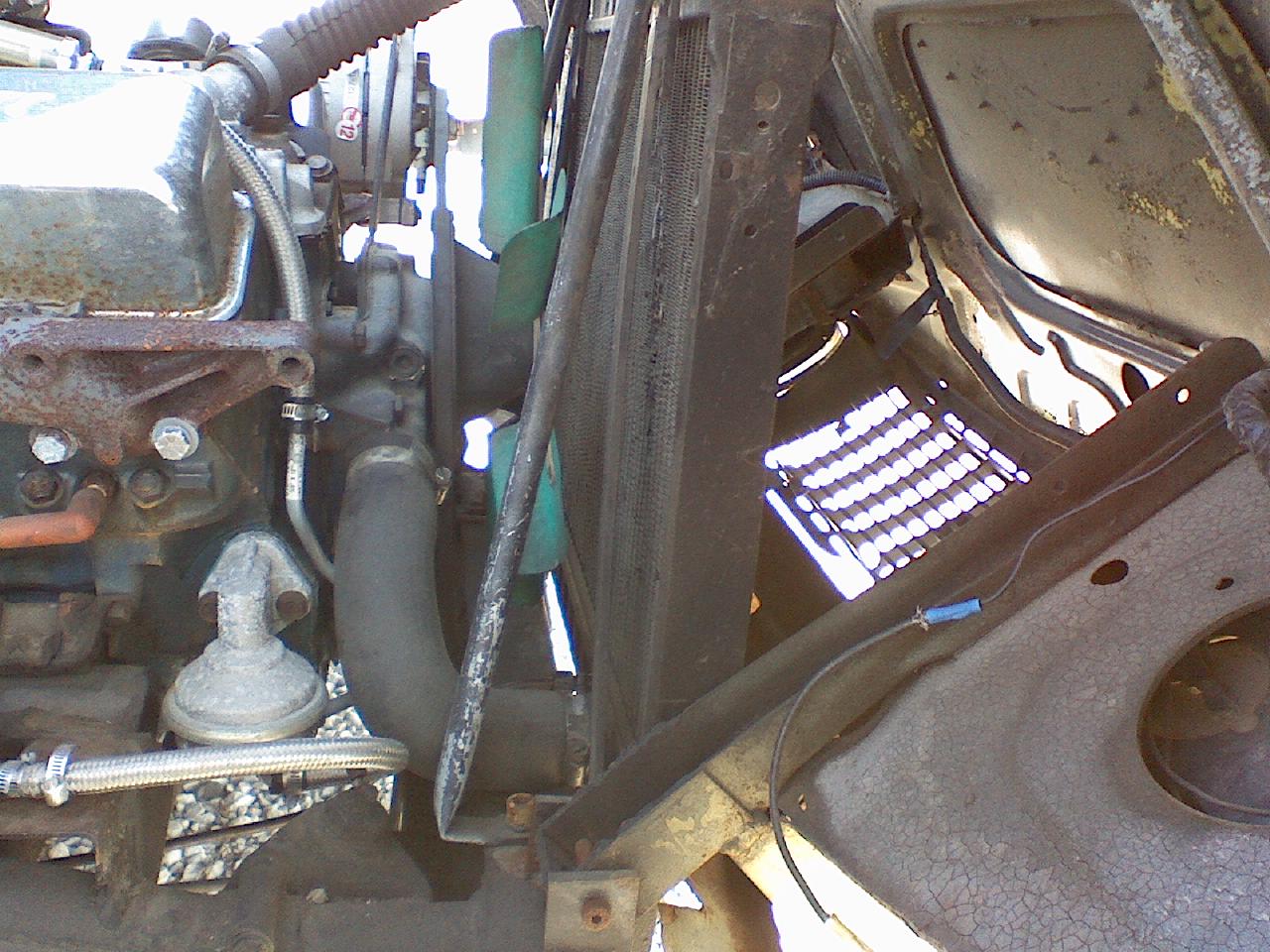

I will take some better pics of the doghouse, my truck is a "work in progress" so please no jokes about it lol. I will take them of the hinge point, inner fender and bracing. It aint a show truck yet but give it time. Oh and remember I bought this truck this way so I have no idea what all was done to do it, I will let the pics tell you the story and I will try to answer any questions I can. MIKE
PostPosted: Wed Apr 16, 2008 8:30 pm
Joined: Mon Apr 14, 2008 7:25 pm
Posts: 22
Location: Westfield,IN

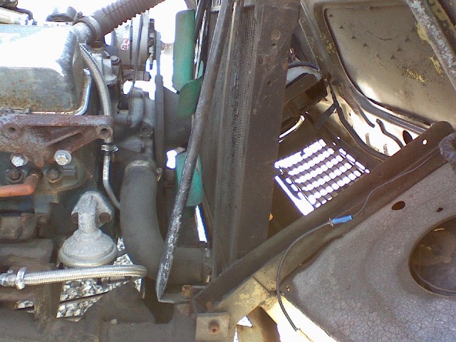

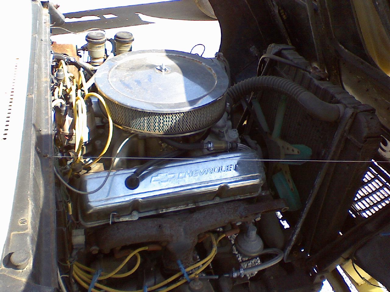

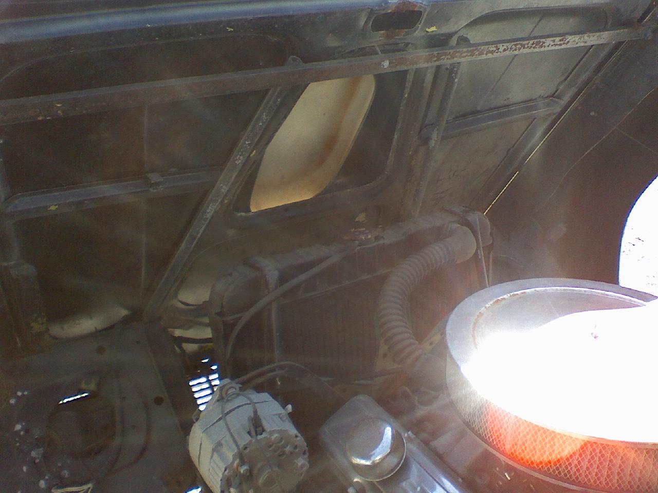

Let me know if these pics help!!! The engine and trans are coming out soon. Im installing a 383 w/ 2 4bbls. and changing the paint to black and having it backhalved with a Ford 9" and 33x22.5 Sportsmans if all goes well.
File comment: Engine bay
File comment: Bracing for the hood
File comment: Hinge point of doghouse

More pics of my junk!!!!
File comment: Inside
File comment: This is what it looks like.

wow looks awesome. Nighttrains is different then mine. I did mine like off the forum on here with tabs on the front. looks like the core support legs that originally bolted the front down were chopped. They sit up so it doesnt bind and it can tilt. nice!
