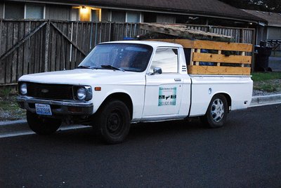

Actually at the moment I don't have a bumper,, I use the LUV for my Lawn company, and getting a little tired of playing musical lawn equipment. I am however wanting to transport a 5x8 enclosed trailer that I currently own that is being unused. I completely understand that it is a Light Utility Vehicle, I just need it to work for 2 months or so until I can get a NPR dumper, which I'll use the same trailer with.

2500lbs in back
