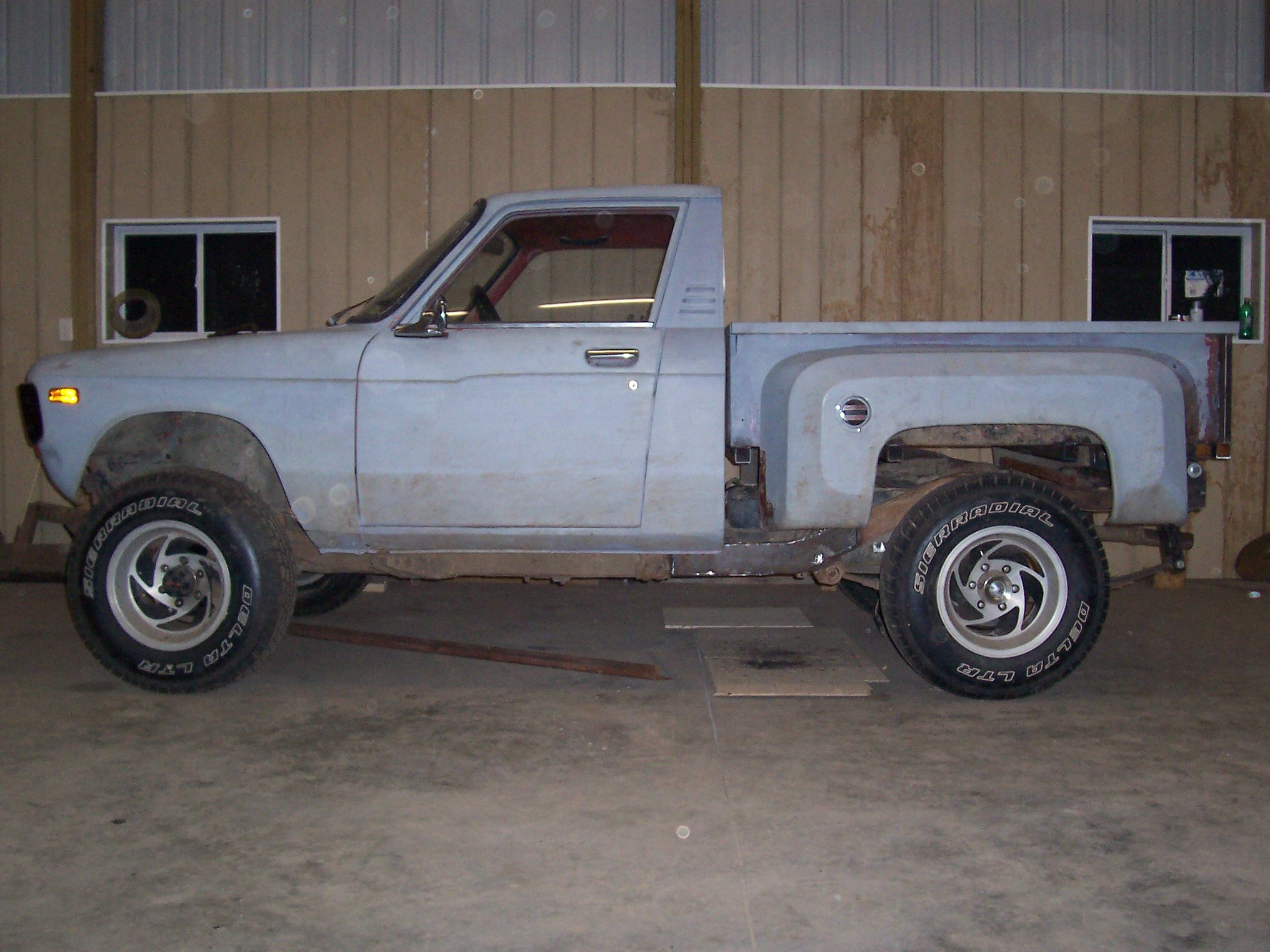

shortened bed about 16 inches. shortened frame about 12 inches

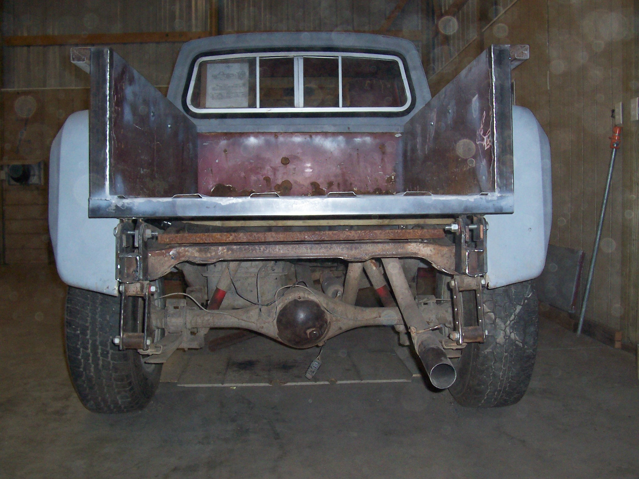

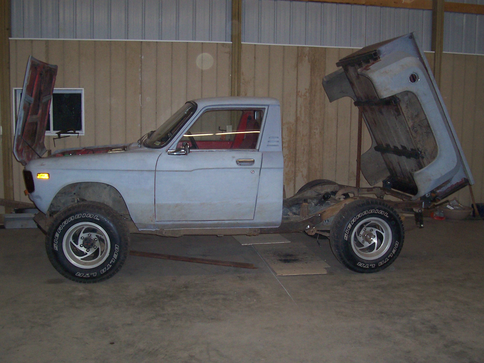

oh yeah it's also a tilt bed dump truck.
