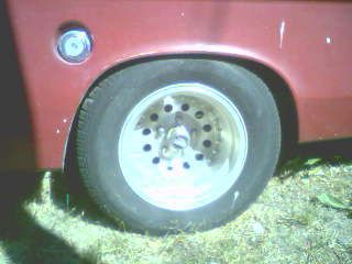

I am trying to figure out what size 15" tire to run on the back of my truck and wanted to ask if a few could post pictures of the rear tires on their Chevy Luv along with the size of the tire so I can make up my mind. I am thinking about a wider tire than the front but not sure. Thanks!

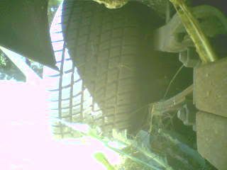

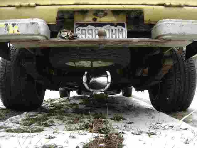

18.50 inch's wide works for me. 15X15 rear rim with 31 X 18.5 X 15 Hoosier tires.
Number two has 245 60 14 tires on 14X8" rims.
If you need more info from me just ask.

165R15 front on 15 x 6
255/60/15 rear on 15 x 8 I have had a 28 x 9 x 15 slick on it .
Factory frame with 9 " ford .
