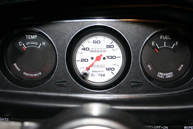

Yea, I was there a short time ago. I decided to order a Lokar speedo cable for the turbo 350 then got an after-market speedometer (Auto Meter) and custom fit it to the cluster.
PostPosted: Fri Sep 15, 2006 8:11 pm
Joined: Sun Aug 21, 2005 10:41 am
Posts: 28
I forgot to mention, after all this work, I do plan on going faster than 80mph :)
