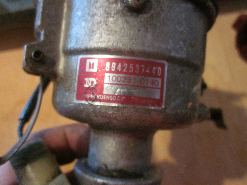

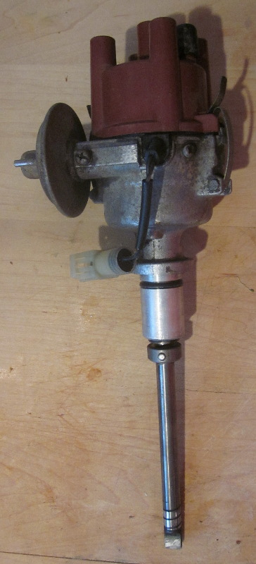

I bought this distributor represented as a 1983-1987 Isuzu PUP 1.9 engine electronic distributor. Is this the right one to convert my Luv to electronic ignition? If so how do I hook up the wires?
Thanks!

PostPosted: Thu Apr 28, 2011 5:47 am
Joined: Tue Jan 19, 2010 6:55 pm
Posts: 337
Location: Webb City MO
exactly what I have... your good to go
