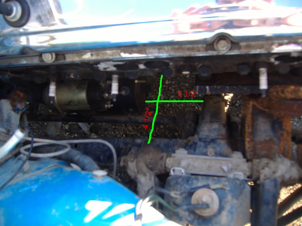

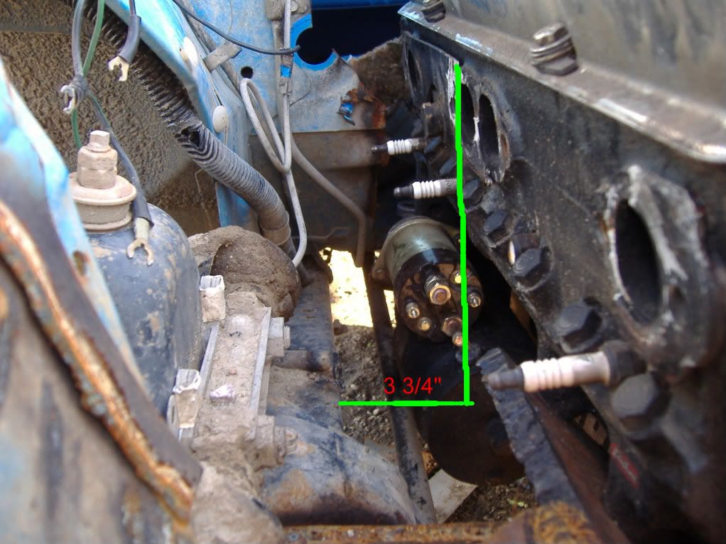

My brother had a pair of hugger headers and so far they didn't fit.... at least with the plugs on. But he sold them to someone and I'm looking for something to use for my exhaust. I cam across some RAM exhaust manifolds and I was wondering if anyone had any experience with them. Does anybody have some good detailed pictures of any that show all sides of them? So far I took a few measurements of my truck and this is what came out...
This measurement is from the frame and it goes out until where the exhaust holes go straight down. I couldn't make it any better but I hope you can see what I mean.
These ones are pretty much self explanatory. The horizontal one is measuring from the starter to the crossmember and the vertical one is measuring from my tire suspension thingy to the bolts by the exhaust.
Sorry, but the angles on all those measurements are at 90 degrees and going straight across but my free-handing prevented me from drawing so.

In checking out the Speedway header-exhaust manifolds? I don't think you will be happy with them, it appears you will have some interference from the sides. Like you have been already told, there are several designs of Ram's Horn manifolds, 2" short outlet, 2 1/2" short outlet from Corvettes, 45 degree kickback longer type, I have used the 2" short early Chevy type on many conversions successfully, just have to make a rather short bend in the header connection pipe.
I make my own motor mounts and in my present 78 and 81 Luvs I am able to use an HEI distributor along with an aluminum short water pump, and it is was not neccessary to cut the firewal in any way!
Some people on this site have used the newer "shorty headers", you might do some research on the site and find some good pictures of these.
