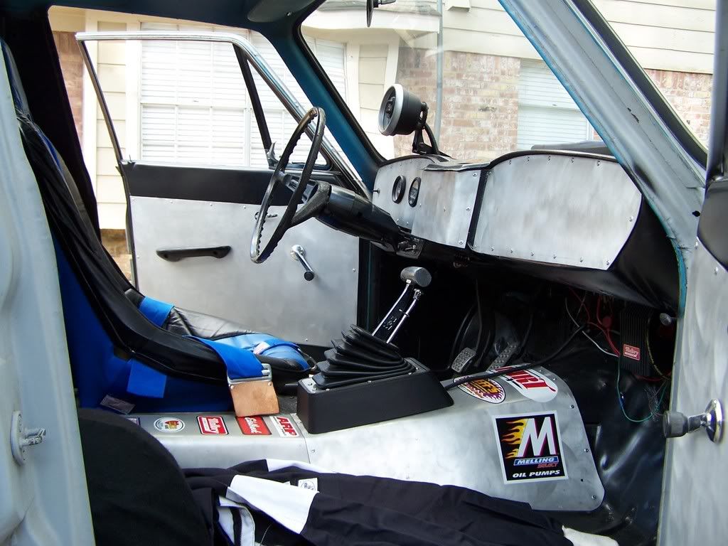

Has anyone installed a Hurst Pro matic 2 or something close? The one I have is a pro matic and it was used and I do not have any instructions on how to install. Mainly on how to mount it to the floor board securly , and all I have is just the shifter and the cable, no brackets.
Any advice would be great.

bama i just mounted mine to the trans tunnel, you may have to put some spacers to level it out and you can mount it a little angled if needed. make sure to put a thick washer on the underside for more stiffness.
PostPosted: Tue Jun 10, 2008 8:19 am
Posts: 727
Location: SPRING,TX
here's a picture.

Thanks for the advice and pictures. Would you recommend installing before the engine and trans go in so the washers can be installed underneath
PostPosted: Tue Jun 10, 2008 9:07 pm
Well mine is a B&M but looks very similar, I had to massage the tunnel to match the mounts on the shifter, then trim the plastic base to match the contours, was pretty simple. Definatly install it before you have the tranny in, a lot easy to bolt down that way. Like CT mentioned. use some large washers to make it more stable. Mine vibrates side to side a little at idle.
