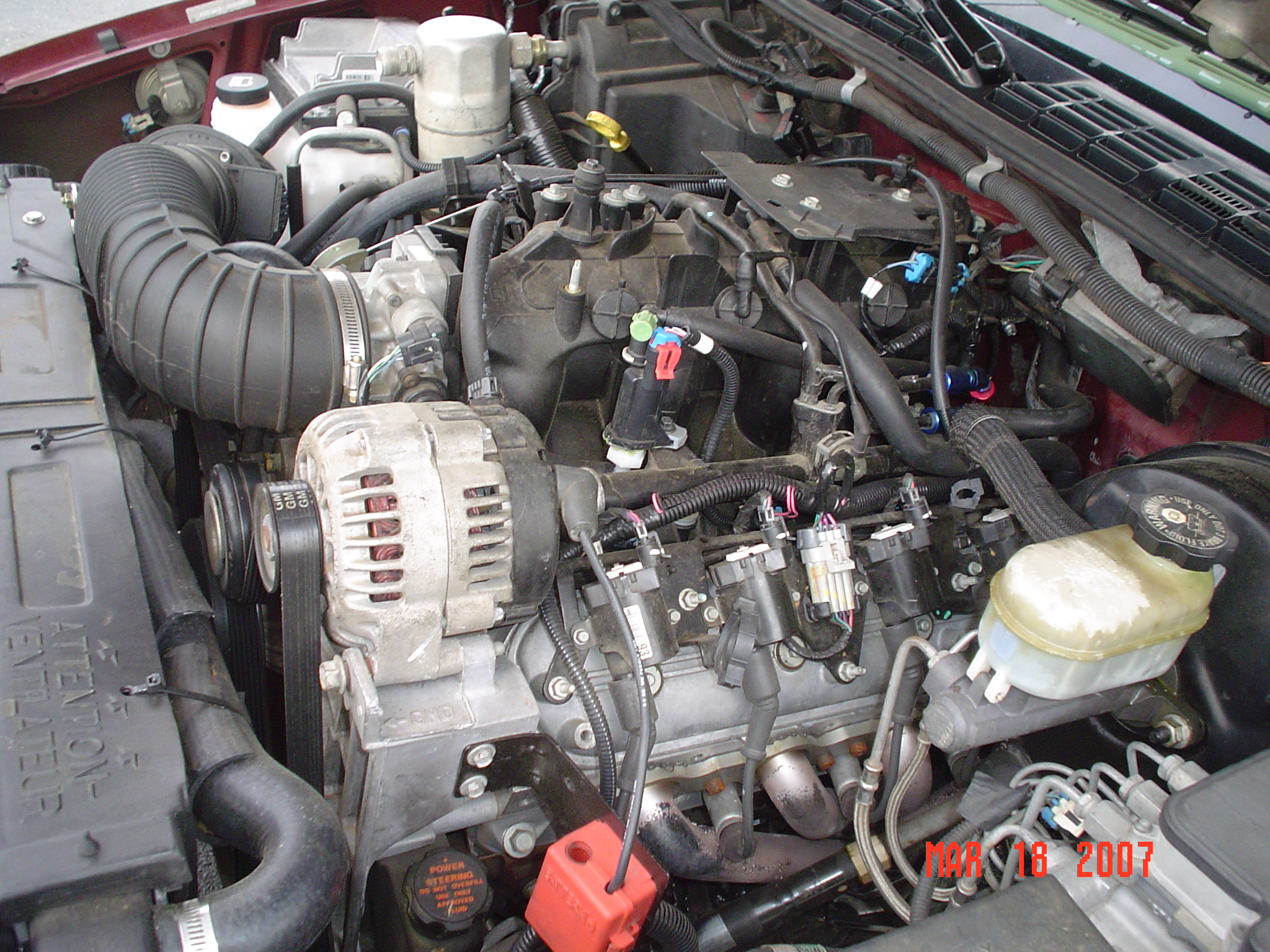

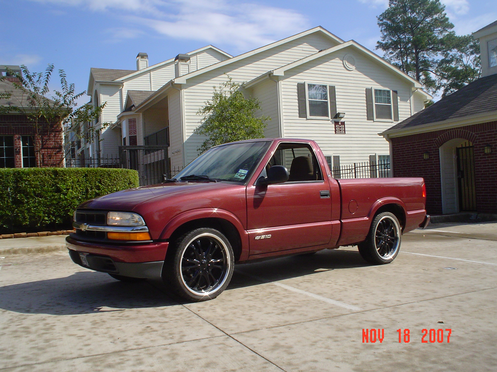

good choice, I love mine in my s10!! heres a few pics for ya.
 Post subject: Re: lt1 6 speed
PostPosted: Thu Apr 17, 2008 1:00 pm
Posts: 259
Location: Murfreesboro, TN
wow nice. auto? Did you get your motor with a harness and computer then have it modified or did you by a complete harness. Also do you run all the emisions stuff and how about top speed limiter is yours modified? whats yours out of looks to be out of a truck with the tall intake
6.0l ls1 swap th350
PostPosted: Thu Apr 17, 2008 4:51 pm
Joined: Fri Apr 11, 2008 9:29 pm
Posts: 59
its out of a 2002 suburban, I looked on craigslist for the motor, no harness, I just bought one from jared, all the emissions is there, it passed emissions testing in Texas, it was a 4cyl 5spd, but I converted to auto. all the gauges work, a/c works ( although not hooked up in the pic, but is now) it is a very fun truck, and for sale :ebiggrin
oh yea, speed limiter is set at 200 via HPTuners, I've been learning on this truck..
