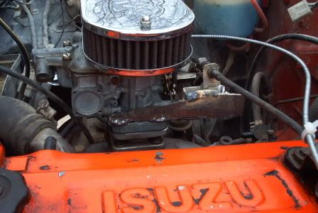

ok i got it on but my throttle cable is real sloppy, how do i adjust it to tighten it up?

PostPosted: Fri Mar 09, 2007 9:33 pm
need to make a bracket like this

Location: Shreveport, La
i see can i pick one up at a auto part store or does any other vehicle have one that will fit?
PostPosted: Fri Mar 09, 2007 10:55 pm
you can buy them here other wise the stores wont carry them unless you have a speed shop around and they might
PostPosted: Sat Mar 10, 2007 8:17 pm
Posts: 555
thanks ctmandu i made one. its not as pretty as yours but it does the trick. thanks for all the help with this, now all i have to do is get it tuned right. any ideas.
