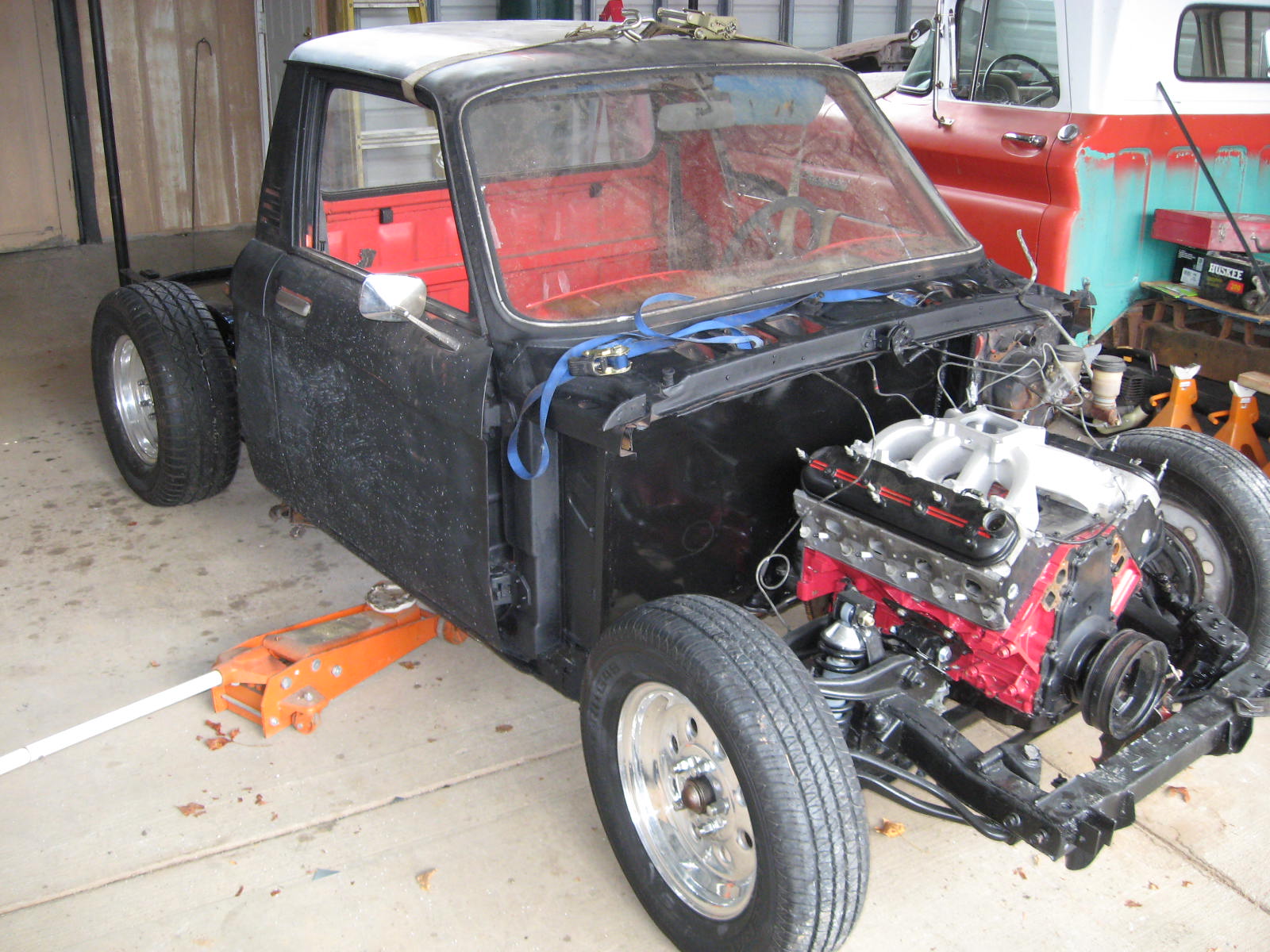

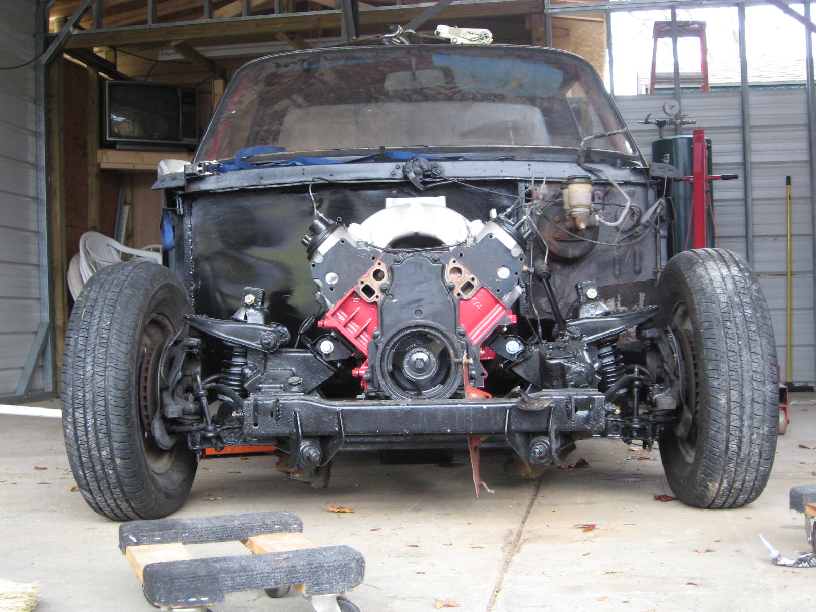

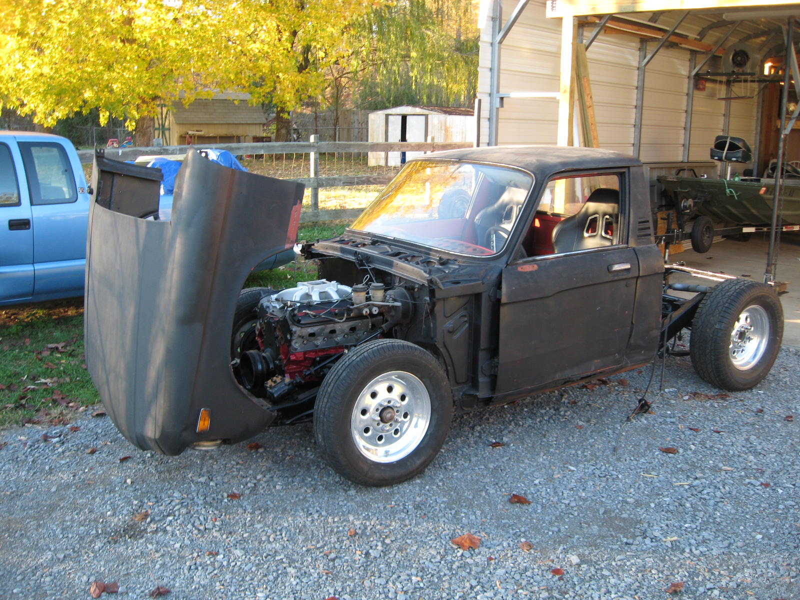

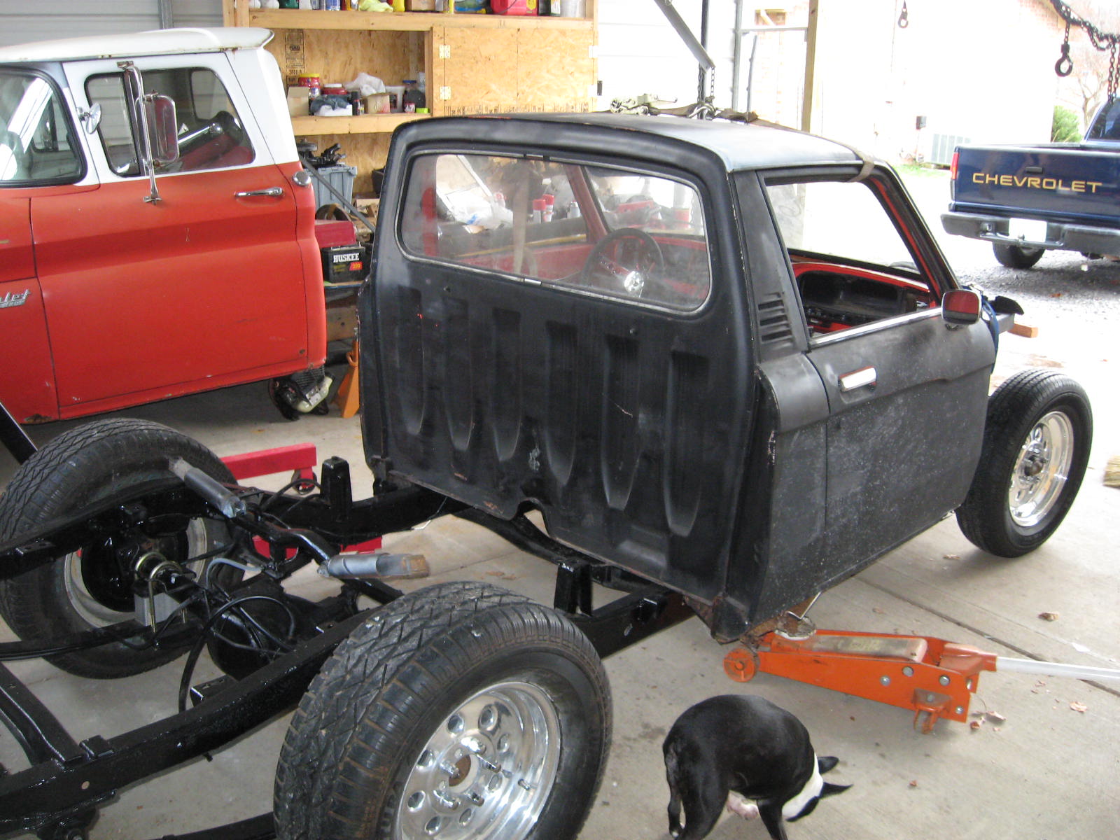

just sat cab on today

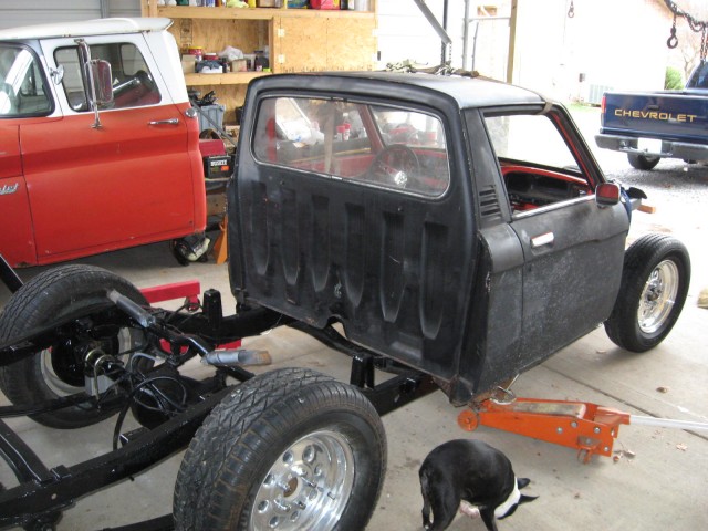

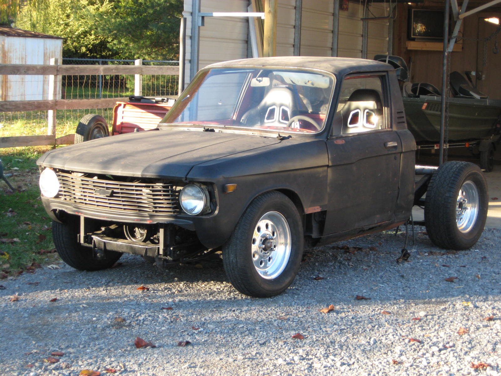

some more

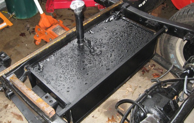

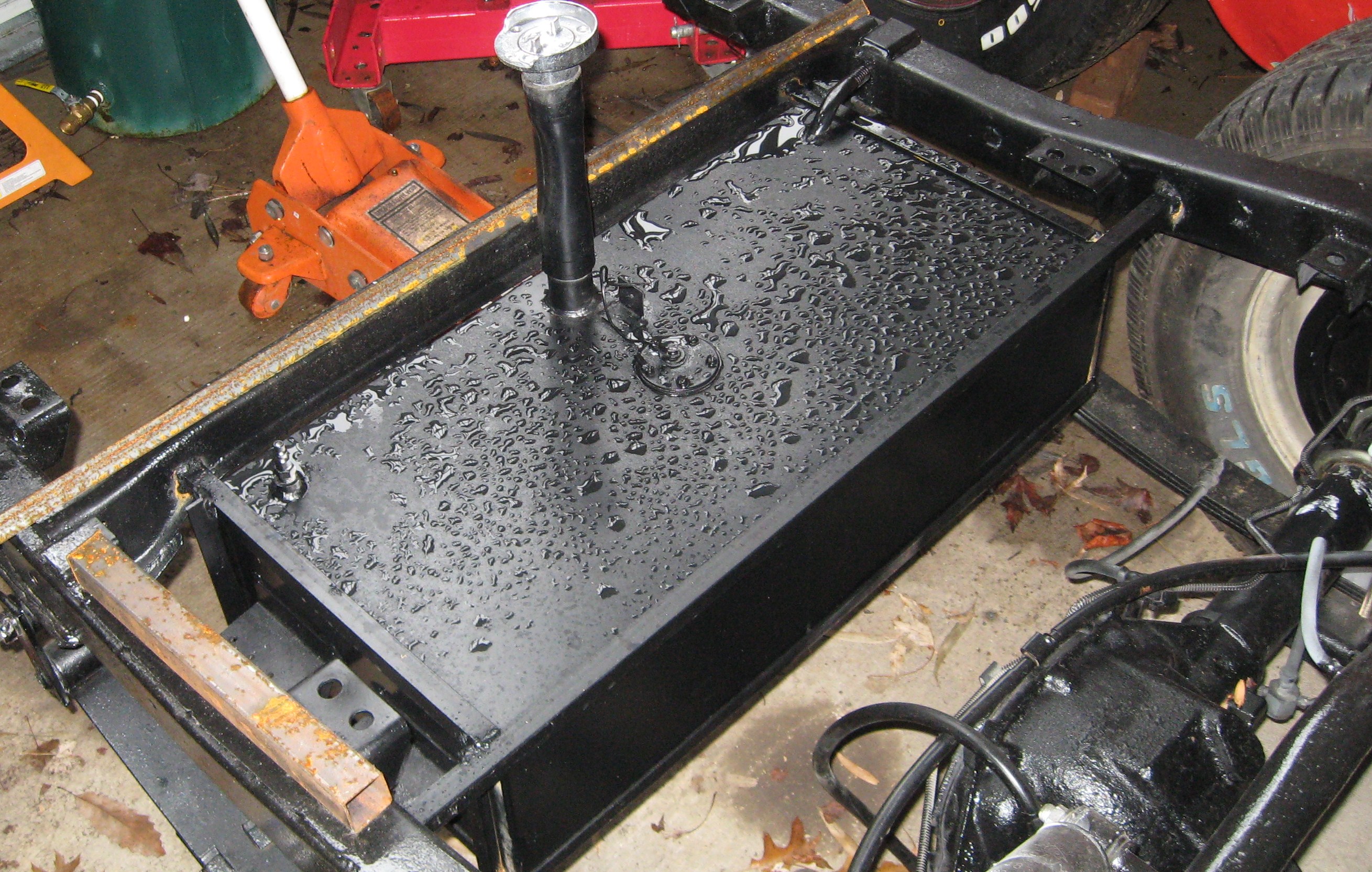

gastank mounted aluminum came out of a boat!

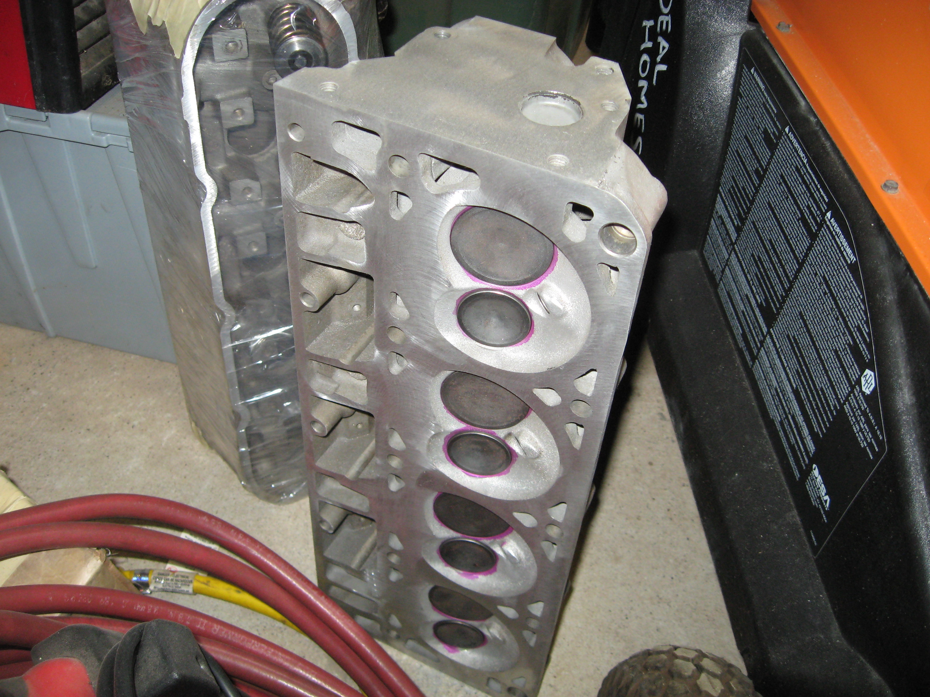

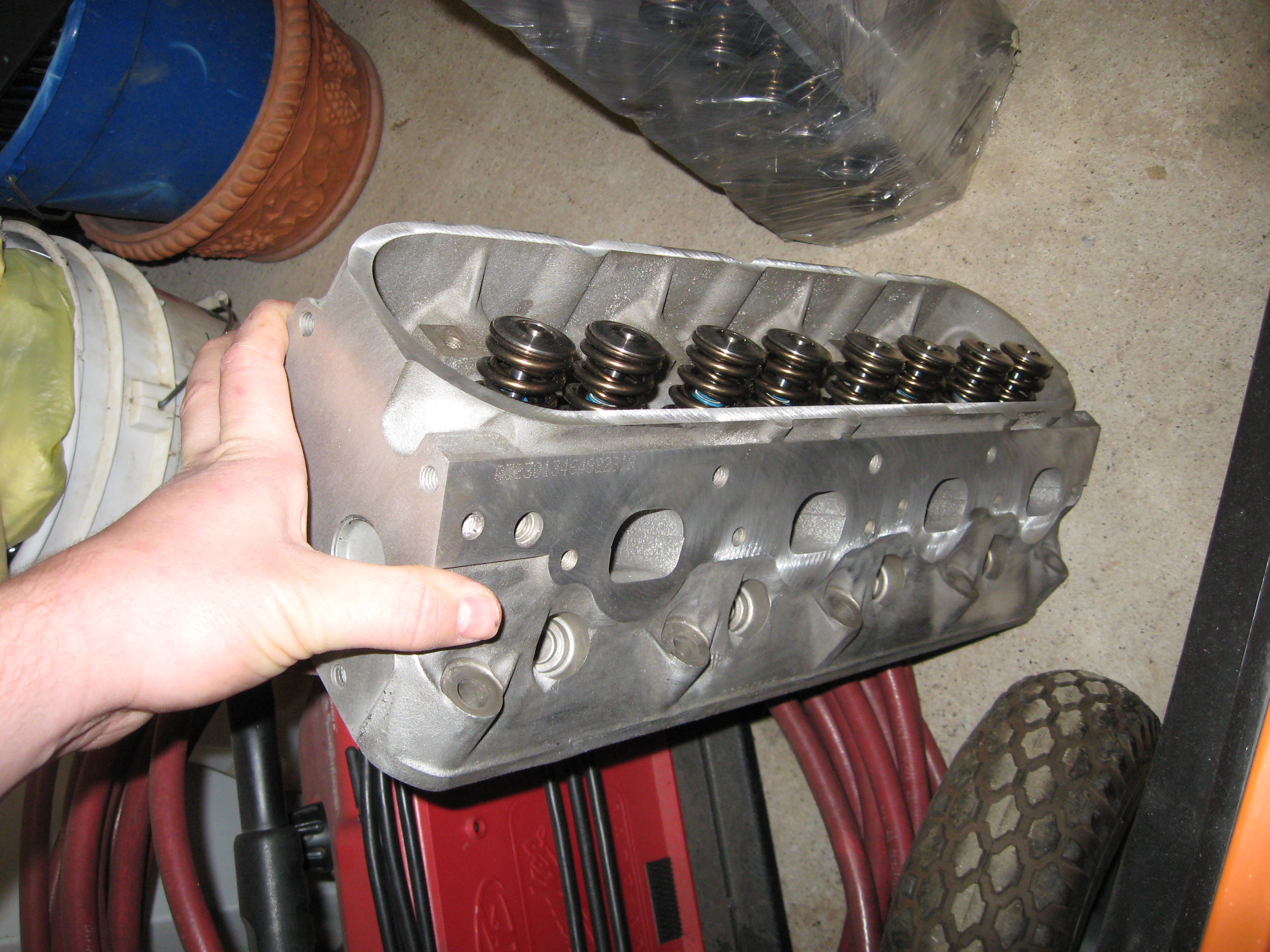

took heads off to get redone and patriot dual gold valve springs put in
