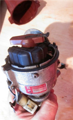

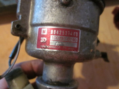

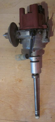

I bought this distributor represented as a 1983-1987 Isuzu PUP 1.9 engine electronic distributor. Is this the right one to convert my Luv to electronic ignition? If so how do I hook up the wires?
Thanks!

exactly what I have... your good to go

There are two types...an earlier one with the ignition module mounted externally on the outside of the coil, and a later one that has the module mounted inside the distributor.
The internally mounted one is the best - but both will work.
