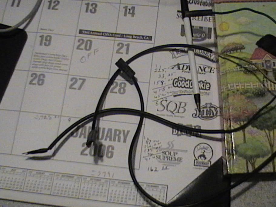

ARE THESE THE WIRES

PostPosted: Thu Jan 05, 2006 10:38 pm
See sig below....
Seriously chill... 800xl gave the best explanation that you're gonna get... I don't think anyone here can help any more than that.
:smt033 Image
PostPosted: Thu Jan 05, 2006 10:47 pm
Chavy, this is alittle more info for you above what 800 said.
Next to your coil(the thing that has a wire to the middle of the dist cap) there is a 4 wire plastic plug. 1 wire goes to the temp sender,1 to the oil sender and 1 to the dist. I do not know what the last one is for. No take all this info and go to the wiring schem in the info area of this site to get the color codes and hook them up. This is not rocket science, just follow the wiring schem.
EDIT:: I have done all your research for you. Like I said, there are 4 wires in that connecter by the coil
1. grn (green) goes to the A/C if equiped
2. blk/red (black wire with a red stripe) goes from the coil to the dist.
3. ylw (solid yellow) goes to the oil pressure sending unit
4. ylw/blk (yellow wire with a black stripe) goes to the coolant temp sensor
