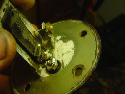

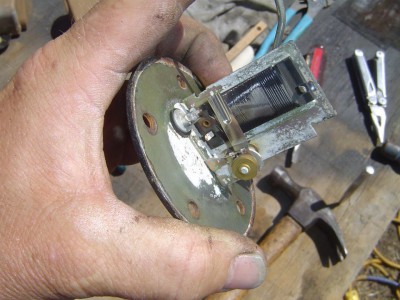

Once sending unit is out of the tank ....i took the cover off you see this.
This 1st pic is the range your traveling to get low to high ohms ...when testing
The 2nd picture show my fixed connection see that glob. of shiny solder.. :lol:
