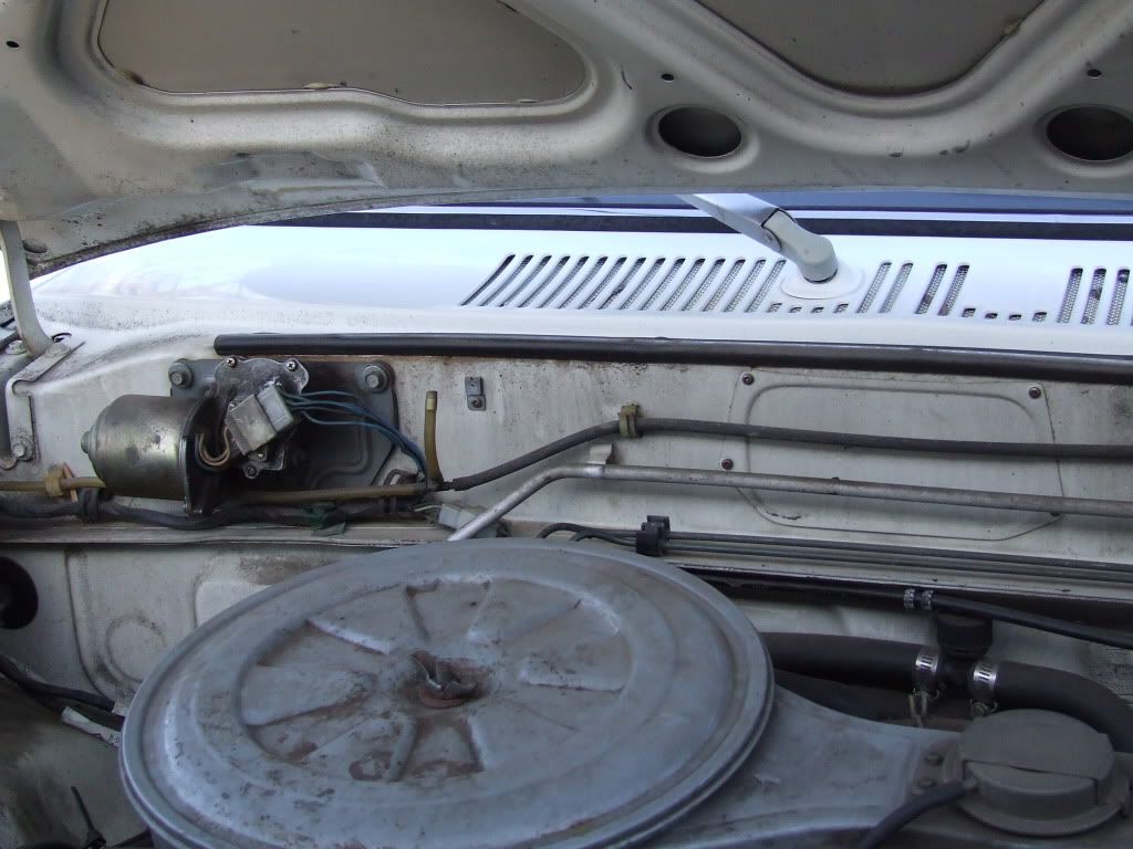

i have a broke peace in my washer system. it the piece that goes from the flex tub to the pert of the nossel that sticks into the engine compartment. where do i get this part?

I did the exact same thing. You might be able to find a part off of a different vehicle. I found one in a box of random stuff at a pick and pull, not sure what it came out of, but it works.

I dont know if this would work or not. Try a piece of tubing that will fit tight into the hose and put a piece of small wire in the other end and smash the tubing around the wire with a vise then pull the wire out and bend to fit. cost a quarter.

if you go to an auto parts store, in their HELP! section, you should find a few replacement universal assortment nozzles. if you want originality, stick with the pinched tube. otherwise you can update the spray nozzle and the spread of the washer fluid. i used some from my wife's metro in the hood. worked great, and it looked good.
