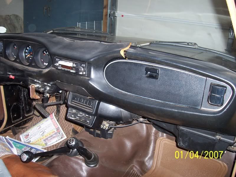

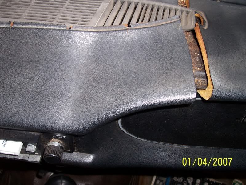

Did I mention that my dash is seperating? Here's some pics. :lol:
http://i47.photobucket.com/albums/f184/ ... 0_4069.jpg
http://i47.photobucket.com/albums/f184/ ... 0_4064.jpg
It's a little dirty. Haven't cleaned it in a while since it still has its use around the house. :wink:

That one is not half bad. I have seen much worse. A cap would cover that one up nicely.

Are you sure, rondog because it is pulled up. I was afraid that I would have to cut chunks out of the dash.

Okay LuvMyTruck, Rondog took the words right out of my mouth. That's exactly what I was thinking. A dash cap would take care of you. Where the edges are curled up go ahead and use a sharp utility knife and trim it off. Save the pieces in case you want to set some piece in the gap. You could fill the gap with anything, as long as it doesn't bulge or protrude. Make sure you try the cap a few times dry to check for fit. When you place it in with glue for the final time take three or four new and still-wrapped paper towel rolls and maybe a dozen toilet paper rolls and stuff them in with one hand while you and another person keep a steady forward pressure on the cap. Keep holding it by hand for a good ten minutes at least. I did mine during warmer weather and left it there overnight. It's solid and looks really great!! My dash was cracked worse than yours!! I didn't want to photograph it; it was embarrassing!! I do have some photos that show how bad it was though. Here's a before and after.

okay guys thanks for the help i think i might get a dash cap

I would say that I agree with Ron and FullaLuv, you may think your dash is trash but it is in good condition and a perfect one for the cap. Buy the cap and put the extra money from not buying a new dash elsewhere in the LUV.
