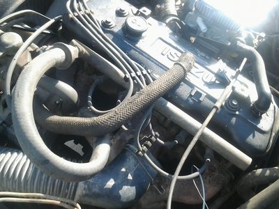

This tiny little gold screw goes in to a plastic piece attached to the automatic choke. I screwed it out, like an idiot, so then i screwed it in then out again then in again. I don't know where it is supposed to be. The choke plates close after the truck has been sitting for a minute it and open (sit vertically) after i start and run the truck. If those positions are correct, maybe i lucked out and placed this screw back in the correct location.

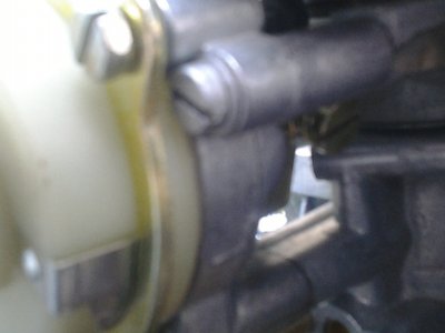

Figure 2: the air filter came with a white plastic L shaped tube that come out the bottom side of the air filter, am i supposed to connect it to anything or plug it off? Follow up question, there is a 6" black hose coming off the top of the oil pan, it used to be connected to the old air filter. Do i need to plug that or somehow connect it to the small white plastic L?

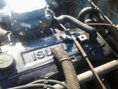

Figure 3: The mesh looking hose that comes off my emissions BS... same question, plug it or don't worry about it? I should probably just do a smog delete but i will save that project for another day. Baby steps. :D

I'm not sure exactly what screw you are referring to, if it has to do with the choke it will get fixed in the adjustment process. There is a ton of tuning instructions for these carbs available online for free if you don't have copies
Connect the black hose coming from the top of the valve cover to the plastic "L" in the bottom of the new air cleaner. This allows filtered make-up air into the crankcase to replace that being vented into the intake by the PCV port. It's better to use oil-resistant hose (like low pressure fuel line) but you may not can find anything the proper size. It would be fine to use two short sections of the existing hose at each end as a splice connector for a piece of metal pipe (possibly copper water pipe or conduit?) in the middle. You can find and use heater hose but it may get soft over time.
Make sure the vacuum end of the PCV is still connected, it comes off the top edge of the valve cover just in front of the carb & goes to a nipple at the carb base or maybe into the intake just below the carb base. Chances are you didn't disconnect it. Check everywhere for cracked vacuum hoses & plugs and ports that need to be plugged.
The fabric covered hose supplies air to the air pump for injection into the exhaust ports, normally it's hooked to the bottom of the stock air cleaner similar to the PCV hose. The Weber has no provisions to re-attach it. Is the pump functional? Will it remain functional? If so put some type filter on the end of the pump intake. If not toss the hose & the pump.
Both my engines have everything removed but the PCV (both ends) & vacuum to the distributor & brake booster & run just fine.

As far as plugged lines go, i only have two, one comes from the fuel tank and used to be hooked up right beside my main fuel line to the hitachi carb. The other small line i plugged i think had something to do with my EGR? Maybe? Hell i don't know. The first instructions said "remove and mark all hoses" i immediately removed all hoses and disregarded the rest of the directions.
As far as the black hose coming off the oil pan and going to the white "L" coming out of the air filter, i bought a piece of hose from Ace hardware and it wasn't quite long enough to attach it without having kinks that would block air flow. So like any lazy red blooded American, i attached the new hose to the "L." Attached the old hose to the oil pan. Butted the two ends together and had my vegan roommate hold them together while i electrical taped the s*** out of them. Probably a terrible idea, but so was splicing two computer speakers in to the cd player and they seem to be working fine, for now. (I'll post pictures later)
As far as the cloth covered hose coming from the smog unit that i needed to put a filter on... I found an old sock, stuck the hose in it, and put a hose clamp around it. Stuffed the hose up to the side by the fuse box so the sock wouldn't catch on fire and that's where it rode during my 30 mile journey to check my mpg.

the hose coming up from the oil pan is a vapor vent. i ran it to a weber vacuum port
the emissions junk can be removed fairly easily. the egr is the copper pipe from exhaust to under intake manifold. u would need to remove it and plug both ends
the smog pump and air injection rail over the exhaust mani can go. u can plug those four holes with spark plugs or a 14mm x1.25 thread plug
i removed everything from mine that wasnt necessary to make it run
