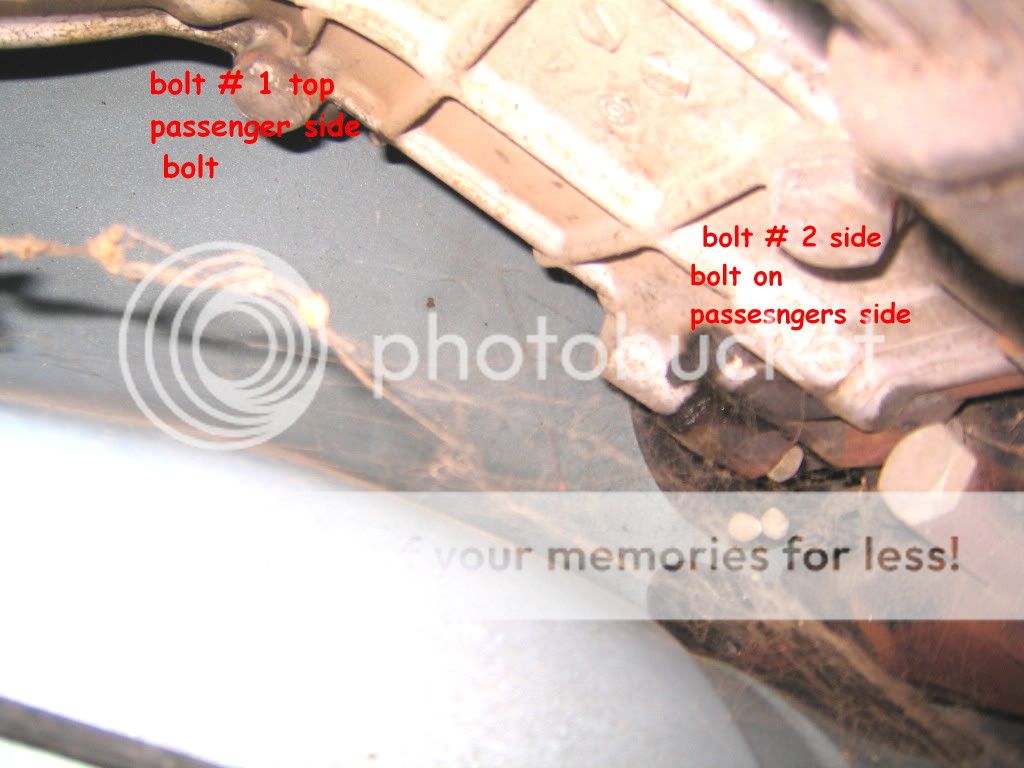

http://i363.photobucket.com/albums/oo71 ... nbolts.jpg
there were two bolts, i told him it was bolt #2 as in the picture, but for some reason he says it had to be bolt # 1. its bolt 2 right? do we remove that bolt and stick a finger to feel for fluid? and if it needs fluid, which bolt is it added in? thank you so very much. i never have done this.

PostPosted: Thu Aug 11, 2011 2:29 pm
Posts: 1702
The fill hole (and bolt) are on the SIDE of the transmission. It should be about halfway up. It is not in your photo at all.

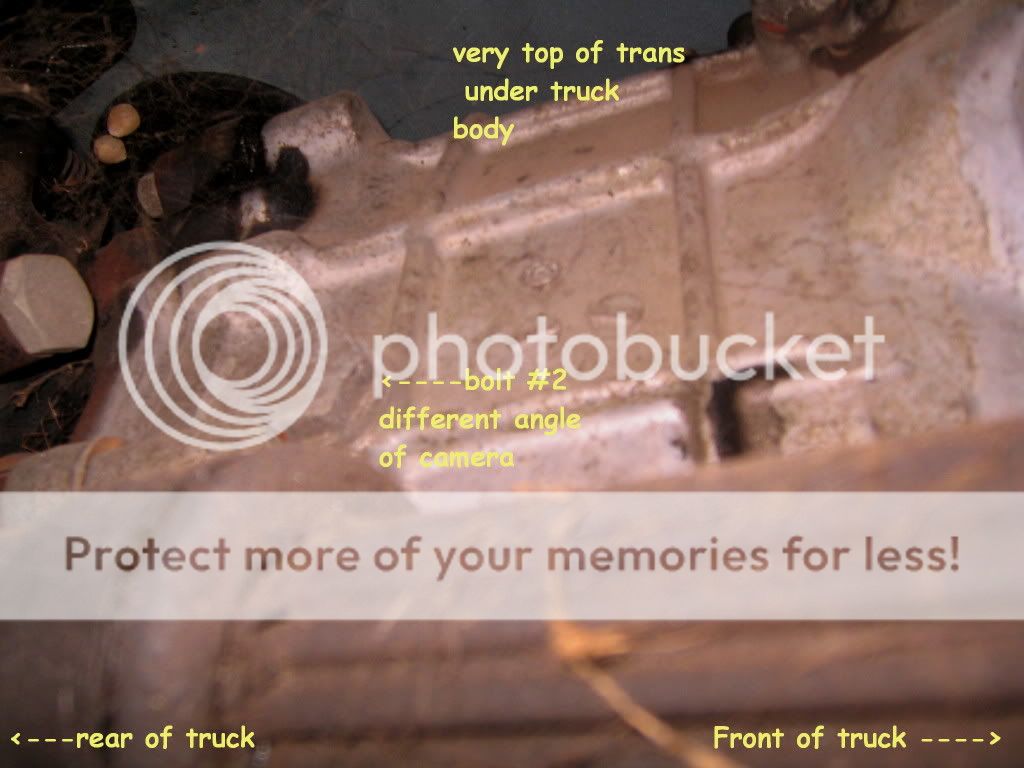

here is a better angle. its showing what i was referring to as bolt 2 it is on the passenger side. i tried to get a better picture its very creepy under there. i crawled under the passenger side, this bolt is located have way up the girth of the trans on the side.
http://i363.photobucket.com/albums/oo71 ... iption.jpg

PostPosted: Thu Aug 11, 2011 7:38 pm
Joined: Wed Aug 10, 2011 2:00 pm
Posts: 118
jkloos wrote:
ok this trip to the auto store getting sea foam there was a clerk who had a buddy who had a luv and always wanted one he showed me where. thank you for all your help. its not easy being blond3 :)

PostPosted: Thu Aug 11, 2011 9:10 pm
Posts: 1702
I can't tell from the photos. Mine is not a 4x4, so it looks sorta different. But it looks like you've found it, so that's good.
