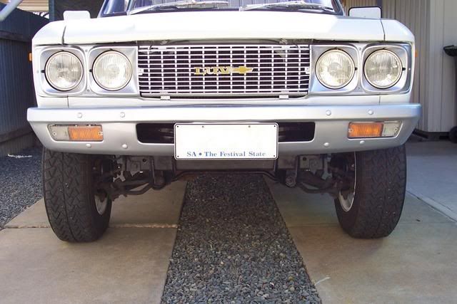

I have changed my singles in my 1980 to duels, i found there was no difference in the core support. Image Image

OzLuv - Man that is one clean truck! That photo of the front with one headlight swapped is awesome...
I had questions about the front fenders, but your pics pretty much cleared it all up.
