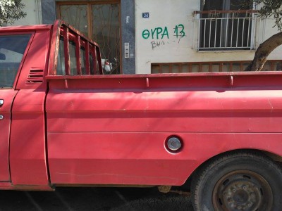

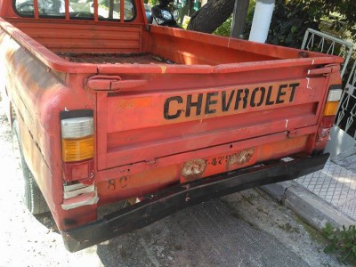

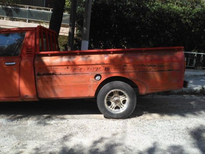

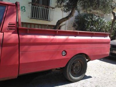

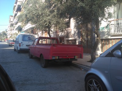

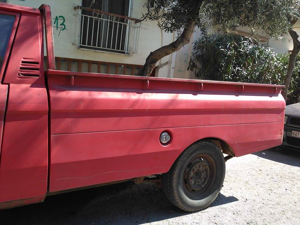

My bed is completely rusty.I found one from a kb20.Do you know if the frame mounts are the same in both of them?
 Post subject: Re: Bed removal
PostPosted: Sat Mar 25, 2017 3:07 pm
Posts: 1702
Are they both long beds? The long bed and short bed are not interchangeable.

yes they are both longbeds
