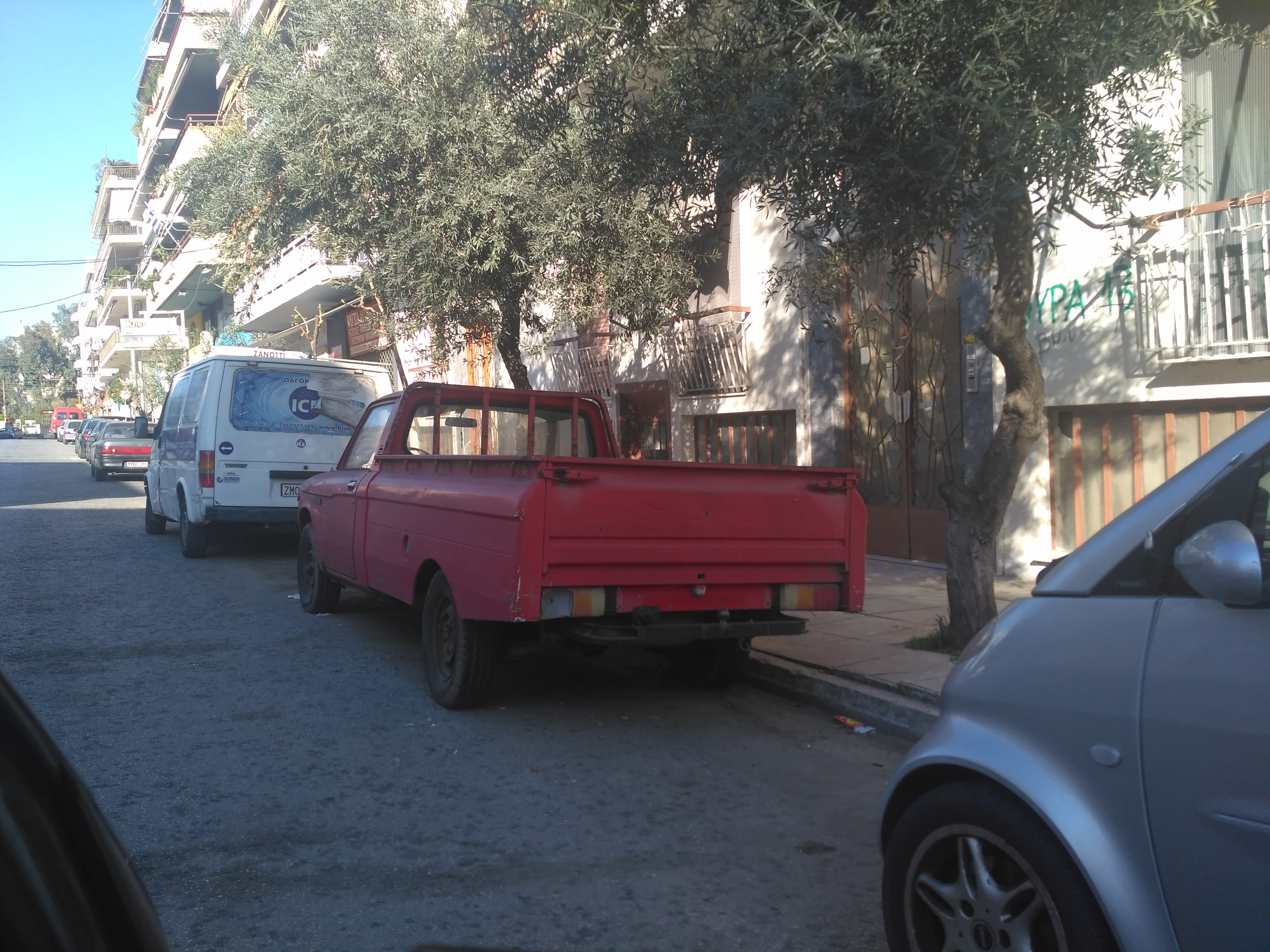

My bed is completely rusty.I found one from a kb20.Do you know if the frame mounts are the same in both of them?
Are they both long beds? The long bed and short bed are not interchangeable.

yes they are both longbeds
