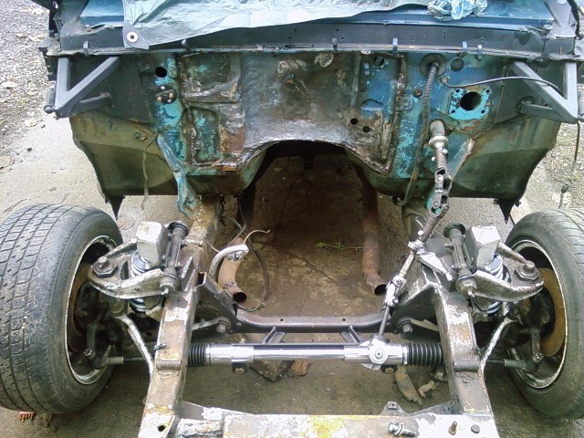

wow! time really flies by when working on the truck (sawzall time) I cut out the middle section of the firewall went to town on it recessing it for the distributor clearance mainly and the fact it looked ugly being beat with a 5lb sledge im sure was used. well I brought out the torch anvil and small little ball peen hammer and formed it.
took forever but will look nice. just need to finish tomorrow welding it in I ll try to have some pics of it up for you all!

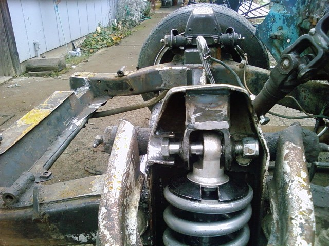

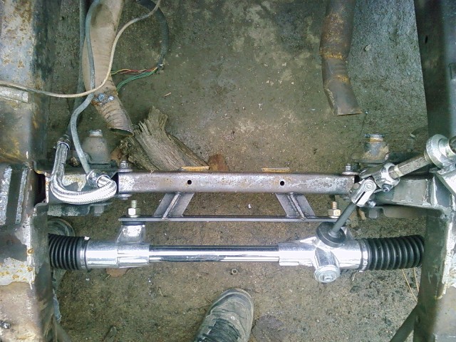

ok well I have put a tiny dent in the stuff to be done list.
rack & pinion
coil over suspension (torsions gone)
firewall recessed (ball and peen, anvil and torch)
it may not look purty right now I have not done the grinding and beautifications :econfused if thats a word I will do that all near the end of the work on front end
the firewall will require a little bondo and there is some welding left on it to make it look smooth and keep it structural.
next is the tilt front
I want to get it done cause I thought I would have had it done about two months ago oops!
anyways I have 90% of the parts I just need some 5/16" round stock for fender bracing
